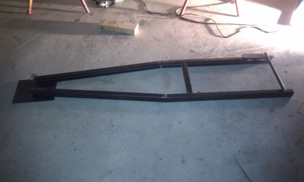

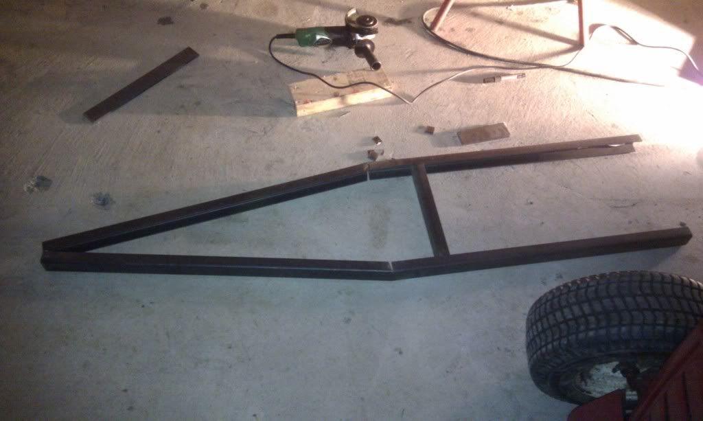

Lars 526 #5 Posted October 3, 2011 first update of the frame .. will create two frames at once .. one for me and one for my brother who helps me with them .. come with more updates later tip is received with thanks My Webpage My Webpage Share this post Link to post Share on other sites
