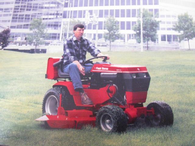

whfan74 2,073 #11 Posted March 22, 2012 Here are the only pictures I have of it right now. Sorry I will have to get some better ones if anyone is interested in seeing how it mounts............ Share this post Link to post Share on other sites
AMC RULES 37,223 #12 Posted March 22, 2012 I've seen that plastic type shown in brochures, also this earlier D type, metal tank as well. I'd like to see how one of these metal tanks mount up too, if anyone is running one. Share this post Link to post Share on other sites
bowtiebutler956 650 #13 Posted March 22, 2012 I got to get one of those! The little gas tank on my B-80 doesn't go very far, the K-301 is a pretty thirsty animal when it is being worked hard. Matt :flags-texas: Share this post Link to post Share on other sites
AMC RULES 37,223 #14 Posted March 22, 2012 The metal D tanks show up on ebay quite regularly, but I've never seen one listed with the mount though. Pict above shows a framework for this metal tank, not sure if it's different from the plastic one. Most probably the same mount works for both, I imagine. I've always liked the looks of this one better than the black one...more beefy. :thumbs: Share this post Link to post Share on other sites
stevebo-(Moderator) 8,557 #15 Posted March 23, 2012 That deck under the 520 in the above pic looks like a hybrid of a more modern 520 deck and the handle to adjust the height looks like one from the old C195 deck. Never seen one like that !! Share this post Link to post Share on other sites

Rideawaysenior 28 #19 Posted March 24, 2012 That pic was of a 520-HC. I wonder if there were special commercial features that came with the machine IE modified lift lever ETC. The tank on there sure does look a lot like the D series tanks though. Share this post Link to post Share on other sites
Sparky-(Admin) 23,524 #20 Posted March 24, 2012 The steel tank looks like a nice sturdy addition but all I can think of with the black plastic auxiliary tank is the 1972 Ford Pinto........get rear ended and KABOOM!! Mike............. Share this post Link to post Share on other sites
