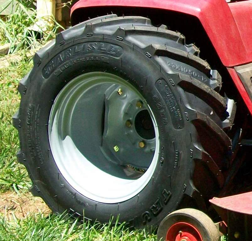

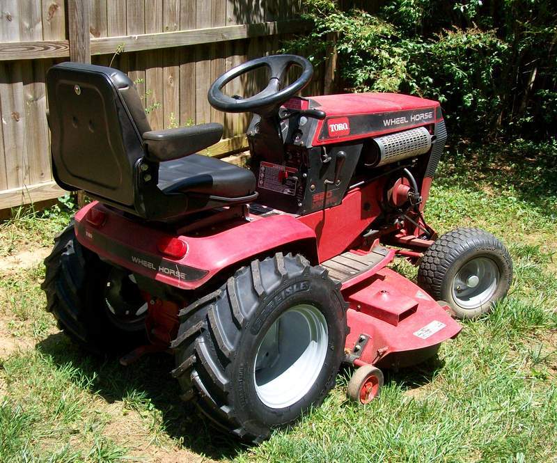

HamptonT 33 #29 Posted March 15, 2017 Anyone know what tires these are? The rims look wider than stock too. Share this post Link to post Share on other sites
953 nut 64,895 #30 Posted March 15, 2017 Those are ag tires, short for agricultural. Share this post Link to post Share on other sites
HamptonT 33 #31 Posted March 15, 2017 Thanks for the welcome. I was hoping to get make/model/size data on the tires. They look like they would be very affective in dirt. They also look much wider than I typically see on a WH. Share this post Link to post Share on other sites
WVHillbilly520H 10,378 #32 Posted March 15, 2017 Carlisle Tru-power super lug 23x10.50-12 ,most 520s from the back look out of proportion with the wider 8 hours ago, HamptonT said: Thanks for the welcome. I was hoping to get make/model/size data on the tires. They look like they would be very affective in dirt. They also look much wider than I typically see on a WH. factory wheels and flat wide tires the old Dicos were rounder and don't look as wide in the same size, Jeff. Share this post Link to post Share on other sites
k2wilson 41 #33 Posted March 16, 2017 (edited) On 3/14/2017 at 10:39 PM, HamptonT said: Thanks for the welcome. I was hoping to get make/model/size data on the tires. They look like they would be very affective in dirt. They also look much wider than I typically see on a WH. Those tires look a lot like the ones I have on my 520H. They are Carlisle 23x10.50-12 on stock width rims. Edited March 16, 2017 by k2wilson 2 Share this post Link to post Share on other sites
Ga. Grizz 6 #34 Posted March 20, 2017 Do those tire make a mess of the yard when just cutting grass? Share this post Link to post Share on other sites
TDF5G 2,073 #35 Posted March 21, 2017 19 hours ago, Ga. Grizz said: Do those tire make a mess of the yard when just cutting grass? I have used AG tires for mowing with my B-80 for 20 years. I put them on for better traction on the hills, especially when we have very wet or even very dry conditions. The AGs give me more traction, which means less spinning and yard damage. It takes a little getting used to and learning to not spin them. If they do spin, it doesn't leave as big a spin out patch as a turf tire does I've realized also. 2 Share this post Link to post Share on other sites
Ga. Grizz 6 #36 Posted March 21, 2017 Thanks for the info, always wondered if they would make a mess. May have to check into a set. 1 Share this post Link to post Share on other sites
