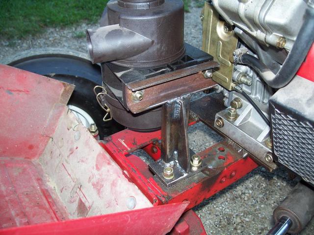

Kelly 1,035 #180 Posted July 23, 2013 Just a bit of a picture update, for the most part this is how it will be at the MI WH show, I have a temp fuel tank mounted, I may swap the hood for a nicer one, I have a few new gauges on order should be here this week, got the aircleaner mount done, just need to tighten the bolts so it sets level, seat is not what I want but it's in good shape and fits for now, starter is giving me fits, needs replaced but will be weeks to get one, so crossing my fingers it holds out for now, any way here it is ugly but drivable, I'm so glad I did the GT14 fender swap, it was a bit of work, but I'm VERY happy with it and the way the footrest turned out. 7 Share this post Link to post Share on other sites

dbartlett1958 99 #187 Posted July 26, 2013 That air cleaner mount should last a while. 1 Share this post Link to post Share on other sites
