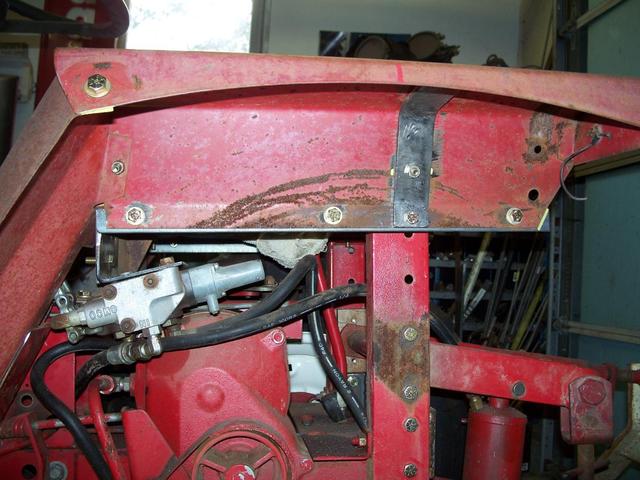

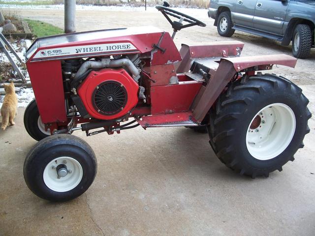

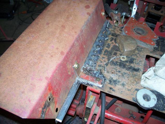

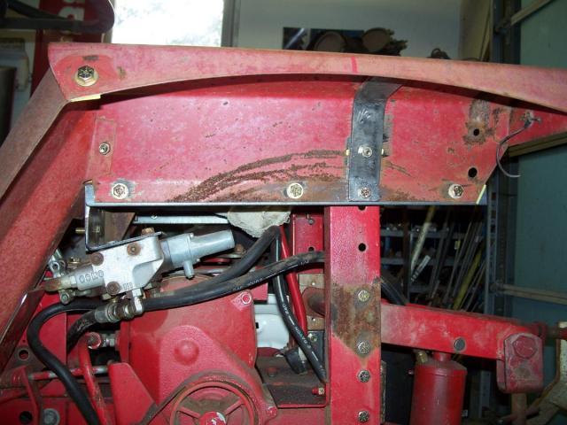

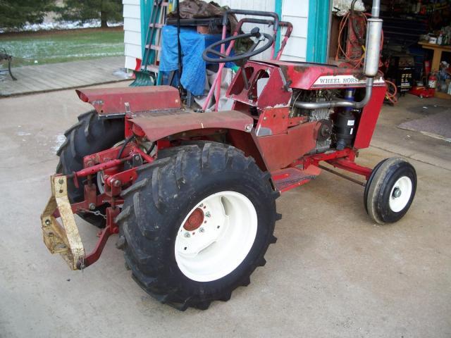

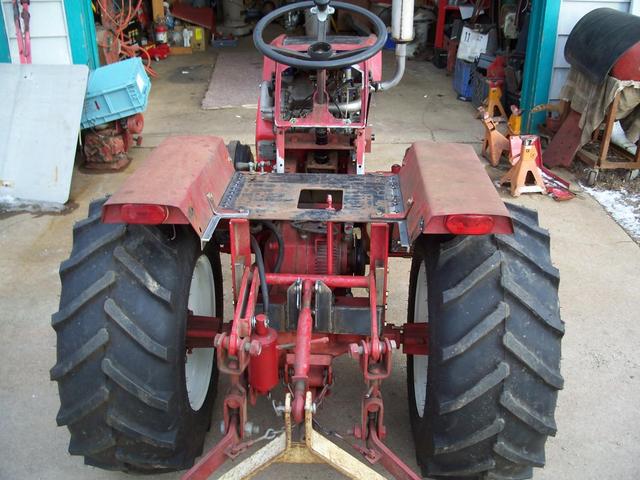

Kelly 1,038 #155 Posted January 19, 2013 Had to go watch my Daughter cheer tonight, but before we left I got the left fender all tack welded up, and the holes drilled to mount it. Inner rail mounted, and upper brace on. Inner brace installed after getting the fender all tacked up, I pushed it outside to clean up, so I took a few pics. I figure by the time I have the fenders and footrest all welded up, I'm going to have about 25 or so hours into them, but I think it was worth it, I hope sometime this weekend to get the fan guard all built. 6 1 Share this post Link to post Share on other sites

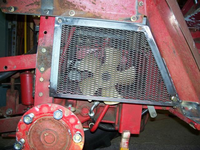

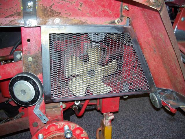

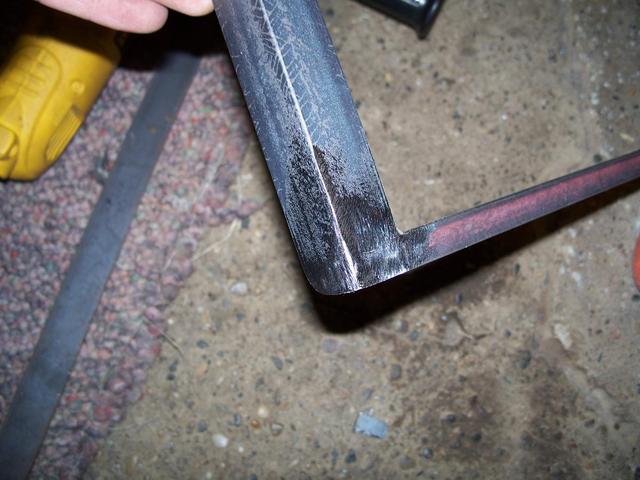

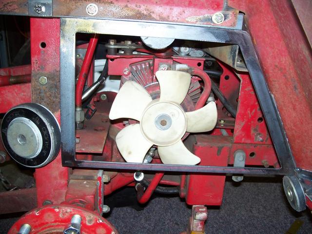

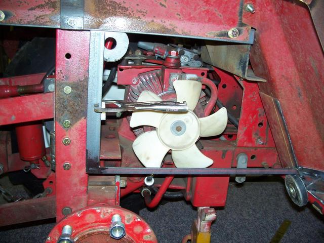

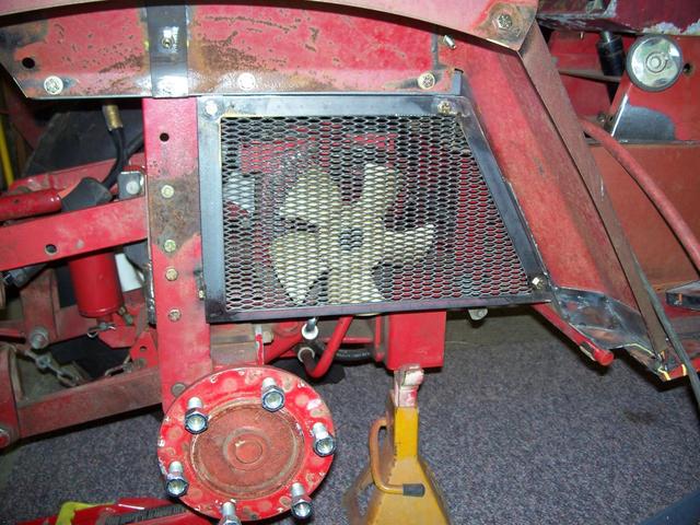

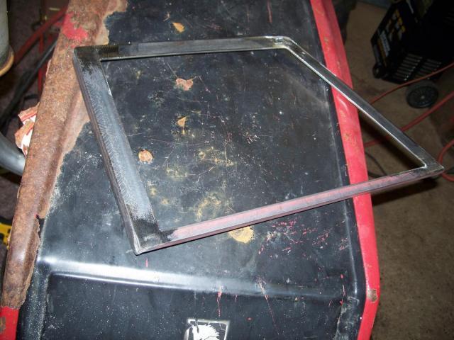

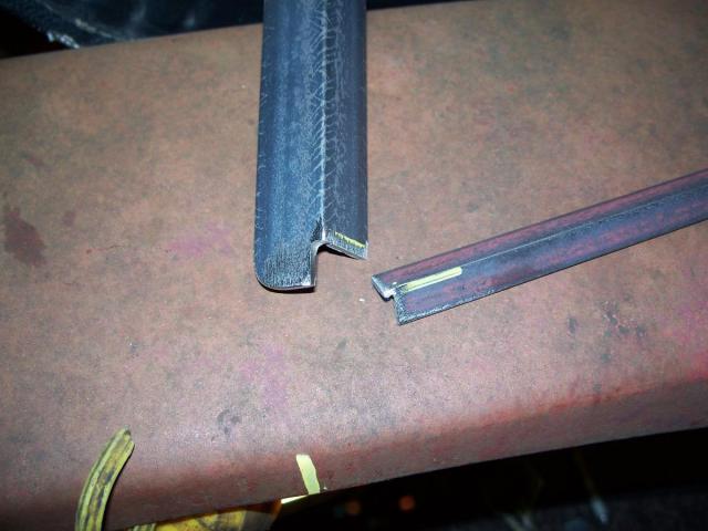

Kelly 1,038 #160 Posted January 20, 2013 Spent most of the day at the Detroit auto show, 2 hour drive there and 2 hours back 4 plus hours walking around, I was not really wanting to do much after getting home but I did tinker for a couple hours tonight, working on the fan guard, probably don't really need one, but what the heck I'm doing this much to it I figured it could not hurt. I used left over pieces of steel I had in the steel bin, and some screen I picked up fri. I planned to make it go farther down, by a 1" or so, but the piece of angle I wanted to use was a 1" shorter so I ran with what I had, I also need to leave room for the rear of the loader frame to mount on the axle, so now I have plenty of room for that, I used 1" angle for the back upright, 1/2" angle for the bottom and 1" flat stock for the front pieces, what a combo, but it fits very nice and the angle will stiffen the open edges. I trimmed the two pieces of angle so they fit like a puzzle piece and welded them up. Fit back on the tractor to get the angles to cut the other pieces. All welded and ground. I cut the screen but have not welded it yet, I still need to make tabs on the body to mount it and drill mounting holes, then weld the screen in, but here is about what it will look like when done, should have it finished tomorrow, I just ran out of ambition tonight, but happy with getting this done. 1 Share this post Link to post Share on other sites

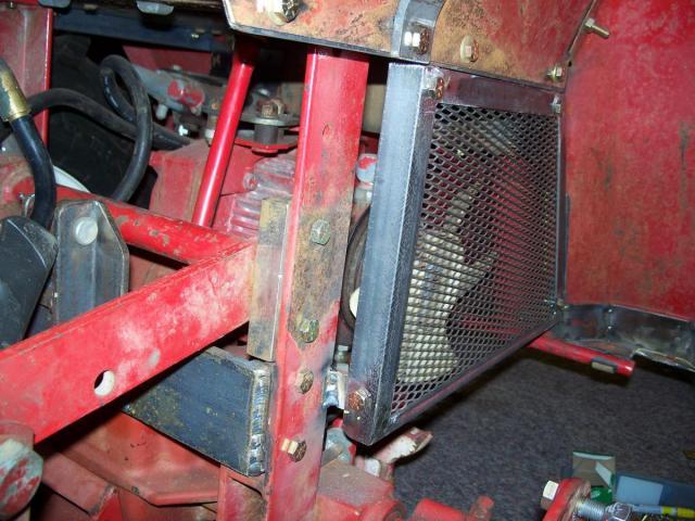

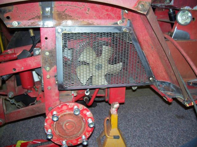

Kelly 1,038 #162 Posted January 20, 2013 Got the fan guard done today, not much else but some head scratching on other stuff I want to do, I still need to weld a couple of the tabs better when I tear it down, but everything is tacked in place, I welded nuts to the tabs so I don't have to try to get my arm up in there when installing it, or when removing it. All bolted in, I left about a 1/16" gap around it so it should not rub or squeak. View from back. Here you can see the fan sticks down below it some, but as I said earlier I used steel I had, and it was shorter that I wanted, but also needed to leave room for the loader frame mounts at the rear axle. Share this post Link to post Share on other sites

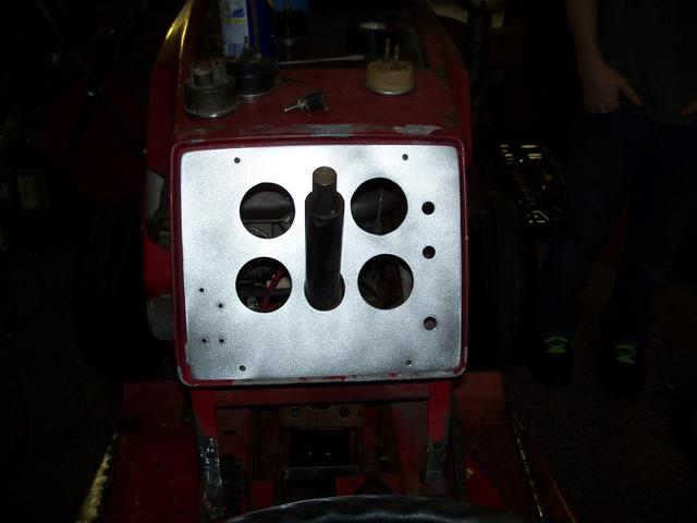

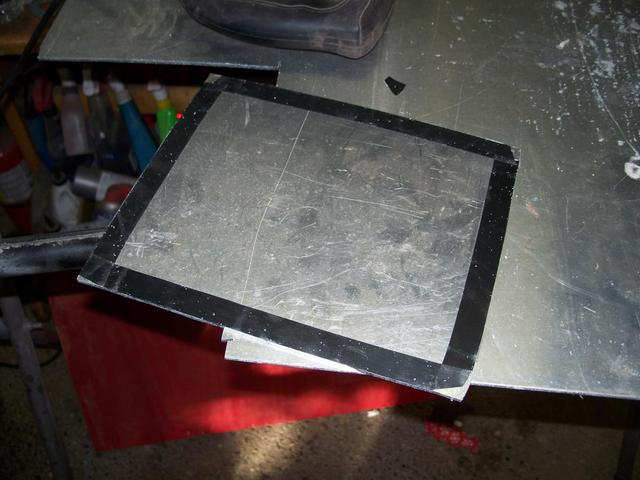

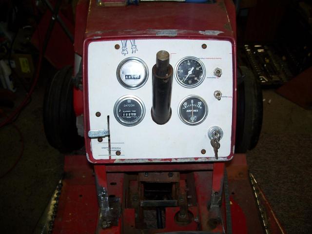

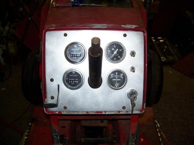

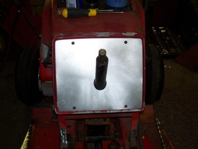

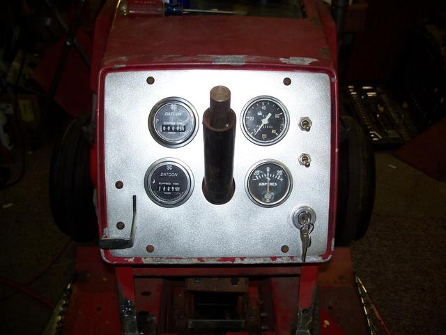

Kelly 1,038 #168 Posted January 27, 2013 Yesterday after work I mocked up a dash panel with some cardboard, just to see if I could come up with a lay out I liked and make all the gauges fit in the space I had, there are a few supports in the main part of the dash I had to work around. Here is what I came up with, room for all 4 gauges, two light switches, key switch, and the throttle. Today I built the real dash with some 1/8" thick aluminum I had here, cut out with a jig saw at this point. Here I have the steering column hole and mounting screw holes in, and all the sides trimmed and finished. Main holes drilled, I still at this point need to make the slot for the throttle, and file the flat sided hole to mount the key switch, but it is looking better. after 4 hours of cutting, drilling, filling and sanding here it is, everything fits nice, and yes I have two hour meters in there, I still need to order another gauge for the 4th hole, more on that later, but I'm pretty happy with the way it turned out, I will probably just paint it black for now, but I plan to send it to our decal guy here and have him make a dash overlay decal with all the lettering on it. 2 Share this post Link to post Share on other sites
