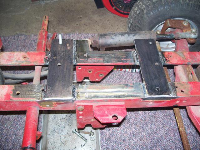

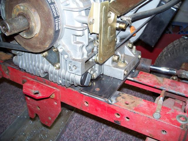

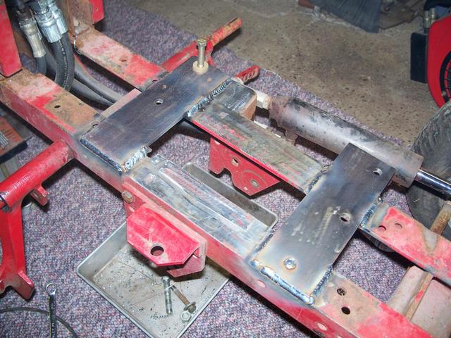

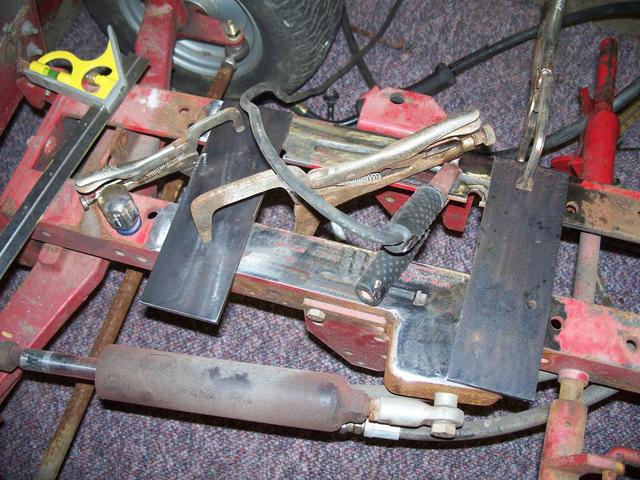

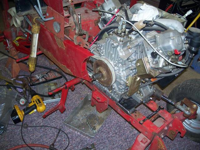

Kelly 1,037 #46 Posted December 18, 2012 Well it's been a long long time since I even uncovered the diesel project, I have been every now and then buying bits and pieces for it, well this last weekend I did a major clean in the garage, so I could get back working on the diesel, after getting it in the shop I just sat and stared at it trying to remember where I left off I found my bag of fittings to finish up the plumbing on the hyd. stuff so that is done, then I was looking at the engine and the location, and I decided I was not using the 520 motor plate, so off everything came and I went out back to the steel pile, to see what I had, I found some 1/4" thick plate 2 3/4" wide so I cut it to size and tacked it in place, much better I'm very happy with the way it sets and fits, I did end up drilling and taping one hole as it ended up right over the rear power steering mount, and it ended up being 1/2" thick, I'll loctite the stud in, for now I have a piece of all thread in it, then when bolting it in I figured out I need to buy more bolts for the bolt bin, I had 1 1/2" and 2 1/2" but no 2" so that is on the list, I found a NOS belt with lots of looking it is no longer available from Toro. Then I needed a bushing to replace a bad one on the shaft for the drive belt idler pulley, and I could not find one here, so I don't have a lathe (wish I did) I made do, I found a bushing that the OD was to big but the ID was right, after some head scratching, I put the bushing on a bolt and ran a nut up till it was tight, then chucked the end of the bolt in my drill and used a flat file as I ran the drill to make the OD the right size, probably not perfect but it worked I'm off work over the Christmas holiday so I HOPE to get lots done, and maybe even hear it run for the first time, after I build some exhaust for it even if temporary. And yes I will post pics. Motor plates ready to weld in Plates tacked in and engine mocked up Plates all welded up Welds ground and temp stud installed And where I left off tonight, didn't feel like 4 hours working on it, but finding where I put everything and getting back in the swing of things took a little time. 1 Share this post Link to post Share on other sites
Martin 2,133 #47 Posted December 18, 2012 looks good kelly. how does the crank/pto positioning compare with the oem engine? from the belt guard looks to be forward a little, i guess if thats the case a longer belt than oem would have been needed. standard hydro drive pulley? im just guessing on the forward part, comparing the belt guard with how a mostly standard one would look (relative to my c125-even though they are probably different parts) looks to be a couple inches. looking forward to seeing your fab work and progress on this one, its been a while!!!! Share this post Link to post Share on other sites
312Hydro 474 #48 Posted December 18, 2012 That's a very interesting conversion and that diesel reminds me of when they stuffed "mountain motors" in Chevy Vegas and Hemi Colts for Pro Stock.So will it's new designation be C-255D? Share this post Link to post Share on other sites
Kelly 1,037 #49 Posted December 18, 2012 Martin, the crank is about 1/8" lower than stock and as for front to back it is in the stock location, I used the lower PTO bracket as a guide, and I have another complete C-195 to check with, and I checked crank height on my 520, C-195, and a few single cyl. Kohlers guess what they are all different, off the top of my head the 520 was 6 3/4" the 195 was 6 1/2" the single Kohler was 6" again I didn't write these no.s down so that is from memory, and the C-195 tractor is about 6" longer than a standard tractor, so the drive belt is 195 only, the hydro pulley is the hard to find 1" bore from a briggs powered hydro tractor. Rich, I like BIG engines, and tires, I guess that is the car guy in me, not sure what I'm going to call it, me and my oldest son were talking about that yesterday, when we pushed it in the shop. 3 Share this post Link to post Share on other sites
