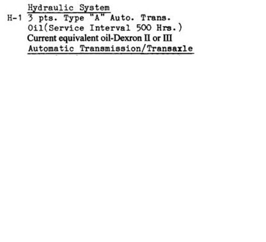

gumshoes 205 #14 Posted June 13, 2015 How much oil does the HY-2 kit hold when empty. Share this post Link to post Share on other sites
gwest_ca-(File Mod) 12,015 #15 Posted June 13, 2015 (edited) I wondered if the capacity could be found in the Lubrication chartshttp://www.wheelhorseforum.com/files/file/1085-chart-lubrication-recommendations-and-capacities-33-pages-492-0392pdf/and it is for the 1960-1965 modelsGarryAdding 1962-1963 model HY-2 and 1964-1965 HY-3 to aid future searches. Edited June 13, 2015 by gwest_ca Share this post Link to post Share on other sites
