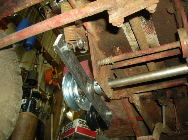

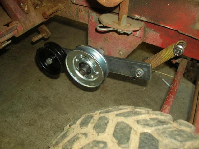

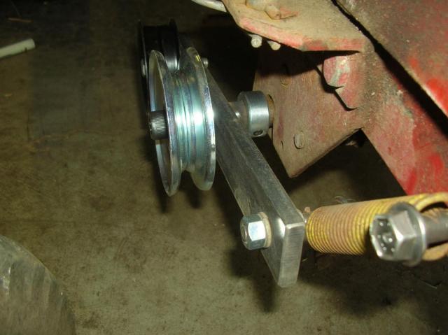

Lost Pup 172 #1 Posted November 21, 2010 I built a pulley setup for my new tiller. The two pulleys, spring and belt used are the Toro or equivalent. The shaft is 3/4 plain steel which I threaded the end. A few bushings and spacers to line it up the pulleys. The black 3/4 stop collar just lines up the belt as I just slide the shaft in from the drivers side. Tension seem to keep it there in use so I did not add not to the other side. The spring just slides over the stub as the setup is slid in. The eye bolt is left on the tractor and can be turned to adjust tension on the belt. I guessed on the spacing on the pulleys and it works well. Pics for those who build one. The tiller is setup on a 417-8 in the pics. Comments Welcome 6 Share this post Link to post Share on other sites

jusjeepn 59 #5 Posted November 22, 2010 Looks like a pretty good fab job there. One question, does the shaft kinda move around in your attach-a-matic? If you look closely at the locking arm on your attach-a-matic I believe you'll find it is slightly larger than 3/4", allowing your tensioner to "float" a little. You can look a your mowing deck and see the factor collar that W/H installed just for this purpose. The oversized collar help to position the implement in the attach-a-matic as well as keep it snug against the bracket! Nice work! :thumbs: 1 Share this post Link to post Share on other sites
Lost Pup 172 #6 Posted November 22, 2010 Looks like a pretty good fab job there. One question, does the shaft kinda move around in your attach-a-matic? If you look closely at the locking arm on your attach-a-matic I believe you'll find it is slightly larger than 3/4", allowing your tensioner to "float" a little. You can look a your mowing deck and see the factor collar that W/H installed just for this purpose. The oversized collar help to position the implement in the attach-a-matic as well as keep it snug against the bracket! Nice work! Yes, the entire shaft rotates against the belt tension spring. I tried the shaft inially without any collars at all and was amazed to find that under tension and in full tiller use the shaft pivots just fine and never wanders in position side to side at all. I guess the belt and pulleys keep it aligned with the PTO above. Share this post Link to post Share on other sites

jetmandan 29 #9 Posted April 12, 2015 Thanks for your pics and measurements, here's some pics of the bracket I fabbed using your ideas. Spring is just what I found in my shop, won't know if it's correct length or not until 141 x 1/2" belt arrives. I also did my own posting here, Dan 3 Share this post Link to post Share on other sites

Duramax7man7 506 #11 Posted February 3, 2017 (edited) So this is the actual part needed for the Tiller Setup? Thanks! Questions... 1. I don't have a threading machine. Could I drill a small hole about 1/8" deep in the side of 3/4" round bar an inch (or whatever measurement is needed) and use a lock collar to hold the pulley in place? 2. Also can these pulley's be purchased at TSC or maybe McMasters? 3. What size flat stock is that? 1/4" x 1/5" or 5/16 x 1.5"? 4. Finally, what is the appropriate belt length? TIA Edited February 3, 2017 by Mastiffman Share this post Link to post Share on other sites

Lost Pup 172 #14 Posted February 5, 2017 (edited) On 2/3/2017 at 2:47 PM, Mastiffman said: Questions... 1. I don't have a threading machine. Could I drill a small hole about 1/8" deep in the side of 3/4" round bar an inch (or whatever measurement is needed) and use a lock collar to hold the pulley in place? Sure. Quote 2. Also can these pulley's be purchased at TSC or maybe McMasters? I used the OEM Toro Tiller pulleys, belt and spring. Possible to crossmatch pulleys and such. Quote 3. What size flat stock is that? 1/4" x 1/5" or 5/16 x 1.5"? 1/4 bar stock. Quote 4. Finally, what is the appropriate belt length? I used stock Toro Tiller belt. Do not know the length. Edited February 5, 2017 by Lost Pup 1 Share this post Link to post Share on other sites
