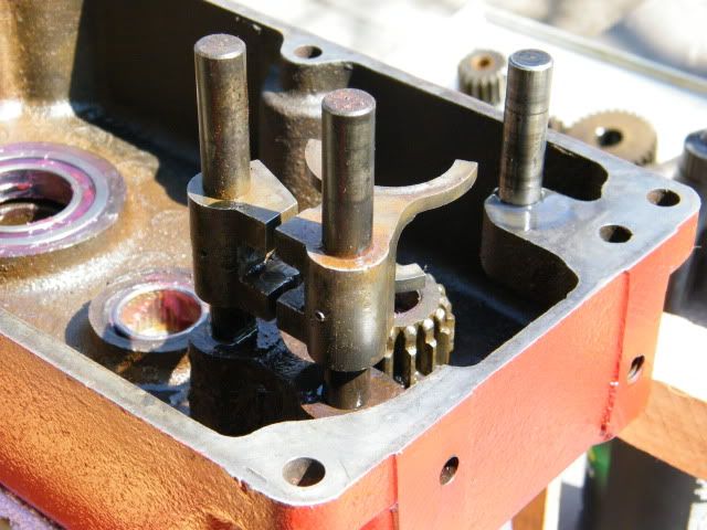

stevasaurus 23,662 #7 Posted September 29, 2010 Thanks Lane...it is an L-107...1967 with a 5053 It is section 2 of the manual that I have. Do you have a manual?? Cletus...it is important to have the trans in neutral before you start trying to move things around. not the best picture...but it shows the 2 forks in the neutral position. If you look down into the trans in the shifter hole, this is what you want to see. The fork on the passenger side or toward the back is the 1st and rev fork. The fork on the driver's side or toward the front is the 2nd and 3rd gears. Once in neutral then take the screw driver and try to move the fork on the driver's side either forward or backward. Use gentle pressure, if indeed it is stuck or rusted, then it is time to split the trans and clean it out...you may want to do that anyway. Let us know. :USA: Share this post Link to post Share on other sites

sorekiwi 761 #11 Posted September 30, 2010 Hey Steve! - remember that in England that the passengers side is the drivers side and the drivers side is the passengers side Cletus, when you look down the hole you will see the 2 selector rails. Each has a square notch cut out of it. When the notches are lined up, the transmission is in neutral, and the little ball on the end of the gear stick can move to either rail. There's a good picture of them in Steves post, but they'll look a little different when you are peering through a 1" hole, and they are covered in a nasty oil/water mix... These rails slide side to side. The one closest to the front of the tractor is 1st and Reverse, the rear most one is 2nd/3rd. Put a big screwdriver or prybar in the notch and gently try to slide the rails left and right to select the respective gears. I'm suspecting the rail is rusted up and wont want to move, and that you will end up having to pull the tranny apart to fix it. One thing you could try is filling the trans with some sort of thin lubricant for a week or so. I have used a 50/50 mix of ATF and Kerosene. Fill it right up so the shifter rails are covered. Every day give the shift rails a nudge with your prybar to try and work the lube around. This might get it moving. You will probably also find that with the gearbox so full, and this thin mix, it will leak out the seals and make a mess on your floor. :USA: Share this post Link to post Share on other sites
