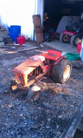

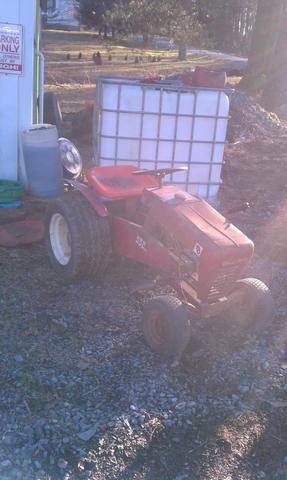

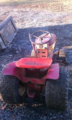

here are some pics of it as it is now before i tear it apart and do some custom work to it i will post pics as i go but im still desiding what engine to run in it maybe a 10 hp kohler maybe a 16 hp kohler maybe a honda clone maybe a twin 20 hp kohler k series

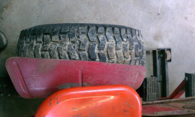

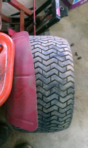

well i picked up a set of wheels and tires for the project might be a little to wide they are 24x13-12 and the older ones are 23x10.5-12 the new tires are not even bolted on yet i need an aditional 3 inches for the wheel to be able to be bolted to the hub to customize or to not use them its a hard desition
post-1653-0-90084500-1342147344_thumb.jp
post-1653-0-13430900-1342147457_thumb.jp
Kelly
The one on the right is a 23x10.5 on the left is a 24x14x12, on a 8.5 rim off a 520 to give you a idea, they bolt on with no mods with those rims.
jdog_kustoms
ok so i take it the 520 rim has a lot smaller offset on the inside of the rim and i never new the 14 inch wide tires will fit on a 8.5 rim i have a set thats what was on it so ill have to smap the tires thanks kelly
Kelly
The 520 rims only have about 1.5" back spacing, if you look the rim on the right is a cub rim with more back spacing I think about 2.5" and I think it is a 8,5" rim also, and these tires are made for a zero turn with 8.5 rims they have a round sidewall maybe for a better ride, they would fit a wider rim I'm sure but I took them off a 8.5" rims with a 4 bolt pattern.

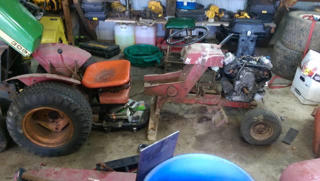

well after 6 long years this tractor will be at the show not owned by me but built by me here is that it looks like as of today
