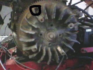

Torino 15 #11 Posted August 24, 2010 OK, finnaly got back around to this problem. Took of the motor shroud and can not find the timing marks. I have looked and looked, sanded and still can not see them. I was thinking...there is a hole in the ?blower? and was wondering it someone had one of these engines apart they could tell me the distance from the hole to the timing marks and I will just make my own mark. http://i169.photobucket.com/albums/u218/to...-24-10_1758.jpg Share this post Link to post Share on other sites

Torino 15 #14 Posted August 25, 2010 I was talking about the hole in the picture. The problem is I can't find the S on the fly wheel. Share this post Link to post Share on other sites
Trouty56 567 #15 Posted August 25, 2010 The letters 'S' and 'T' are behind the starter teeth and are tough to see. I have a K341 apart and just looked. Easier to take the shroud off. Look for an obscure line on this area of the flywheel and spray some carb cleaner on it. If it is the 'T' then look a couple inches clockwise on the flywheel for another line. On the carb side of the engine there is a horizontal line cast into it. I figure this is to line the 'S' up with once you find it instead looking through the hole. Maybe someone will correct this statement. Since I found the letters I'm going to paint them so I can see them in the future. Even cleaned they are hard to see!!! Those holes you are talking about are drilled to balance the flywheel and have nothing to do with the timing marks. Share this post Link to post Share on other sites
Torino 15 #16 Posted August 25, 2010 "Those holes you are talking about are drilled to balance the flywheel and have nothing to do with the timing marks." I know, but I thought if they where in the same place on all of the engines I could use it as a reference point. Share this post Link to post Share on other sites
linen beige 16 #17 Posted August 29, 2010 I thought if they where in the same place on all of the engines I could use it as a reference point. They are NOT in the same place on every flywheel. Share this post Link to post Share on other sites
