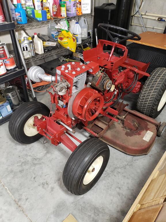

chdinct 28 #1 Posted May 25, 2010 Started the tear down about a month or so ago and was promptly delayed by getting the wheels off. The rears were painted onto the hubs. Kept hitting it with PB Blaster and a rubber mallet, then finally a little help from my friend "sledge" did the trick. Still need to remove the engine tins for sanding and painting, but that will wait until I have a rolling chassis back together with new paint. Since the engine and hydro all worked well prior to tear down, this will be basically a clean, sand and re-paint operation, which is good since this is my first restoration. Here are some pic's of the progress so far. Tractor at time of purchase (bought this one from Fireman) Wheels off Half way stripped: Steering tower - can't get the dam* steering wheel off so I'll just paint around it most likely Make shift engine hoist: Bringing the frame outside for cleaning (I ended up taking the front axle off and separating the hydro unit - wanted to minimize tear down but I kept thinking, if I just remove ........) Degreased parts (except engine) sitting back in the garage and ready for sanding: I had the wheels, hood and seat pan sand blasted but forgot to take pics of them. Will try to get for the next update. I have a whole big box of parts down in my basement that still need cleaning - hope to get to those later this week. Also decided to by an air sander and mini needle scaler to help with the sanding, but those haven't arrived yet. Add in an angle grinder with wire wheel and I should have enough firepower to do the rough sanding, he says now never having done a resto before I hesitated to post this thread since I'm worried I'll get sidetracked on some other project and take 5 years to finish this, but then, maybe posting a thread will give me more incentive to finish it by this fall (my rough goal). 1 Share this post Link to post Share on other sites

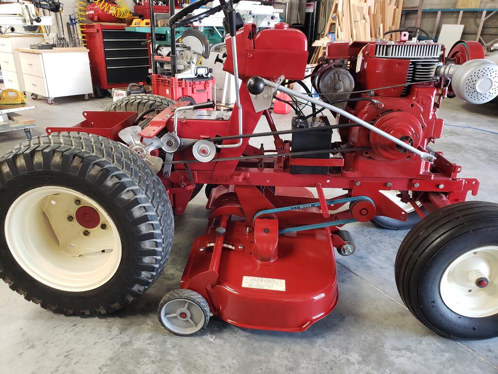

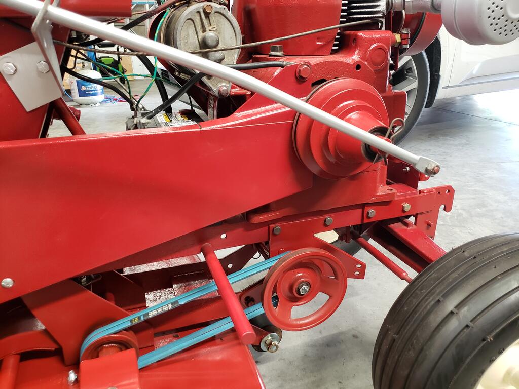

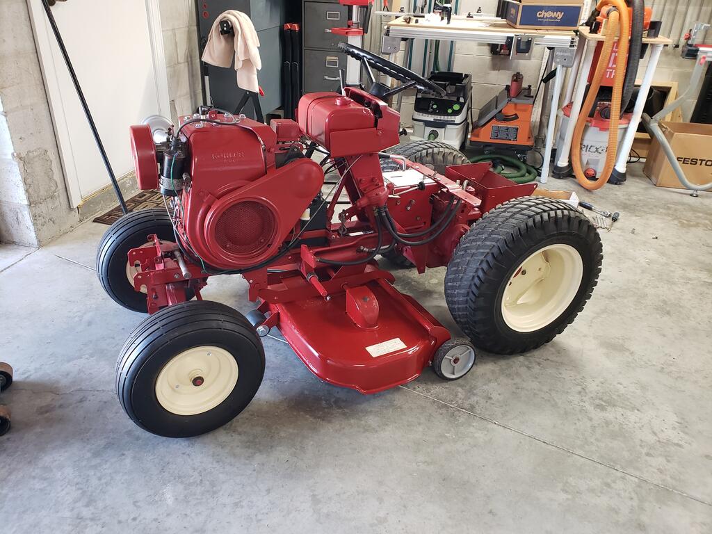

chdinct 28 #18 Posted April 17, 2022 The phoenix rises! Note the dates on my last posting - 2010. Let's just say life got in the way, me and my wife retired then moved to Florida and this project went on hold. She's been in pieces since sometime in 2010. I knew some day I'd have to get back on this project but sorta lost interest. You know how starting back on something from years ago can be tough but I picked it up again last winter (firs pic). I left most of the parts back in CT at my parents summer house. Started taking batches with me to Florida in the winter to prep and paint. We inherited the CT house last fall, so she'll be going back as soon as I get my truck back to Florida. Just have the big tins to redo - hood, seat pan and foot boards - and the decals to apply. She does start, run and move to my surprise. Now, that all said, here are my issues at this point. 1. Have a slight gas leak from the tan pet cock. I'll have to drain the tank and remove the valve to see if I can fix it. 2. Getting some weepage from the tranny tow valve. I screwed up when testing it out and engaged the hydro drive with the valve loosened. I don't think it leaked before that since I tried getting it to move before without noticing a leak. I did pull the valve out to look at the O-ring, but didn't see any damage. 3. The drive belt, which is original to when I bought it in 2010, is shedding whenever engaged. Looked like it was rubbing a bit on the inside of the belt cover. There's a flange on the inside of the belt guard to help track the lower half of the belt. It was rubbing on both ends of the flange so I cut the flange back about 3" on each end and smoothed it out with a grinding wheel but it's still shedding. Could be it's just old and half rotten. Hate to buy a new belt to see it get ruined right off. By the way, can't find the dimensions of the drive belt. Every parts list on line says NLA. If anyone knows the length, etc., I'd appreciate it, otherwise I'll just take it off and bring it to the parts store. 4. I picked up the deck you see separately sometime after I bought the tractor. It's a 36" rear discharge deck - model 5-2136 I think. I need to change the mule pulley to the larger one in the pic I believe, then find the right PTO belt. Again, I can't find any info on that belt either so if anyone knows, again, I'd appreciate it. 5 Both the throttle and choke linkage are balky. I did lube them with WD-40, PB Blaster, etc. and they do work but not smoothly. Not sure what I'll do about them. Anyway, that's it for now. Oh, and Happy Easter. 1 3 Share this post Link to post Share on other sites
chdinct 28 #19 Posted April 17, 2022 OK, can't upload the pic of the bigger pulley do to size limits. Sorry. 1 Share this post Link to post Share on other sites
giddyap 1,574 #20 Posted April 17, 2022 49 minutes ago, chdinct said: Note the dates on my last posting - 2010. I have set aside some of my projects for months at a time but never years! BTW it would take me a decade to create a showroom finish as yours, you made a very nice lookin tractor. I think I have your model as a model in front of a picture of my tractors 1 Share this post Link to post Share on other sites
kpinnc 17,149 #21 Posted April 18, 2022 Great looking tractor! I've taken breaks on machines that lasted years as well. You're right, sometimes life gets in the way. Glad you were able to come back to it! The good news is that these old tractors were built to endure such things. A little love, and she will be back to work for another few decades! 1 Share this post Link to post Share on other sites

chdinct 28 #23 Posted April 18, 2022 13 hours ago, kpinnc said: Great looking tractor! I've taken breaks on machines that lasted years as well. You're right, sometimes life gets in the way. Glad you were able to come back to it! The good news is that these old tractors were built to endure such things. A little love, and she will be back to work for another few decades! Giddyap, don't let those pic's fool you. It's just a rattle can paint job. Will probably do some touch up after it's back together. Started out using Farmall Red but couldn't find that color during Covid so I had to change to Rustoleum Regal Red. Close enough I guess. Kpinnc, Horse Newbie, thanks for the encouragement. Probably won't finish the until next year since I'll be heading back to CT in a few weeks while the tractor stays in Florida for now. 1 Share this post Link to post Share on other sites

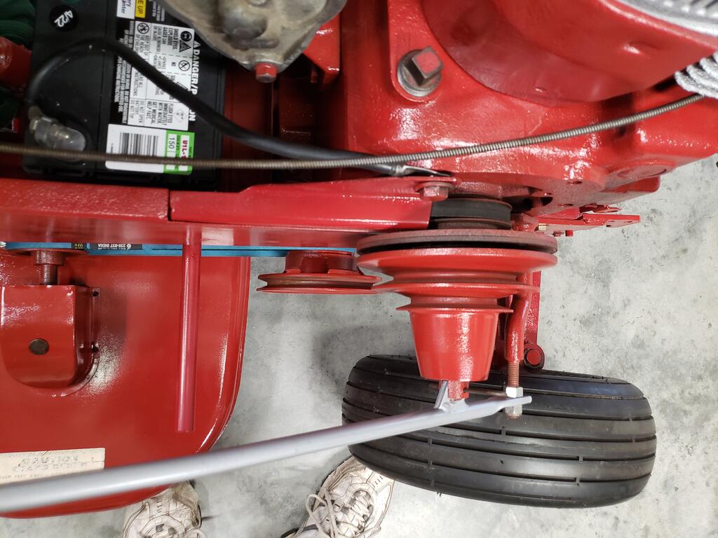

chdinct 28 #24 Posted April 18, 2022 Put the larger pulley on the deck and now it lines up nice with the PTO. But, not sure this is how the 36" rear discharge deck works with my 1077. Thinking there should be some way to adjust the tension on the PTO to deck pulley like you do with the front mule drive on the later tractors. Again, any help is appreciated. 1 Share this post Link to post Share on other sites

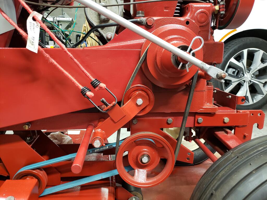

chdinct 28 #25 Posted May 4, 2022 Update: New tranny belt, new PTO to deck belt and idler pulley installed. Fixed the gas tank petcock leak. I jury rigged the PTO to deck idler bracket from other parts so it's not to OEM spec - can't find the correct idler bracket so far, but this looks like it will work. Just need to add a spring and figure out where to secure the tractor side of the spring. Using a bungee cord for now. Having said all that, what I noticed testing the new belts is that with the "break" on (puts slack in the tranny belt), the hydro pump still turns. This did not happen with the old belt. Compared them and the new belt is slightly shorter than the old belt. Wondering if the old belt stretched that much and the new one will do the same with time?? Don't think the hydro pump should be turning when disengaged, no?? Similarly, the PTO turns when I turn over the engine even when not engaged (with or without the PTO to deck belt on). So, the deck will turn whenever the engine runs - that ain't right. Took the PTO pulley off and greased it but it still turns with the engine though I can hold it with my hand and it stops turning. Am I missing something? Is this the original PTO pulley for this model?? Thanks for any help. 1 Share this post Link to post Share on other sites
