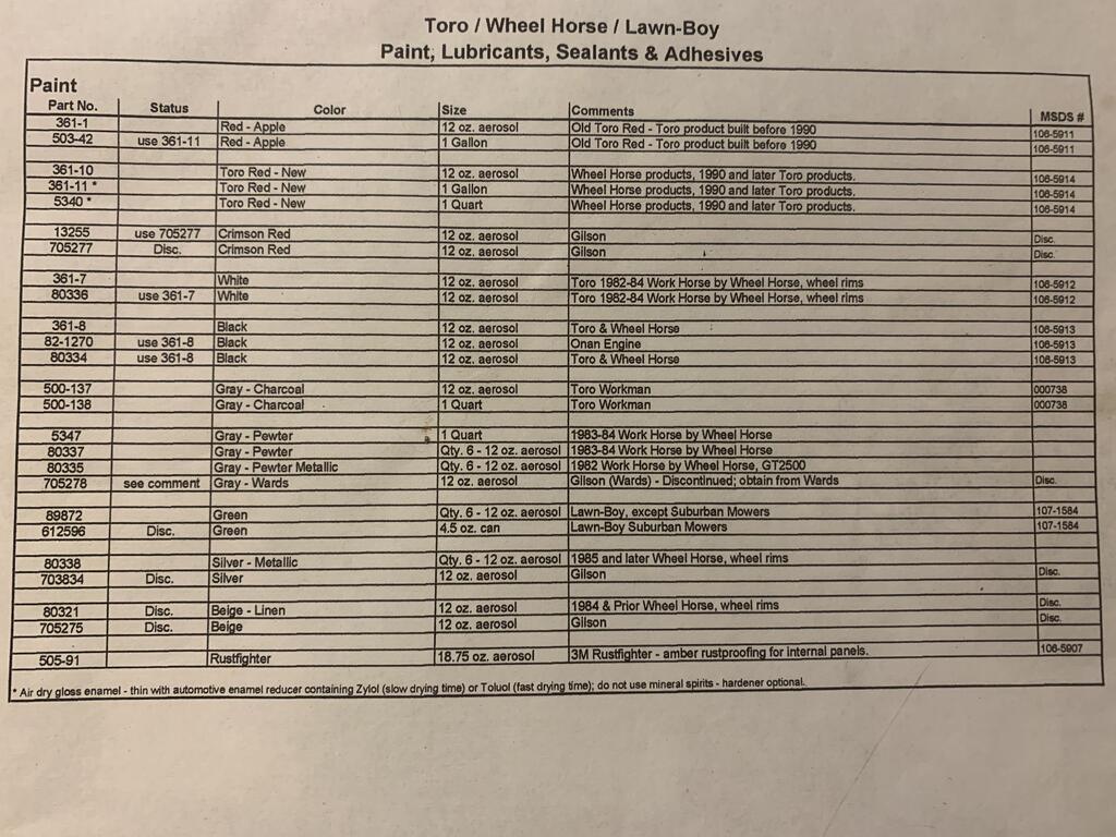

dwayneGT 6 #205 Posted November 1, 2020 This may help to make the list more complete 1 Share this post Link to post Share on other sites
sparkie333 265 #206 Posted December 26, 2020 Yes that is it---I thank you for having this I seen where some--- have been trying to come up with the old paint colors. Would it be ok to post it on MY TRACTOR FORUM? I see where you acknowledged my anniversary I know I came back on here because of some of the changes and I had tp pick another handle ( sparkie333) but I do go back to 2011 I think can you find it and I prob. went by the handle sparkie back then. Share this post Link to post Share on other sites

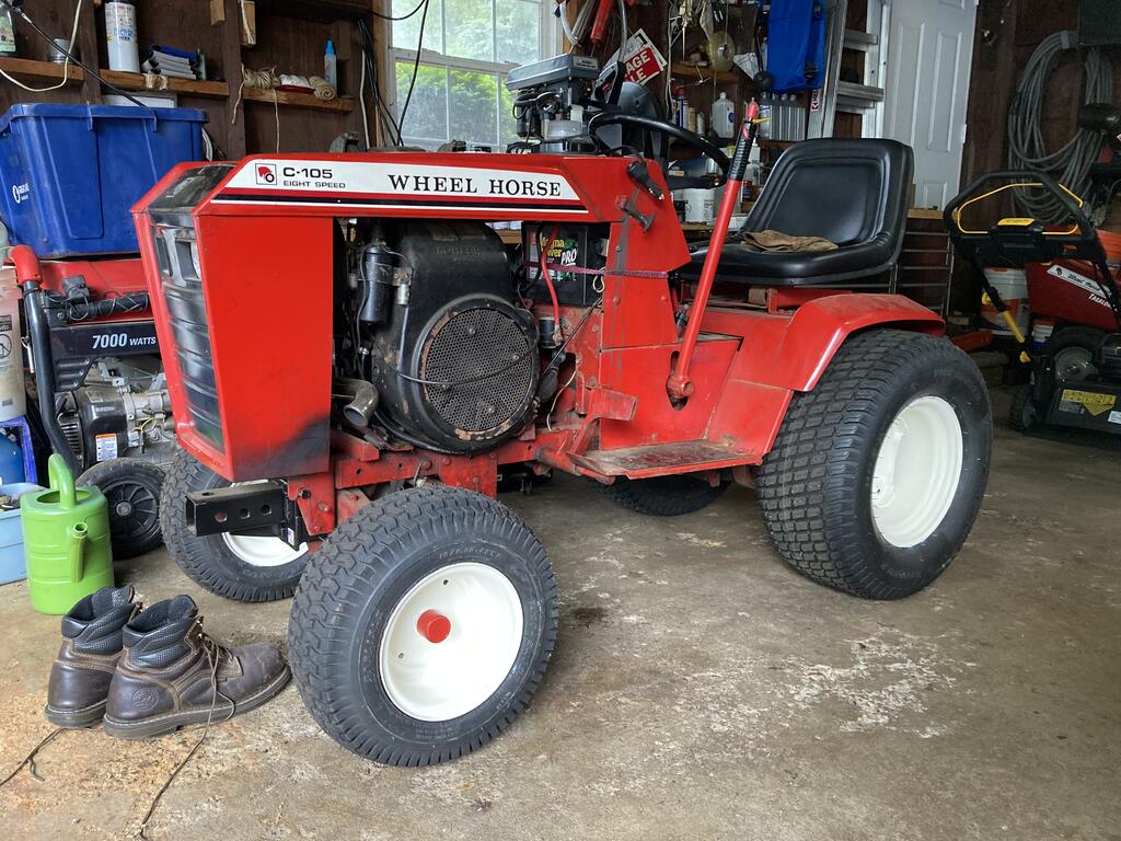

Wheelhorse#1 1,998 #207 Posted December 27, 2020 I used Regal Red Rusto on a deck resto .Don’t think it looks to bad, 4 Share this post Link to post Share on other sites

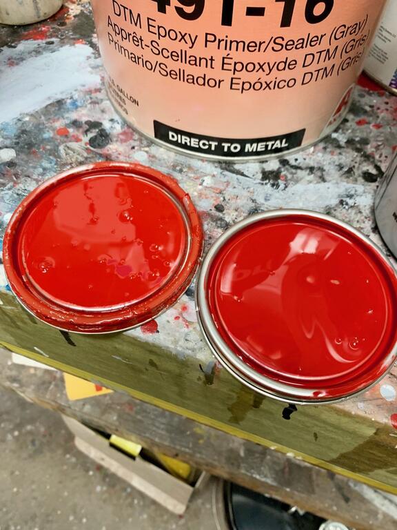

Greentored 3,221 #208 Posted December 29, 2020 Posting here for folks to reference and compare. On the left: PPG ‘Shopline’ IH 2150/ PPG 71310. On the right: IH 50/ PPG 70019. Both are single stage urethane, mixed by the same paint shop/individual. No photos for reference, but Duplicolor DE1653 red engine enamel aerosol is VERY close to the IH50/70019 when applied over the same base. Hope this helps someone along the way. 2 Share this post Link to post Share on other sites

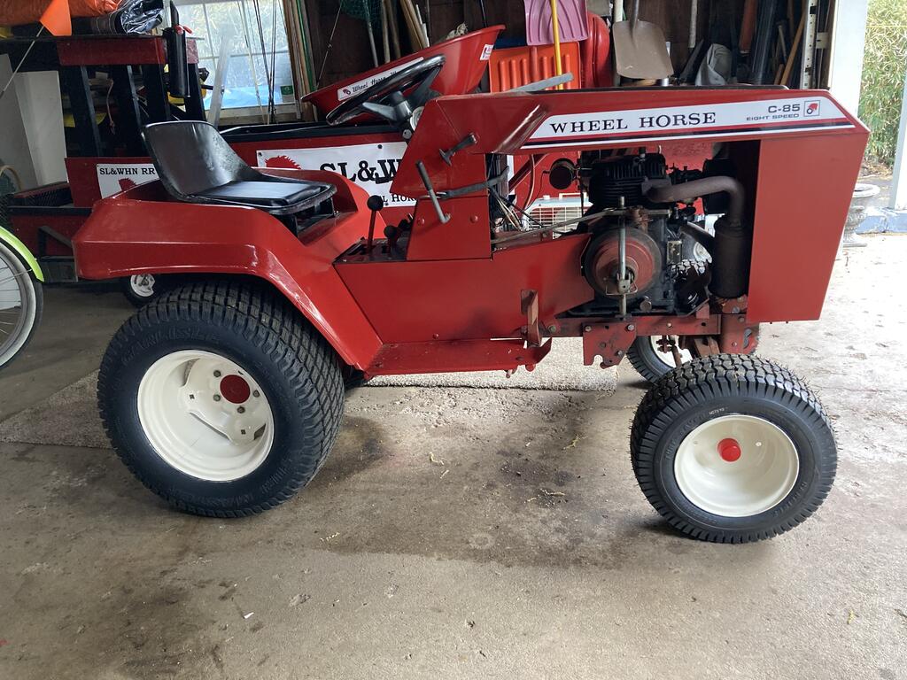

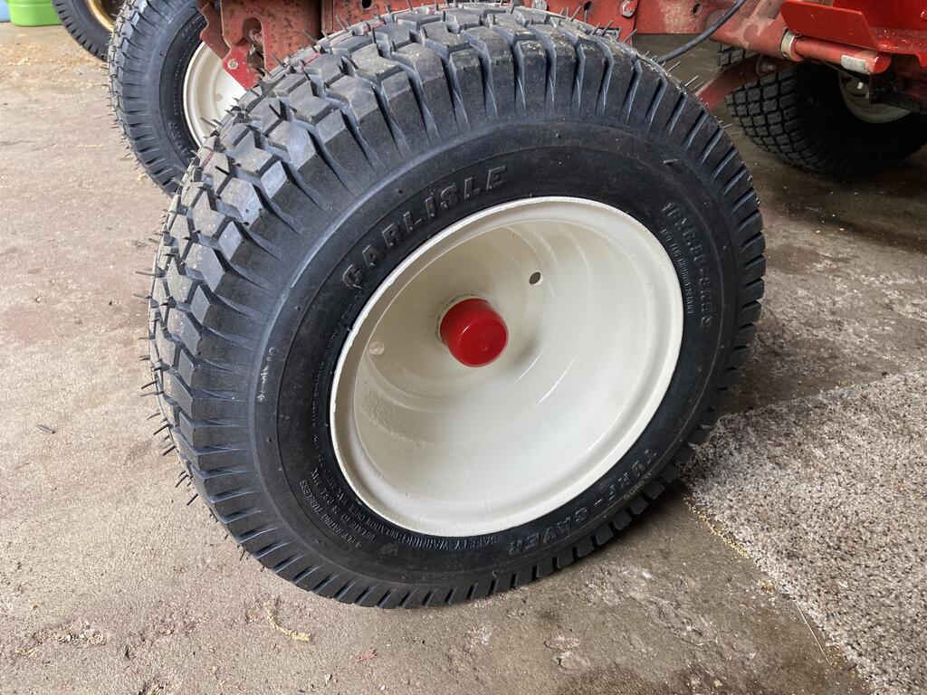

Brockport Bill 2,483 #215 Posted June 29, 2021 i know most questions are about red paint --- this is about the cream/creme color people are putting on rims? I see various standard WH wheel rim colors - typical silver, but also white -- however , i am interested in that one color that has an appearance of being a cream color, or an off white? What color is that? Mfg and color name that people are using? thanks - Share this post Link to post Share on other sites

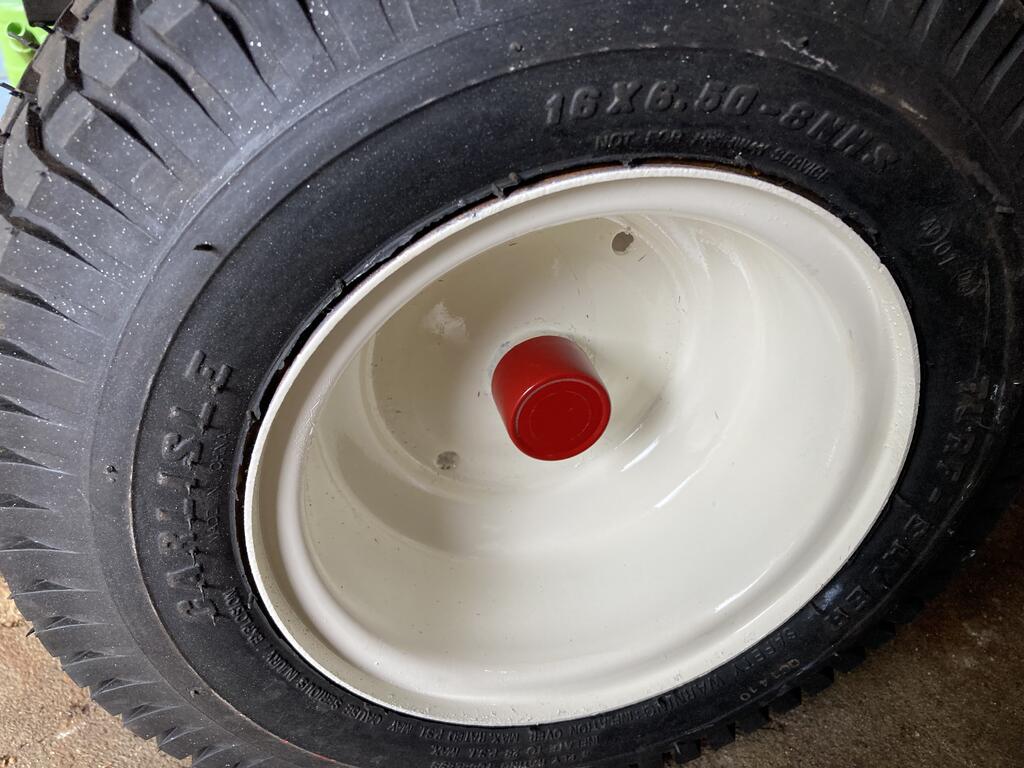

SylvanLakeWH 32,713 #216 Posted June 29, 2021 Example of Rustoleum Canvass White: 2 Share this post Link to post Share on other sites

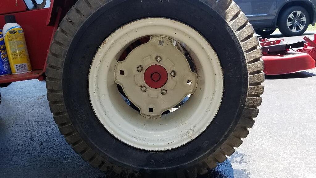

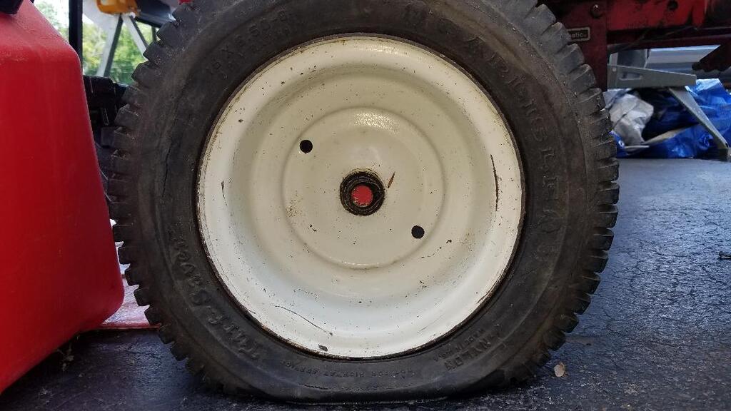

Brockport Bill 2,483 #219 Posted June 29, 2021 here are photos of the "whitish" rims on c175 now............ but i have seen in the Gallery, and other photos, of a deeper more cream/creme color -- thats the mfg and color name i was searching -thanks 1 Share this post Link to post Share on other sites

Brockport Bill 2,483 #221 Posted June 30, 2021 i like the look of SylvanlakeWH "canvas white" -- got a bit of cream/creme and almond tint to it - great contrast to the black and the red 1 Share this post Link to post Share on other sites
