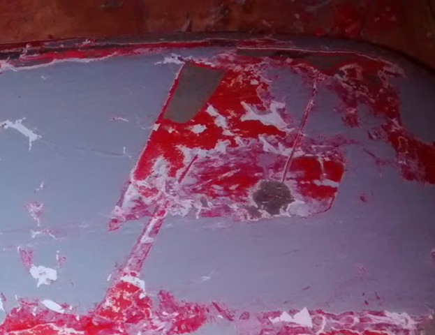

rmaynard 17,614 #113 Posted June 16, 2015 I know this is an old thread, but I thought I would relate an interesting story.Back in 2009/2010, when I was restoring/building my B-100. I was a true novice with painting, so I experimented with a lot of combinations. I had several test panels that I sprayed with different colors and types of paint. One test panel in particular was painted with a modified alkyd (oil) paint, Valspar Restoration Series to be specific. It had dried in the sun for about a week. Then I put it away when the decision was made to scrap alkyds and go with acrylic urethane. Later, probably within a month, I pulled it out, scuffed the paint and shot a couple coats of epoxy primer on it. That panel was put up on a shelf and left until this past weekend. I happened to pull it down to see if I had marked it with what brand of epoxy I had used. I also wanted to see how well the epoxy would sand after 5 years. When I went to sand it, I found to my surprise that the Valspar paint under the primer was still not cured, and after cutting through the epoxy, I could scrape the sticky red paint off with a putty knife.Background:Panel was originally sand blasted.Primed with Valspar Restoration Series gray primer.Painted with two coats of Valspar Restoration Series IH Red (aerosol spray).Allowed to dry for about 30 days.Scuffed and sprayed with Custom Shop DTM epoxy primer (gray).Interestingly, the epoxy cured in less than 5 hours and sanded well at that time, and after 5 years it still sanded without effort. However, theresult here is that the epoxy dried so fast, and is so solvent-proof, that the Valspar which wasn't fully cured to start with, remained uncured until this day.CONCLUSION -- Don't spray epoxy primer over any oil based paint that is not FULLY cured. 6 Share this post Link to post Share on other sites

953 nut 69,881 #115 Posted September 17, 2015 Bob makes a very good point, unless you use a hardener the low VOC paints you get today need to breath for a couple of months. I sprayed a couple of chairs and a week or so later put some materials in a plastic bag in one of them, three days later the bag was stuck to the chair so well I could pick up the chair lifting the bag. Share this post Link to post Share on other sites
