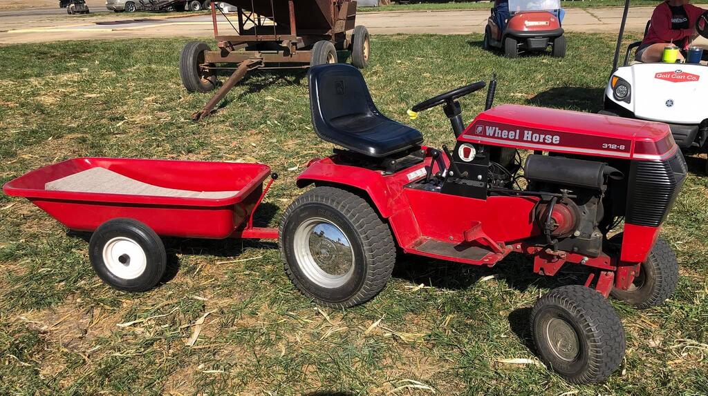

Kevin Bowley 140 #257 Posted February 20, 2025 (edited) I used Rustoleum 2x grey primer and Rustoleum IH Red implement paint. I am happy with it. Before restoring, and below is after. It did take a couple of months for the paint to get really hard so I couldn't dig into it with my fingernail. Now it is extremely hard shelled. The picture below is the first time using it and getting all dusty. Edited February 20, 2025 by Kevin Bowley 7 Share this post Link to post Share on other sites
jackhammer 550 #258 Posted February 20, 2025 Great looking tractor and paints worked out well for you 1 Share this post Link to post Share on other sites
kpinnc 17,011 #259 Posted February 21, 2025 16 hours ago, Kevin Bowley said: I used Rustoleum 2x grey primer and Rustoleum IH Red implement paint. I am happy with it. I have used that before as well with good results. As already said, it's not as fast drying as regular rattle can, but it's got higher gloss and seems to be reasonably durable after fully curing. 1 1 Share this post Link to post Share on other sites
Kevin Bowley 140 #260 Posted February 21, 2025 (edited) That was a "field find" through word of mouth. The seller said it had been setting for three or four years because he broke the spindle when he hit a stump and bought a new Simplicity Coquest. It came with a barely used plow, a solid 48" deck (save a broken spindle), original rear tires and wheels with OEM wheel weights, chains, and a grader blade...no way I could see getting hurt even if the machine was junk. He did drain the gas and ran the carb dry when he parked it. Well, I'll be. I got everything home and, without much hope, dragged it into the garage, hooked up the jump pack, poured a bit of gas into the carb, and it fired right up. Put some in the tank, and it ran like a clock (other than about 100 acorns flying out). All the gauges worked fine, as did the idiot lights. A project was born! I purchased the cool decal kit from RedoYourHorse. I want to add that the OEM Wheel Horse paint for the newer tractors looked like it had a better/smoother mirror-like finish with very high gloss, but the spray head was a horrible haphazard and spatteres pattern, where the Rustoleum sprayed with an easy to control flat vertical pattern just like my LVP and was so close to the Toro I chose that. Very happy once it finished laying out for a couple weeks. Of course the prep was a PITA, requiring puddy in some areas to hide pitting as well as wet sanding the primer with 800, but as we all know, it is the most important part of a nice finish. Edited February 21, 2025 by Kevin Bowley 2 Share this post Link to post Share on other sites
Red Stallion 226 #261 Posted February 24, 2025 On 2/20/2025 at 10:09 PM, Kevin Bowley said: I used Rustoleum 2x grey primer and Rustoleum IH Red implement paint. I am happy with it. Before restoring, and below is after. It did take a couple of months for the paint to get really hard so I couldn't dig into it with my fingernail. Now it is extremely hard shelled. The picture below is the first time using it and getting all dusty. I'm going through the same process at the moment. Do you put a clear coat over the paint, or just leave it painted only? Share this post Link to post Share on other sites
Kevin Bowley 140 #262 Posted February 25, 2025 (edited) On 2/24/2025 at 5:03 AM, Red Stallion said: I'm going through the same process at the moment. Do you put a clear coat over the paint, or just leave it painted only? No clear, 3 coats of Rustoleum 2X coverage primer, wet sanded with 1200 with a block by hand (use 3M sandpaper; it lasts forever), and three coats of Rustoleum IH red implement paint laid on progressively thicker with each. I don't have a paint booth to bake it, so I let it set under my Modine heater for a week or so but could still push my fingernail into it. It was about a month before I took it out and got it dirty. It took three to get extremely hard. I didn't want to use my VLP as it's a PITA, and I can get a great finish with a good-quality rattle can with proper prep. She shines like a mirror. I also use these handles for good control. Be sure to use a respirator! Edited February 25, 2025 by Kevin Bowley Share this post Link to post Share on other sites
Red Stallion 226 #263 Posted February 27, 2025 On 2/25/2025 at 11:24 PM, Kevin Bowley said: No clear, 3 coats of Rustoleum 2X coverage primer, wet sanded with 1200 with a block by hand (use 3M sandpaper; it lasts forever), and three coats of Rustoleum IH red implement paint laid on progressively thicker with each. I don't have a paint booth to bake it, so I let it set under my Modine heater for a week or so but could still push my fingernail into it. It was about a month before I took it out and got it dirty. It took three to get extremely hard. I didn't want to use my VLP as it's a PITA, and I can get a great finish with a good-quality rattle can with proper prep. She shines like a mirror. I also use these handles for good control. Be sure to use a respirator! That's some serious dedication and skill! I dont think I am in that camp as I just want to tidy it up. So using a grinder scotch bright wheel to strip the paint and rust off. A few coats on primer, then two coats of colour. Ive been leaving the bits in the sun for a few days to a week, then putting two coats of clear. Yours is very pretty, while mine is more salt of the earth type! Lots of character! Share this post Link to post Share on other sites

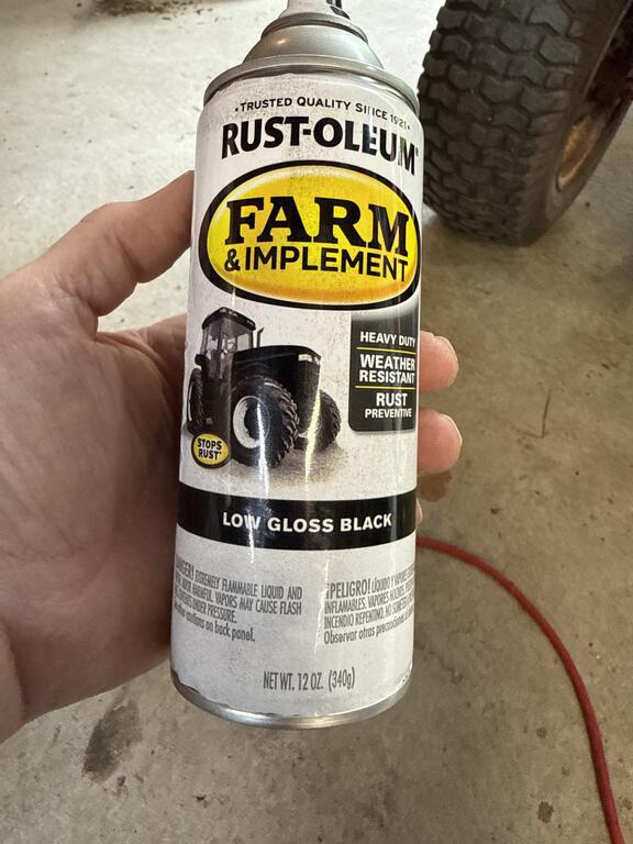

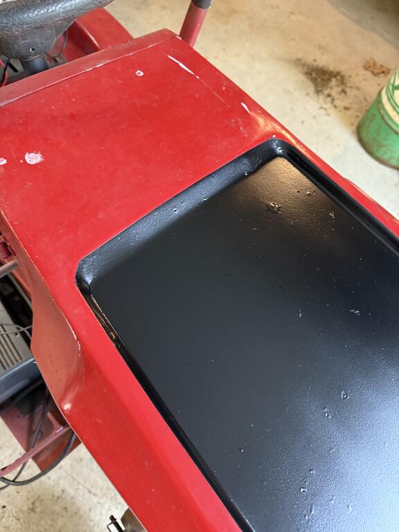

Red Stallion 226 #264 Posted March 12, 2025 PS did anyone ever come up with a definitive black for the bonnet detail? I might just see if there is a Rustoleum black gloss Share this post Link to post Share on other sites
kpinnc 17,011 #265 Posted March 12, 2025 8 hours ago, Red Stallion said: Rustoleum black gloss I always thought a satin black looked better. All the small grooves are difficult to evenly clean up, and a satin finish will help hide imperfections. Gloss black shows everything. 2 Share this post Link to post Share on other sites
Red Stallion 226 #267 Posted December 27, 2025 I ended up forgetting that I had a Rustoleum black, and just used a Dulux Black and then clear coat. Now that all the painting it done, I'm not super happy with the Rustoleum and if I had my time again I wouldn't use it. The bonnet and seat pan had been sitting and curing for months and its still soft as, and I can scratch it off with my nail as its barely stuck to the primer. The cheaper Dulux paints stuck like poop to a blanket and that would cure easily within 24hrs. So in a couple of years I'll probably strip it off again back to primer and recoat it. On top of all of that, Sunrise red has been discontinued! Share this post Link to post Share on other sites
