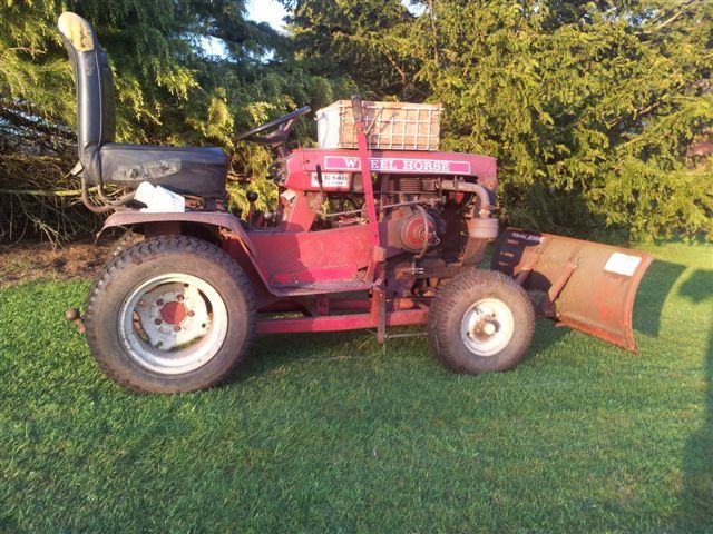

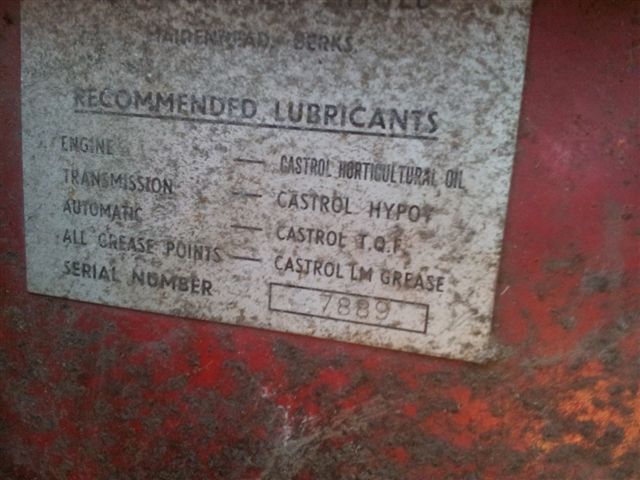

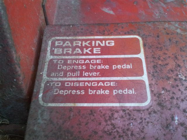

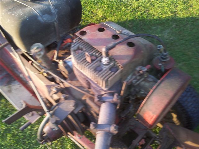

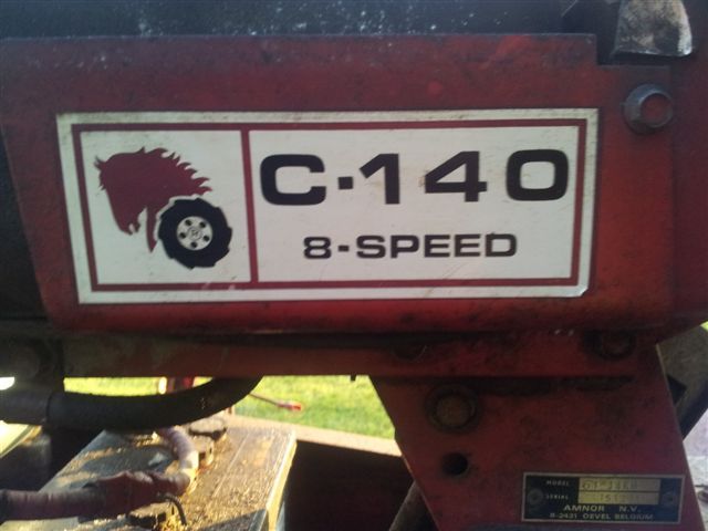

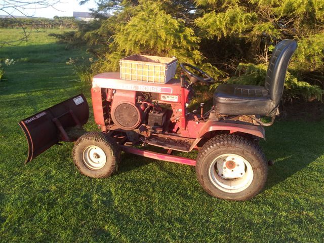

Hello again guys. Just thought I'd post up what has been a minor repair success for me today. Got all the lawns mowed with the Cub Cadet, and then because I was running out of room for grass cuttings, the majority of which were rotted down from last year, I decided to get my Wheel Horse out and bulldoze all the clippings back and out of sight, well, out of the way at least. It did a great job, but after having completed only half of the exercise I lost all forward drive. I wondered what it could be, worrying that it could be serious, clutch, gearbox, worse, lol, but then I noticed that the clutch pedal was remaining depressed. After inspection I discovered that the clutch pedal return spring front hook had snapped off. After a little inspection of the spring I decided that there were enough coils for me to 'borrow' one of them to make a new hook. I put it in the vice, bent the last coil out to form a new hook end, and re-fitted it, and everything was as before. Ten minute repair, when I thought I was potentially going to be faced with something far more complex. Only a little thing, and nothing to you guys, but I still pleased myself at being able to fix it.

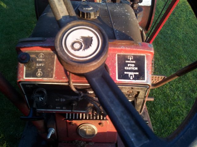

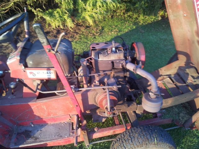

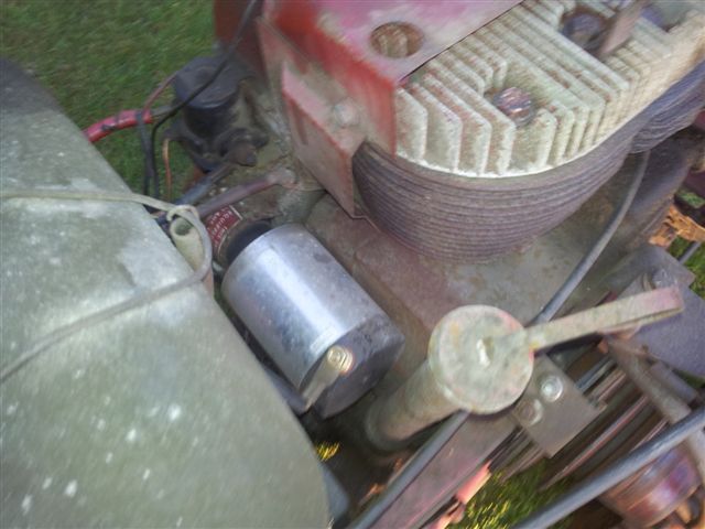

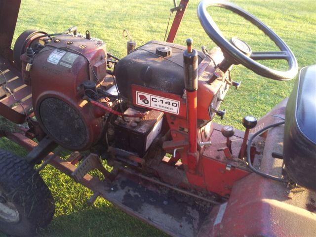

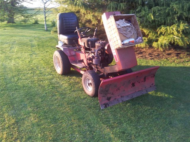

Here are some pictures as promised. Best I could do as I'm no photgrapher, and the only equipment I have is my phone. A few more to follow in a minute if it will let me upload more in another post.
Oh, and by the way, thanks to having done the photos I spotted that my front left tyre wasn't seated properly on the rim, so I'm thinking that I'll let it down, squirt a little silicone lube in there and pump it up again, and hopefully it will press out evenly then.

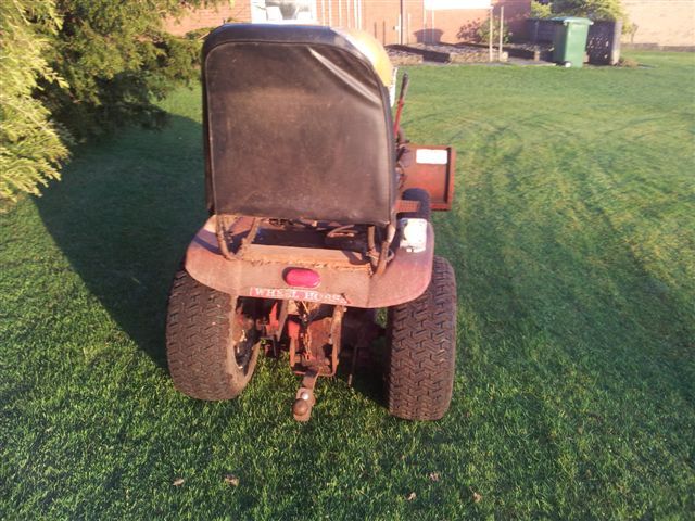

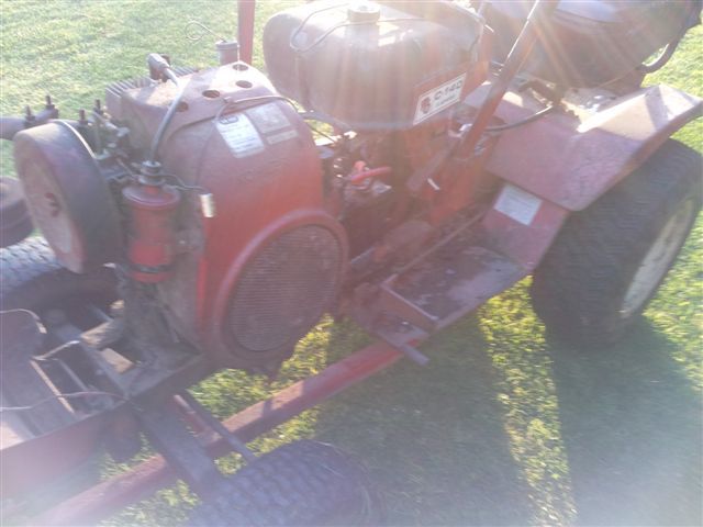

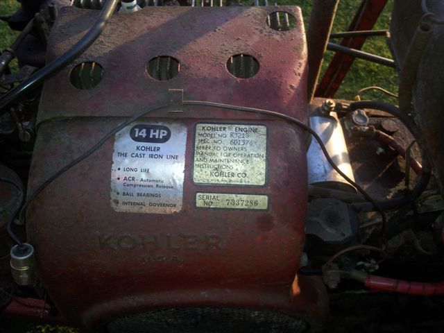

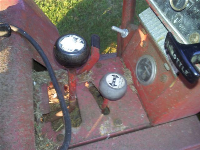

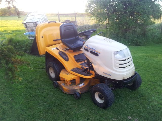

Here are the remainder of the shots, including, if it's allowed in here, :), a quick snap of my Cub Cadet, which is about 7 years old I think.
Cheers

Thanks for the great pictures. I wish they would have made that one over here, but I guess I can just get a C-120 and repower it with a K321. Then Terry could make some decals and we'd have a head turner at the show in June.
  • Like 1
posifour11
Bet that would make the rivet counters recheck their lists.
  • Like 1
AMC RULES
Very cool  :wh:tractor there.
  :text-coolphotos:   :handgestures-thumbsup:    :thanks:
