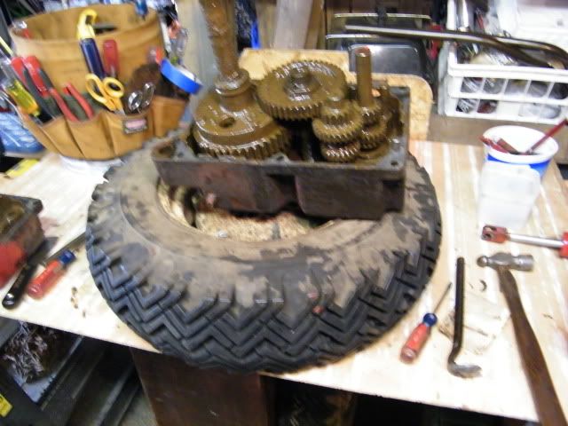

stevasaurus 23,521 #6 Posted March 9, 2010 I tore the trans apart today, and I am glad I did not try to run it any more. I do not have a vice large enough to hold the trans, so I tried sitting it in the rear tire rim. Works pretty good...it is stable, and I can just turn the tire to rotate the trans. I do not see any damage to the gears...lucky...but I will need to replace the seals and bearings. In this last picture, you can see the little ball bearings from the axle bearing sitting on the large gear. Charlie, do you know if I can get these parts...and if things don't go right...when are you coming out this way? Do you have a date yet? Any help finding parts for this #5025 trans is greatly appreciated. :party: Share this post Link to post Share on other sites
Coadster32 793 #7 Posted March 9, 2010 Steve, good idea with the tire mount. The gears all look to be in good condition. The yuck color in there is from previous water getting in the case. It might have locked up because of a loose ball jamming up the gears. Seals and bearings are avail. from Napa, and Kaman. Others have other sourses also. Dig into other posts, and you shall find. Good luck. You have a great start. Share this post Link to post Share on other sites
Lane Ranger 11,687 #8 Posted March 9, 2010 Steve: Good closeups of the trans. In your second and fourth photo it also looks like you have the rod/pin from the shifting forks sitting on top the big gear. Nort sure about the bearing for that transmission. That is the big one that goes in the axle housing you ae looking for right? Kerosene is a good cleaning substance for those gears also! Share this post Link to post Share on other sites

sorekiwi 761 #10 Posted March 10, 2010 That brown goop is gear oil with some water mixed in... The good news is that there was still a fair amount of oil in the mix. I have had transmissions where it was all just crystal clear water - all the oil had been "floated" out past the seals. All the bearings are available through bearing houses except those 2 ball bearings each side of the diff (which you need at least one of). I forget the part #, but it is a special bearing only available thru Toro, and they're about $60 apiece . The other thing that is puzzling is what went wrong. That ball bearing doesnt turn when the tractor is sitting there warming up - it only turns when the tractor is moving. It may have been badly worn and come apart during disassembly. But what went bang while it was sitting there idling? Where did the bolt come from that went flying across the room? I suspect that you might have another issue somewhere, buried under that thick coffee goop. B) Share this post Link to post Share on other sites
Duff 206 #11 Posted March 10, 2010 Steve and others without a big azz vise, here's an idea. When I tore down my tranny I set it in a Black & Decker Workmate (one of those adjustable work bench thingies). I let the axle housing pass down between the two halves of the top and put a block under the front of the tranny to level it, then tightened down on the axle housing. Worked slick! I, too, am waiting to hear where the mystery flying shrapnel bolt came from! Duff B) Share this post Link to post Share on other sites

stevasaurus 23,521 #14 Posted March 10, 2010 I cleaned out the trans today...what a nasty labor of love. All the gears were fine, no teeth missing or chipped. Both axle ball bearings are shot and I accounted for all 24 balls. (12 in each bearing) Two of the balls got lodged in the differential and had it locked up, but a little back and forth and the balls fell out. those bearings getting shot around the housing is the noise I was hearing. Also, the needle bearing on the drive wheel shaft was damaged and needles were all over the casing. I still don't know about the mystery bolt...nothing seems to be missing. Waiting for parts...got the manual from MikeRJ (thanks) and Rickv1957 has some of the bearings for me. (thanks also) :party: Share this post Link to post Share on other sites
