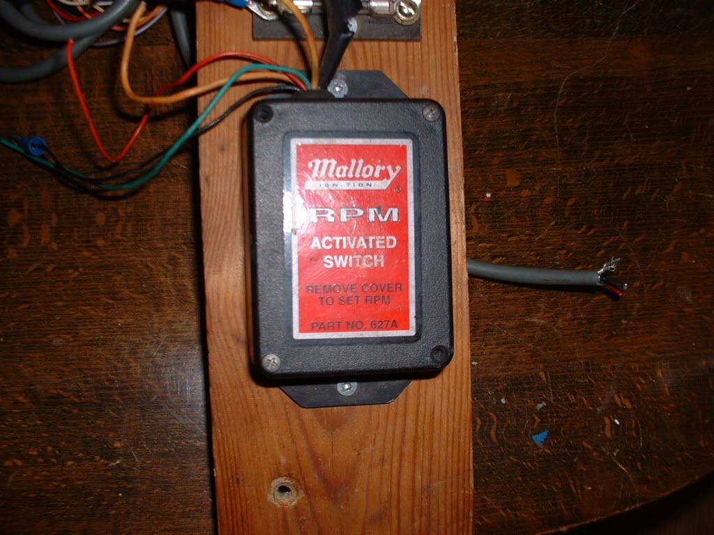

wheelhorsepuller 1 #64 Posted April 27, 2008 I got a bit more done today... moved the number sign, finished my fiberglassing, put the guard on the chain, added the switch board... Tonight I will get the chain tensioner on and start on the body work... and go for a spin... Share this post Link to post Share on other sites
