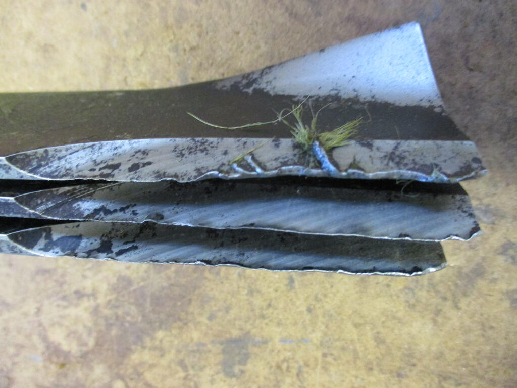

In continuing the saga of a loaner came that came home I was trying to sharpen the blades my nephew damaged.  Working with them I realized one blade has developed a  bow ...both ends bent up .  Sitting on a flat surface it rocks end to end. The other two blades only move slightly.  I put it in my 20 ton press and you could see it flatten out but when I released pressure it sprang back.  It was the most damaged of the 3.
Anything I can do???

Flattening that in a press probably won't be able to fix it.
If you don't have to go very far I would be tempted to, over straighten, so to speak.
Go slightly past the point that you think is straight and let go.
Probably have to put one end in a vise and use a large wrench maybe even with a convincing pipe?

Well that says it all. I'm a nice guy, but not THAT nice (ask my kids). Your nephew needs to procure a new set of blades for you. Even if they are NLA.  A little "Visual Reinforcement" of the money leaving his wallet does wonders. Seriously, blades are tempered - they bend once, then fracture & break if force is applied in the opposite direction. Not worth the damage they can cause. Reminds me of Ralph Nader's book on the Corvair - Unsafe at Any Speed...
DO check the accompanying spindle for being bent too....:(

Probably have to heat it to remove the temper. Bend it and then retemper.       Being bowed may not matter if you can get the blade tips at the same elevation.
