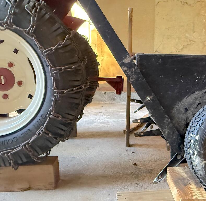

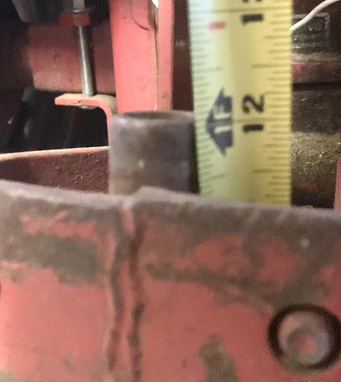

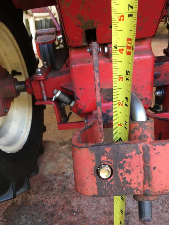

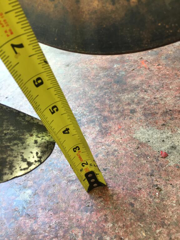

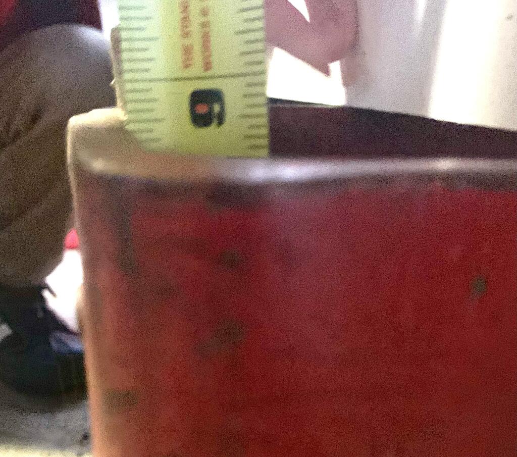

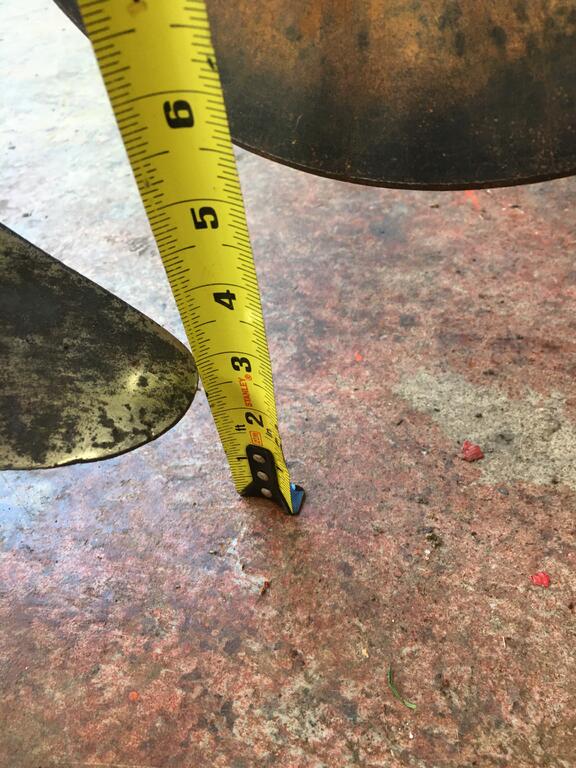

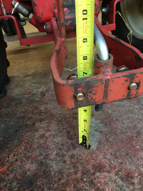

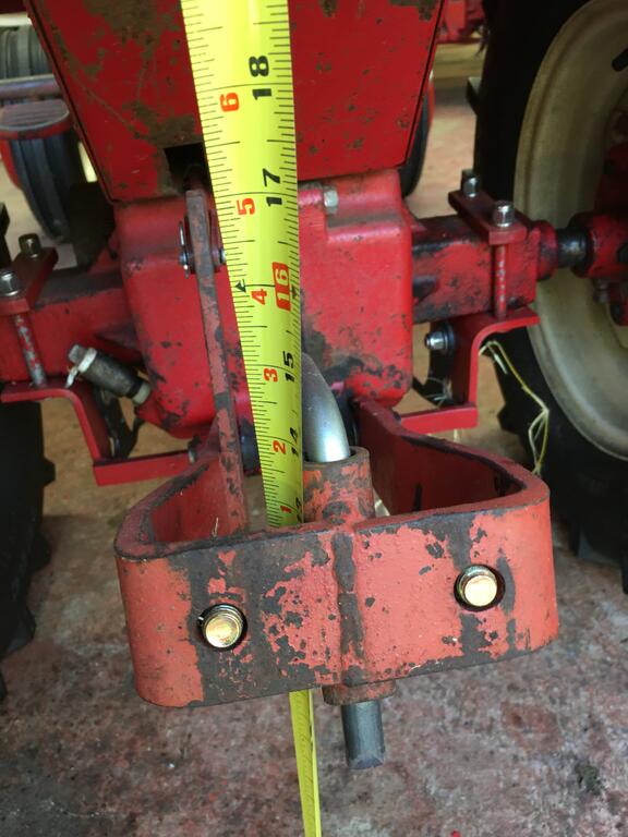

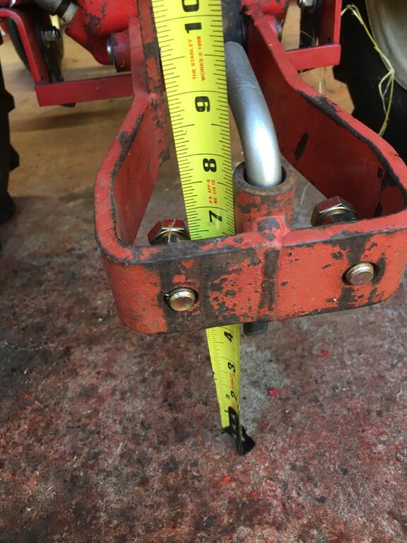

Handy Don 17,534 #1 Posted 6 hours ago We are looking to convert an aerator to be on a sleeve hitch (similar to a soil plow) and have it switchable between our 520-H and 854 (they are in different locations but we’ll share the aerator). Our goal is to enable easier lifting the drills over hardscape sections and when making turns. We also want to be able to back into tight areas, unreachable with the towed aerator, lower the aerator, and drive out. On the 854 (armstrong) using a slot hitch with a WH slot-to-sleeve adaptor we have a range from 9.5 to 16 inches (measured from the top of the sleeve to the ground, about 10” from the transaxle pivot). On the 1995 520-H, the range is only from 9 to 12 inches (also about 10” from the transaxle pivot). This with the chain to the sleeve arm in the lowest notch in the rear rock shaft and having the hitch parallel to the ground at its lowest point. The cable at the 520’s mid-rock shaft is attached at the prescribed hole in the down-pointed arm. When using the mower or front blade, the lift range is as expected. Am I missing something? Is this relatively short lift range normal? If not, what range should I be expecting? This image was while checking alignment and clearances with the 854, slot hitch, and adaptor. Both the tractor and aerator are on 3.5” blocks to accommodate the drill plugs being in their “in the ground” position. Hitch is at its lowest position. Here are the 520 measurements. Share this post Link to post Share on other sites

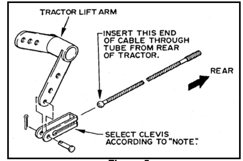

ri702bill 13,149 #2 Posted 6 hours ago Cable lift - right? Placement of the cable in the lift bellcrank hole location dictates either a short, easy lift or a longer, more difficult lift... Share this post Link to post Share on other sites

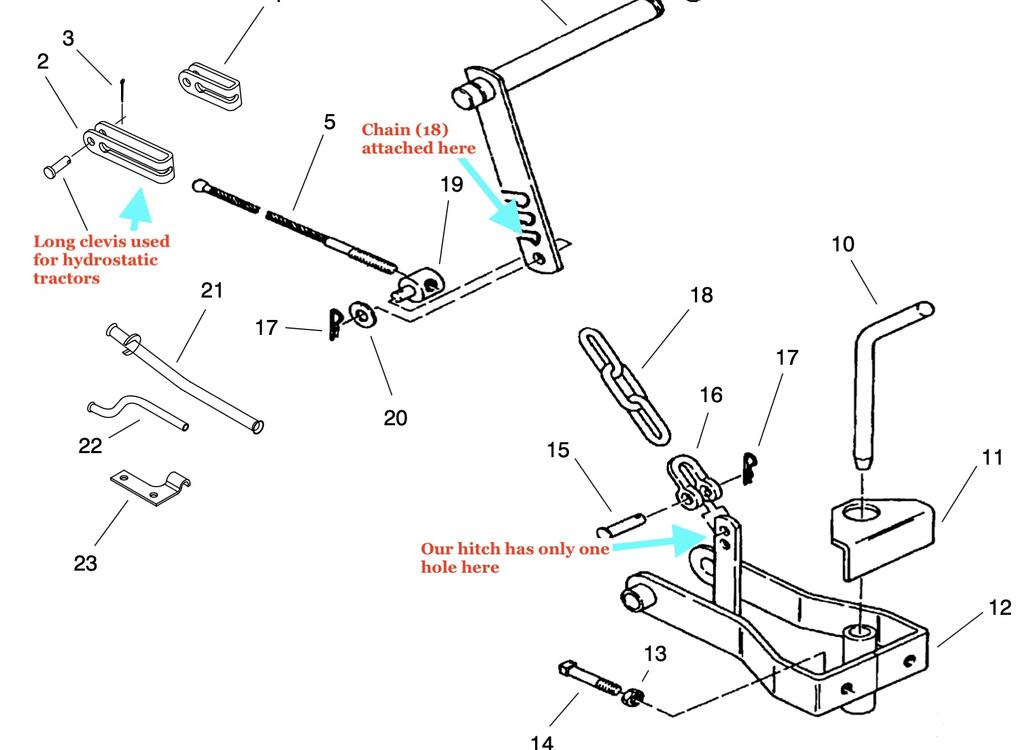

Handy Don 17,534 #3 Posted 5 hours ago 46 minutes ago, ri702bill said: Cable lift - right? Placement of the cable in the lift bellcrank hole location dictates either a short, easy lift or a longer, more difficult lift... There is only one hole in the 520’s mid-tractor rock shaft for attaching the rear cable clevis and it is the furthest from the shaft’s axis. The rear end of the cable only attaches (in stock form in my experience) to the lowest end of the rock shaft arm. I’m wondering if some sleeve hitches had multiple chain attachment points on their lever arm. Share this post Link to post Share on other sites

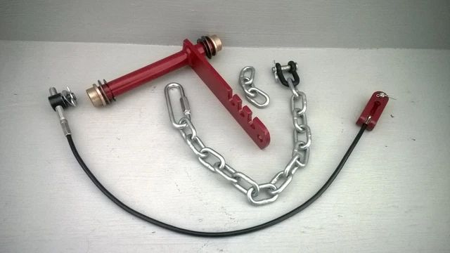

squonk 48,203 #5 Posted 2 hours ago 2 hours ago, Handy Don said: I’m wondering if some sleeve hitches had multiple chain attachment points on their lever arm. Some of the rear rock shafts had multiple slots for the chain. Are you using a rear shaft on the 520? Share this post Link to post Share on other sites
Goldnboy 1,154 #6 Posted 22 minutes ago (edited) I am having a similar situation and my rear rockshaft doesn't have the multiple slots on my C161 Edited 21 minutes ago by Goldnboy Share this post Link to post Share on other sites
Handy Don 17,534 #7 Posted 20 minutes ago 1 hour ago, squonk said: Are you using a rear shaft on the 520? Yep, that very one. Cable thread-adjusted clevis attached through the hole at the end of the arm. Chain in adjacent slot. Our hitch has only one hole in the arm of #12 and we used the long clevis to attach the cable to the tractor lift arm because its a hydro transaxle (its curved cable routing dictates the extra length). Share this post Link to post Share on other sites
