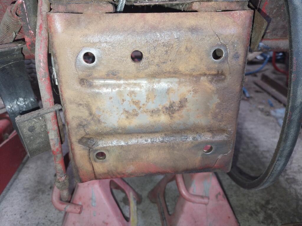

Hello has anyone experienced the transaxle bracket on a wheelhorse 312 8 cracking and causing the transaxle to be loose or even fall off?

Got pics?

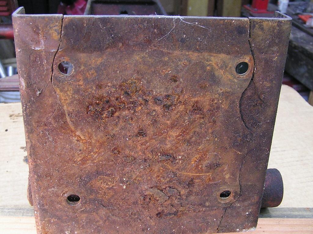

Are you referring to the "F" plate on the frame?? All too common.
This is the worst one I came across... Fixable but time consuming. 3 out of 4 crackedout - 2 connected together.

The "F"  plates crack on all Wheel Horse tractors if the tractors are used for jerking or pushing heavy objects.    Like jerking stumps or ramming into solid snow banks with a plow.
The transaxle stops and the other 450 lbs of tractor keeps moving causing the damage to the transmission bolting plate.

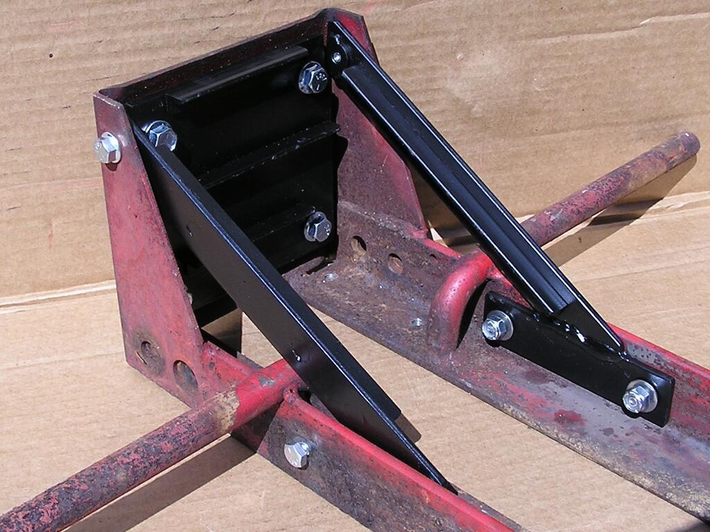

Yes - WH USED TO sell a repair kit that needed to be welded in. It is now NLA.
Several of us on the Forum, myself included, have fabricated our own repair plates and stiffening braces to stop the frame flexing for good...
PM me if interrested in more info.

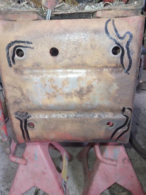

Yes that's it mine isn't as bad as that though
