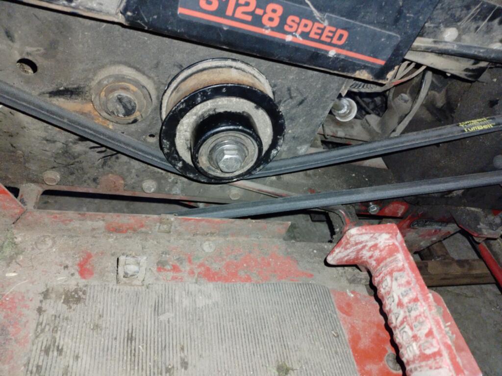

Wheelhorse3128
That's what I'm thinking as the belt I have is too long anyways as I swapped the pulley to get more speed and the belt I got was too long so I put a idler pulley on that was supposed to be temporary while i got a shorter belt but it works well so I left it on
sqrlgtr
Dont forget to allow for the longer wheelbase if u go with plate between trans and frame, think shifter location and such.
Wheelhorse3128
Will probably just add a 5mm thick plate so will be able to move stuff back 5 mm I think

5 mm should not affect the belt length, but may require a motion control linkage adjustment.
