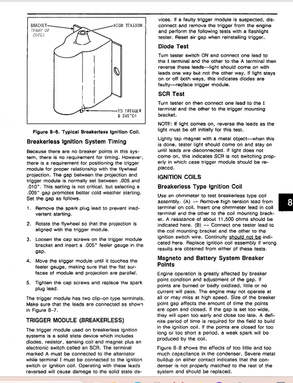

I was called to help the FIL on a no start - no spark Kohler K 14hp - loaded up my bag with tools - points - plugs - wires etc etc only to get smacked right in the face with a short lived ( unknown to me ) breakerless magneto ignition  - on a 1974 power king economy .
A little  reading this was a common failure point on these engines - Kohler went back to points and quit making replacement parts - for a short time they offered a conversion kit for some .
Are there any sources for the trigger or magneto ?  I’m drawing a blank even coming up with the old part numbers to search for aftermarket or NOS . Reading the interwebs forums from 15-20 years ago some were saying the parts if you could find them were astronomically high in price  and you were taking a chance on another bad one .
The block has the holes for points and a cover but I didn’t look close enough to see if they were threaded and seems getting the dust cap out for the points plunger rod is a real bear . I came home to research and regroup - the tractor is no longer in front of me .
Any advice or direction ?
