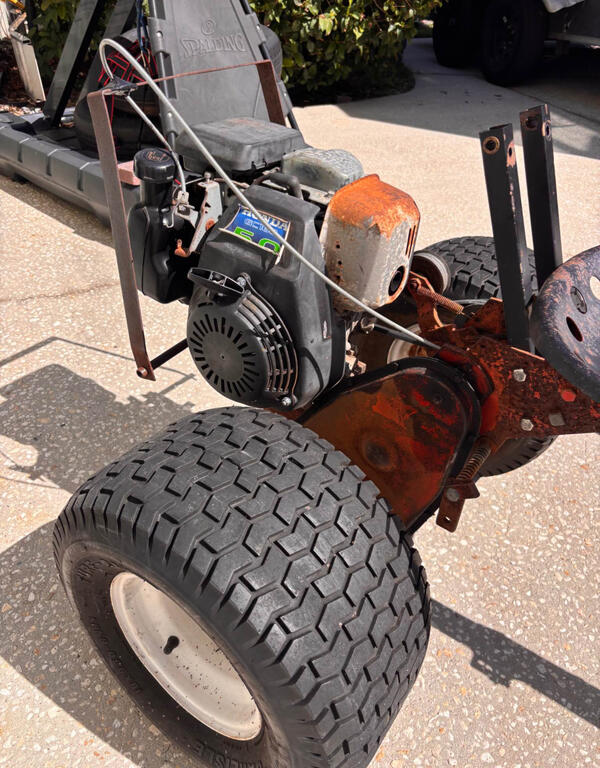

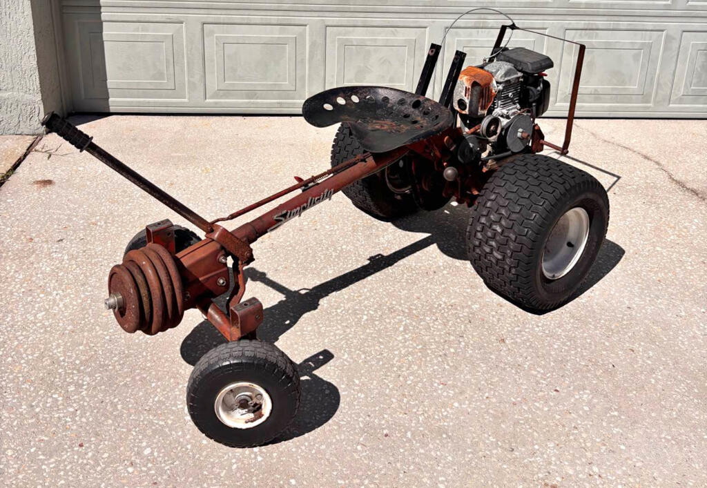

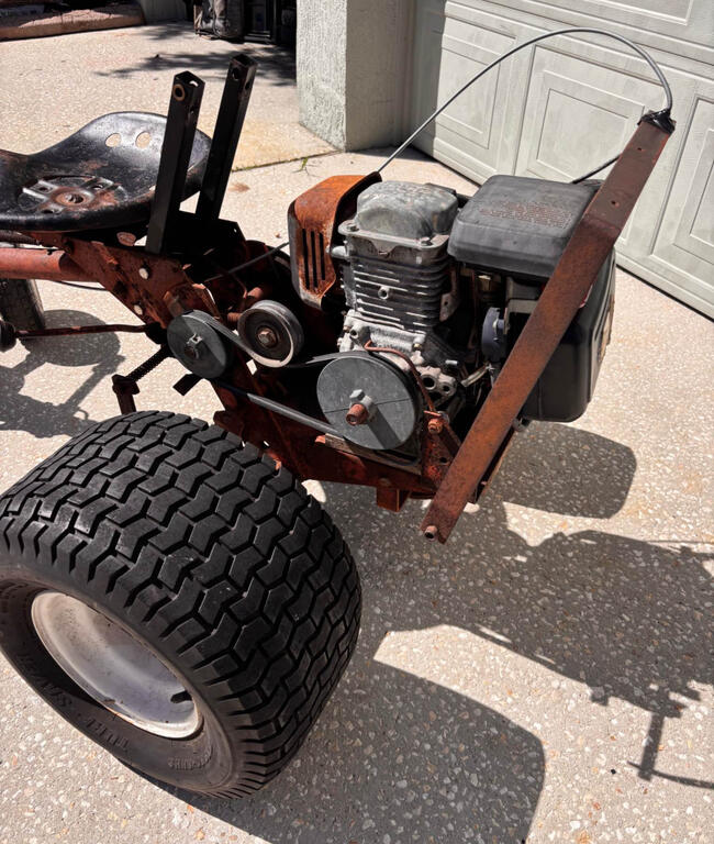

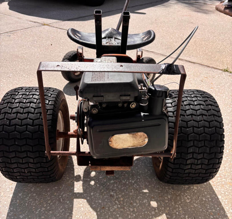

FLtractor 253 #1 Posted October 13 Evening, Another marketplace listing, Seller add states ward tractor but I see a simplicity badge. The hand lever is both the brake AND steering? She’s asking $50.00. Would it be able to tow a cart around yard if I had small metal tab hitch added? 1 2 Share this post Link to post Share on other sites
ebinmaine 81,278 #2 Posted October 13 I'd be SUPER curious to know exactly how it drives but I would NOT attempt to tow anything with it. Save the $50 for fixing your own Wheelhorse. 3 Share this post Link to post Share on other sites
FLtractor 253 #3 Posted October 13 33 minutes ago, ebinmaine said: I'd be SUPER curious to know exactly how it drives but I would NOT attempt to tow anything with it. Save the $50 for fixing your own Wheelhorse. Apparently the Lever. Forward =forward back=back.. so perhaps middle is brake? read on eBay ad.. Share this post Link to post Share on other sites

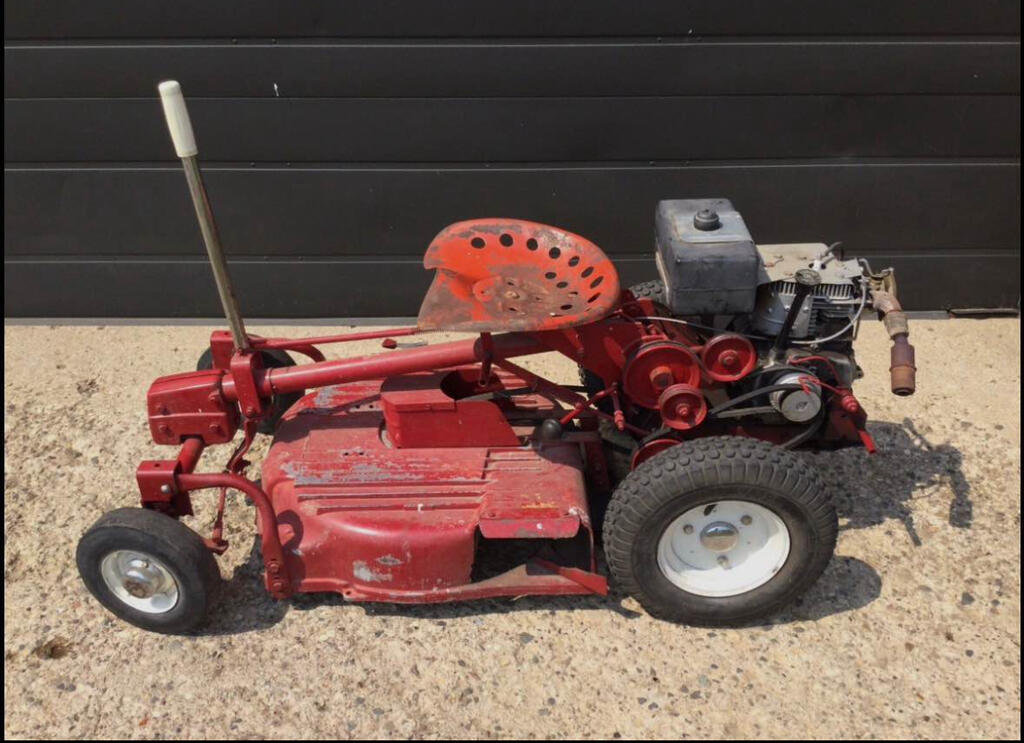

FLtractor 253 #6 Posted October 13 (edited) 25 minutes ago, adsm08 said: Looks like a broomstick.... Appropriate, given the month I suppose. Hahahah. Limbuster 2026. Here is a photo the seller also posted of what it looks like when it has deck Edited October 13 by FLtractor 1 Share this post Link to post Share on other sites

Achto 32,962 #10 Posted October 13 (edited) 10 hours ago, FLtractor said: The hand lever is both the brake AND steering? She’s asking $50.00. Would it be able to tow a cart around yard if I had small metal tab hitch added? The strait steering handle indicates that it is a 1957 Simplicity Wonderboy. In 1958 they put a slight bend in the steering handle like the one pictured above. I would not recommend using it as a tow tractor and here is why. - It has 1 speed forward and one reverse. The steering handle is also the clutch. Pull back on the handle to make it go, let go of or push the handle forward to disengage the drive. There are NO BRAKES ! The only thing that stops it is the friction of the drive system. Would still be a fun ride around tractor for an adult for the money. Would not recommend a kid drive it unless you rigged a better place for them to put their feet. Edited October 13 by Achto 4 2 Share this post Link to post Share on other sites

Kenneth R Cluley 713 #15 Posted October 13 The added "weights" to discourage wheelies would be my first alarm. Hook anything to the back behind the axle and you could definitely end up vertical! Share this post Link to post Share on other sites
ri702bill 13,391 #16 Posted October 13 2 hours ago, FLtractor said: I would not recommend using it as a tow tractor and here is why. - It has 1 speed forward and one reverse. The steering handle is also the clutch. Pull back on the handle to make it go, let go of or push the handle forward to disengage the drive. There are NO BRAKES ! The only thing that stops it is the friction of the drive system. Words of wisdom there. It can barely stop itself on level ground - whatcha think it's going to stop a half ton load on a trailer going down hill?? Maybe have to use the Fred Flintstone brakes?? Yabba dabba don't. 1 Share this post Link to post Share on other sites

Rick3478 478 #21 Posted October 14 WonderWhy was the joke name back in the day. Monkey Wards carried Simplicity for awhile. I actually had one of these many years ago. Someone has repowered this one, and it looks like the drive pulleys have been changed for more speed. Mine was a pretty good wheelier with the stock drive ratio, so the added front weights are probably needed. There's not much to hold onto except the handle, and leaning on that makes it turn, so you have to get the feel of it pretty quick. 1 1 Share this post Link to post Share on other sites
