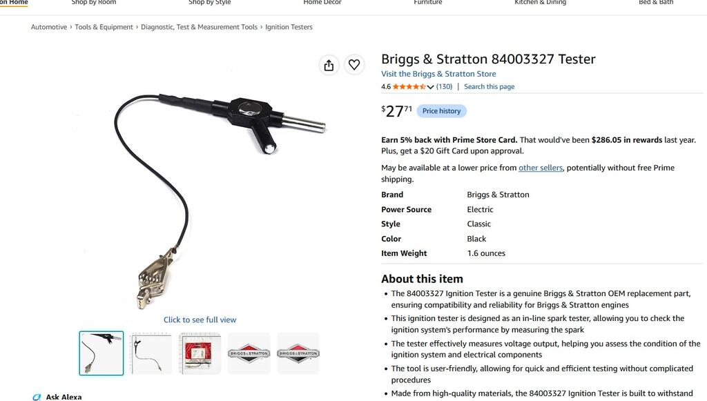

pfrederi 21,089 #2 Posted 2 hours ago What kind of spark tester are you using. The Harbor freight neon bulb type will often flash yet there is insufficient juice to fire the plug. B&S type will give a better picture of strength. Share this post Link to post Share on other sites
