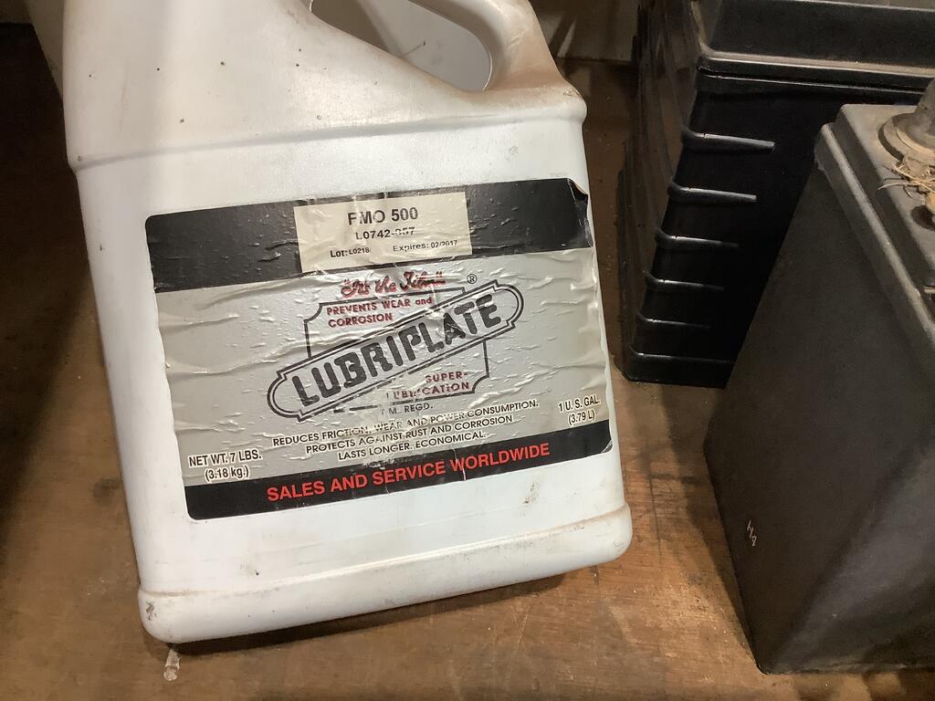

CRF857 1,521 #1 Posted September 14 I have a gallon of Lubriplate FMO 500. Am wondering if it would be good to use on the underside of the mowing deck. Share this post Link to post Share on other sites

SylvanLakeWH 32,914 #5 Posted September 15 Can't hurt... expired in 2017, so either use it for bicycles chain oil or put it on the deck and see what happens... 1 3 Share this post Link to post Share on other sites
Ed Kennell 47,937 #6 Posted September 15 I used Lubriplate for years to coat and waterproof carbon steel hydro turbine parts. It sticks and holds up well My main use now is to lube and waterproof bolt threads. 1 1 Share this post Link to post Share on other sites

lynnmor 9,081 #9 Posted September 15 (edited) 16 hours ago, CRF857 said: I have a gallon of Lubriplate FMO 500. Am wondering if it would be good to use on the underside of the mowing deck. I think that it would hold up very well for about .0025 milliseconds, just like any other oil. It is 30 weight oil that I would use for chain lube in a chainsaw. Edited September 15 by lynnmor 1 Share this post Link to post Share on other sites
