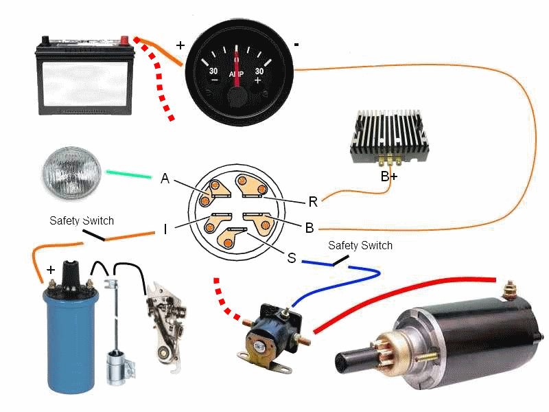

953 nut 69,805 #2 Posted September 7 here is a simple drawing to help you see how the spark system is wired using a 103990 battery ignition switch. All of these components needs to be grounded to operate. 6 Share this post Link to post Share on other sites
TC10284 121 #3 Posted September 8 1 hour ago, 953 nut said: here is a simple drawing to help you see how the spark system is wired using a 103990 battery ignition switch. All of these components needs to be grounded to operate. I guess it was running off the battery then and not being recharged by the stator/diode if I'm reading that right. 1 Share this post Link to post Share on other sites

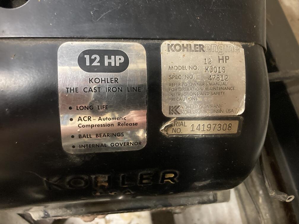

gwest_ca-(File Mod) 12,510 #6 Posted September 8 No low oil switch in the rear base of the oil pan = 1985 model Kohler spec # 47812 If you have a low oil switch in the rear base of the oil pan it is a 1986 model - Kohler spec # 47828 3 Share this post Link to post Share on other sites
TC10284 121 #7 Posted September 8 1985 since my engine spec is 47812 on the sticker (from my pictures link). 2 Share this post Link to post Share on other sites
953 nut 69,805 #8 Posted September 8 11 hours ago, TC10284 said: I guess it was running off the battery then and not being recharged by the stator/diode if I'm reading that right. The stator will recharge the battery, your ignition coil needs a wire from the "-" side going to the ignition points and condenser and a wire from the ignition switch to the "+" side to produce spark. Here is a wiring system guide for your , it has each system including the ignition shown sepertely. 1 1 Share this post Link to post Share on other sites

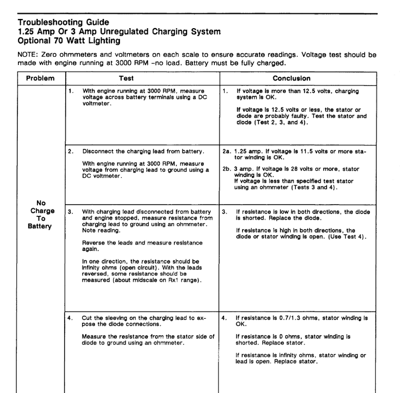

TC10284 121 #14 Posted September 12 (edited) I am confused. I tried to run through the stator tests posted above. Measuring across the battery I get battery voltage of 12.4v when the engine is not running. Same 12.4v when it is. Test 2, how do you even test for that if you can't disconnect the charging lead without killing the engine? The only way is to disconnect the yellow a/c wires from the main connector. The diode tests good. I can see the headlights get brighter or dimmer with throttle. So I know at least part of the stator is working. If Iconnect a known good diode to the yellow wire from the stator that is supposed to charge the battery, I see a maximum of 10v at WOT and 8v at idle. If I swap to the other yellow wire that is supposed to run the headlights and temp put a diode on that wire, I get at most 10v at idle, and the voltage actually drops to 9v at WOT. Edited September 12 by TC10284 Share this post Link to post Share on other sites
pfrederi 21,218 #15 Posted September 12 (edited) Pull the R wire from the back of the ignition switch and measure that to ground Edited September 12 by pfrederi Share this post Link to post Share on other sites
TC10284 121 #16 Posted September 13 (edited) I will try checking the R wire on the ignition switch next time I work on it. Before seeing your reply, I put a NOS 3amp stator on it (correct Kohler p/n for this engine) that I bought and the voltages look way better. But when I'm idling with the diode temporarily inserted into one of the stator leads, I was seeing around 13v DC. But when I move to WOT, I see way higher voltage of 20v to 30v. And this is a new diode. That was straight off the diode, so I'm hoping that when I connect it to the tractor wiring harness, I'll see appropriate voltage across the battery terminals. Edited September 13 by TC10284 Share this post Link to post Share on other sites
TC10284 121 #17 Posted September 15 (edited) Just an update for those interested. I went to put a diode on the new stator and cut back some of the sheath covering the two wires and found there was a diode already on the black wire. So I'm really glad I cut the sheath and found that instead of assuming I needed to add a diode. So I wrapped it all back up nicely with black electrical tape, hooked it up and I'm finally showing over 12.5v across the battery terminal when at 3000rpm or higher. Must have been the stator all along. Edited September 15 by TC10284 1 Share this post Link to post Share on other sites
