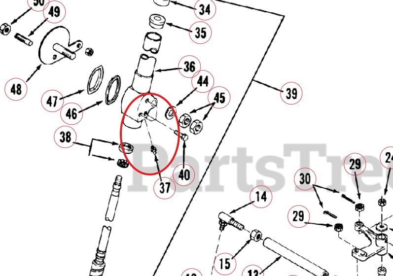

oliver2-44 11,766 #3 Posted September 7 I've never had a "D" Series, but a couple of other tractors I have use steering boxes like that. If the steering feels a little "crunchy" the bottom ball bearings #38 are probable rusty or shot. If the tractor sat outside, those steering boxes are prone to get water in them. The bearing typically has a plastic retainer that holds individual bearing balls. You can get individual replacement balls in those gray drawers at your hardware store. if the plastic retainer is shot, you can reassemble with heavy grease temporarly holding the balls in place. 5 Share this post Link to post Share on other sites
