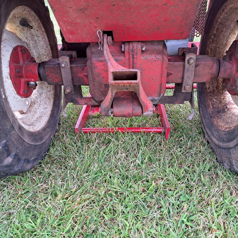

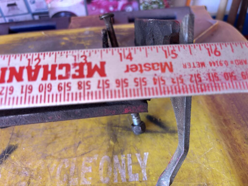

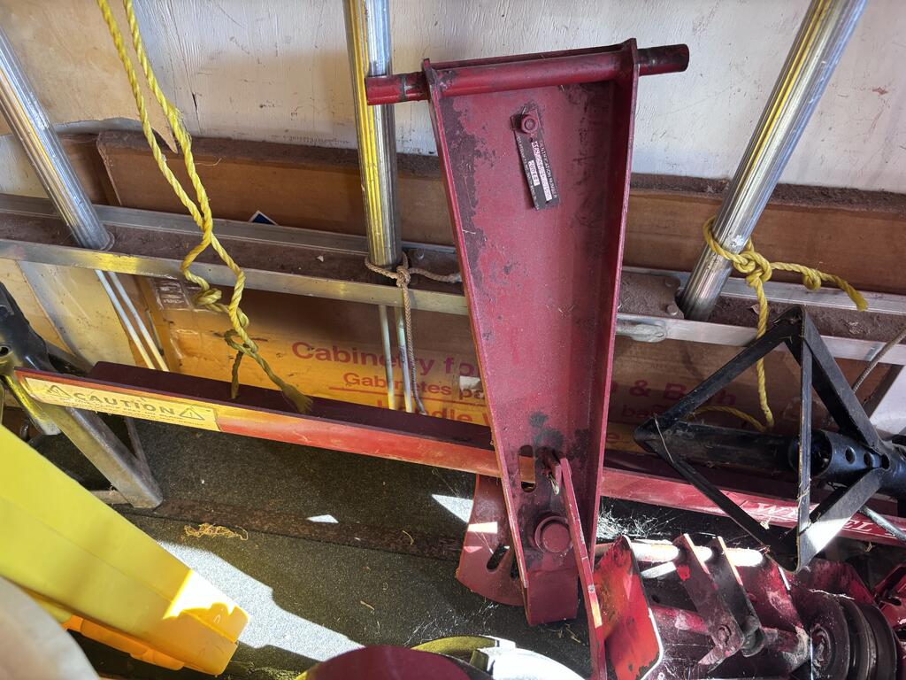

WHX?? 58,302 #1 Posted September 7 So @Achto and I were at show and had a little gravel pile to play in with our mid mounts & blades & loaders. I had brought this pusher rear mount to play with but neglected to bring along a axle bracket. No big deal I'll just one off of pale face Dan's 856. Well this wasn't gonna work. I had thought all brackets were the same. What bracket to I need to run this? 1 1 1 Share this post Link to post Share on other sites
ri702bill 13,187 #2 Posted September 7 That is a later style Grader blade - the "push" style. It requires the later C series, 300, 400 bracket. The "pull" style required no axle bracket - it mounted to the mid Tach-a-matic frame mounts like a cutting deck. 3 1 1 Share this post Link to post Share on other sites
ebinmaine 80,904 #3 Posted September 7 21 minutes ago, WHX?? said: So @Achto and I were at show and had a little gravel pile to play in with our mid mounts & blades & loaders. I had brought this pusher rear mount to play with but neglected to bring along a axle bracket. No big deal I'll just one off of pale face Dan's 856. Well this wasn't gonna work. I had thought all brackets were the same. What bracket to I need to run this? Jim. That axle bracket is for a SHORT frame plow. You need the one that faces downward. Without bolting on the front as this one does. 2 1 1 1 Share this post Link to post Share on other sites

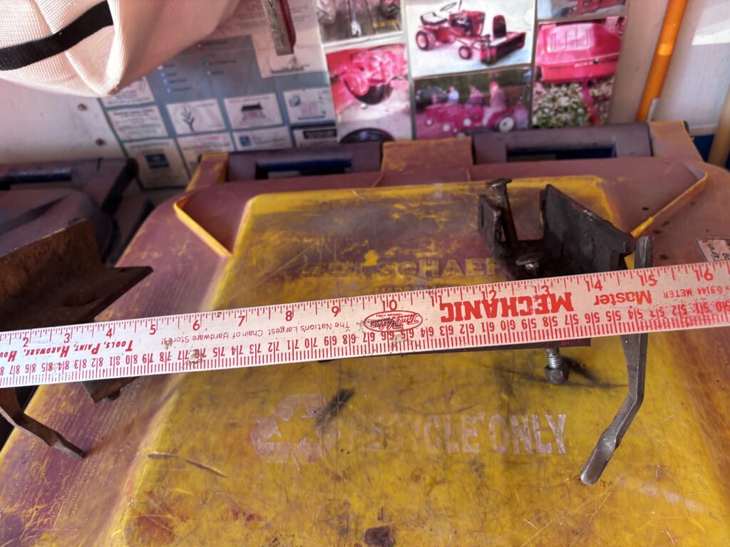

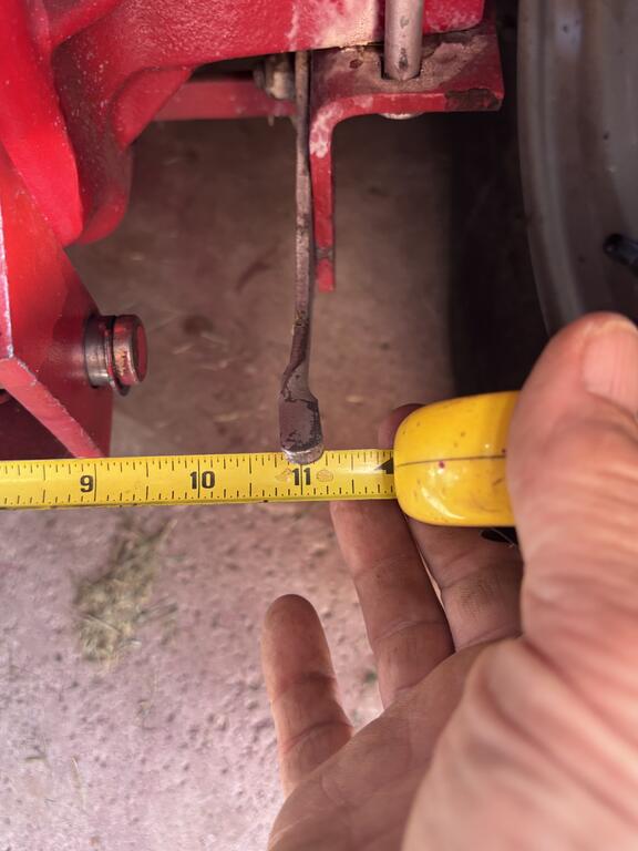

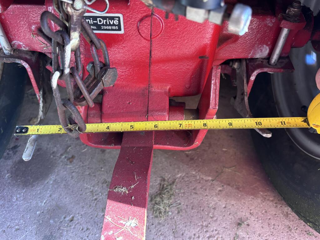

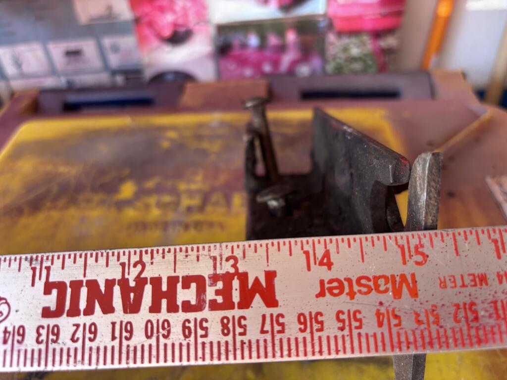

Lane Ranger 12,133 #4 Posted September 7 (edited) Jim : I think the older rear axle bracket was made for a short frame snowplow and it has a wider rod on the snowplow (or locks on the outside portions of the rod on the snowplow). You need the newer version of a rear axle bracket that has a more narrower length on the lock in clamps. Anyway that is my understanding but I sold my version of your mid grader blade and just have the early version now for my round hood tractors. The rear axle hitch you have is 15 1/2 inches wide on the install locks. The newer Wheel Horse/Toro version is 11 inches wide. The old style mid grader blade rear 3/4 rod attached to plates on the side of the frame of a Wheel Horse. Your version, the much stronger , wider and better operating Mid Grader blade attached to the rear hitch but with a more narrow set of locking arms! The last three pics are of the old style rear axle hitch (this. one for a HY hydraulic lift cylinder installation). Edited September 7 by Lane Ranger 4 2 1 Share this post Link to post Share on other sites
WHX?? 58,302 #5 Posted September 7 37 minutes ago, ri702bill said: "pull" style required no axle bracket - it mounted to the mid Tach-a-matic frame Yep well versed in those ... I think I have one of those "short" brackets on a winter 520 that was used for a tiller. Maybe that one will work? Will have to look when she comes out of storage for snow duty. 2 5 Share this post Link to post Share on other sites

WHX?? 58,302 #11 Posted September 8 8 hours ago, squonk said: Robbing parts off of Dan's tractors when he aint lookin! I gave him the tractor 'cause I already have a 856 so what comes around goes around. Thanks Ed Dog ... I took a peek at the one on a 520 and all I could see is it did bolt from the top so I think it's the one. She is strictly a snow machine now the way she is decked out put I did till with it at one time. 4 2 Share this post Link to post Share on other sites
