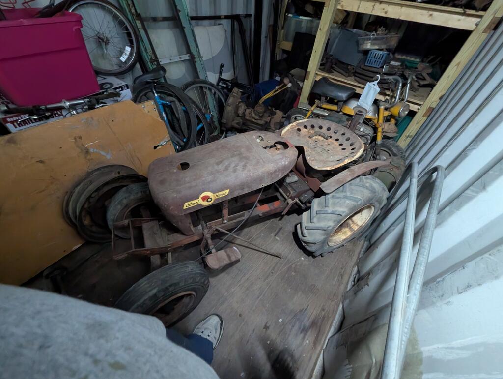

Just joining finally time to work on the $40 Suburban 551

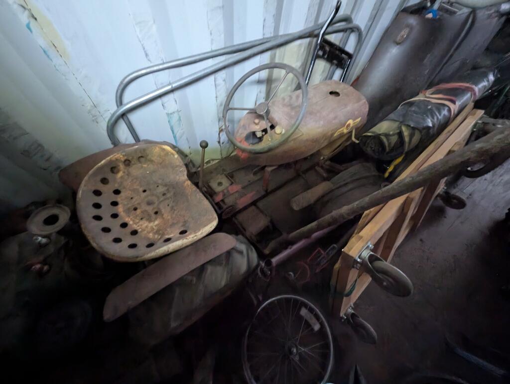

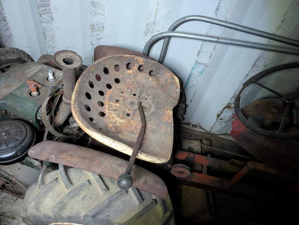

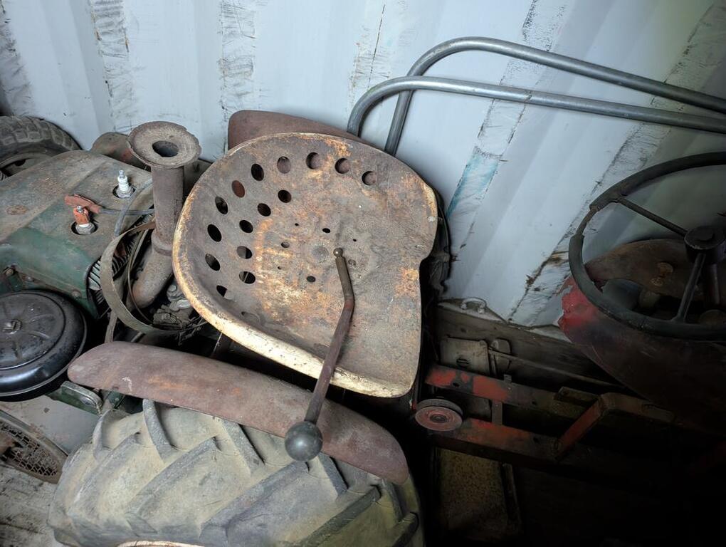

Dug around in the container again today to see what's in there.
A few better pictures:
Can't find the gear on the end of the steering shaft, but it's in there somewhere.

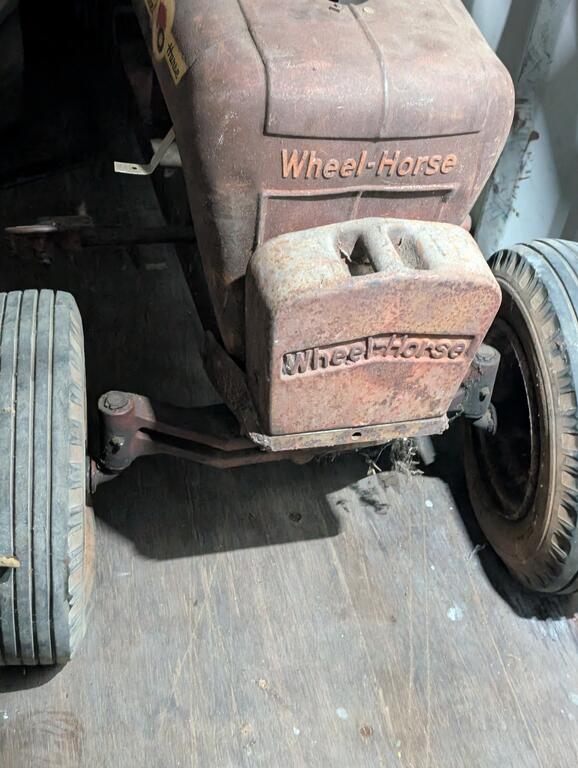

Front Tombstone Weight
Dave

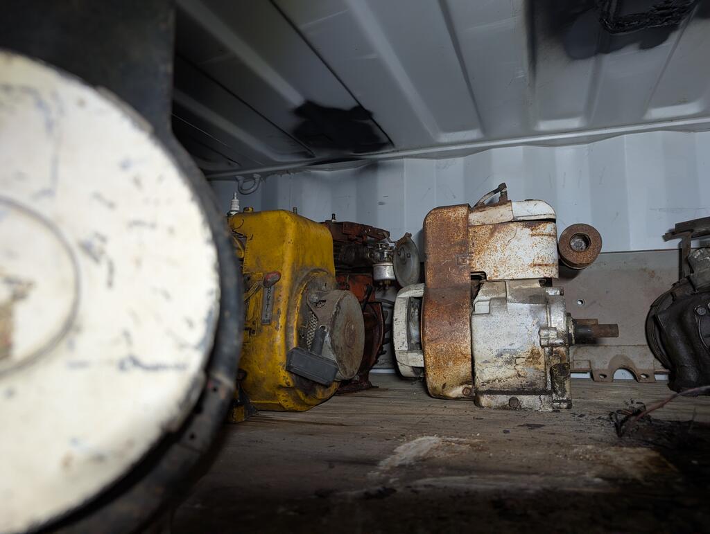

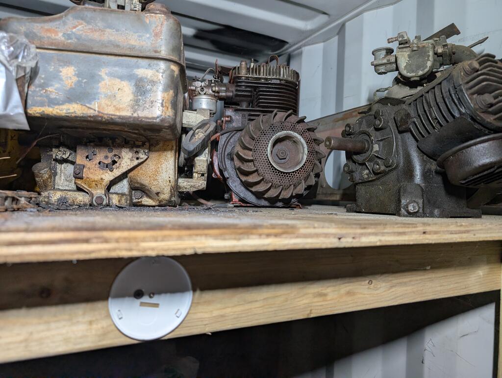

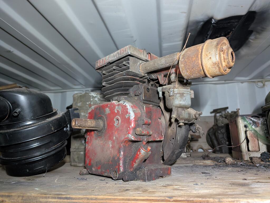

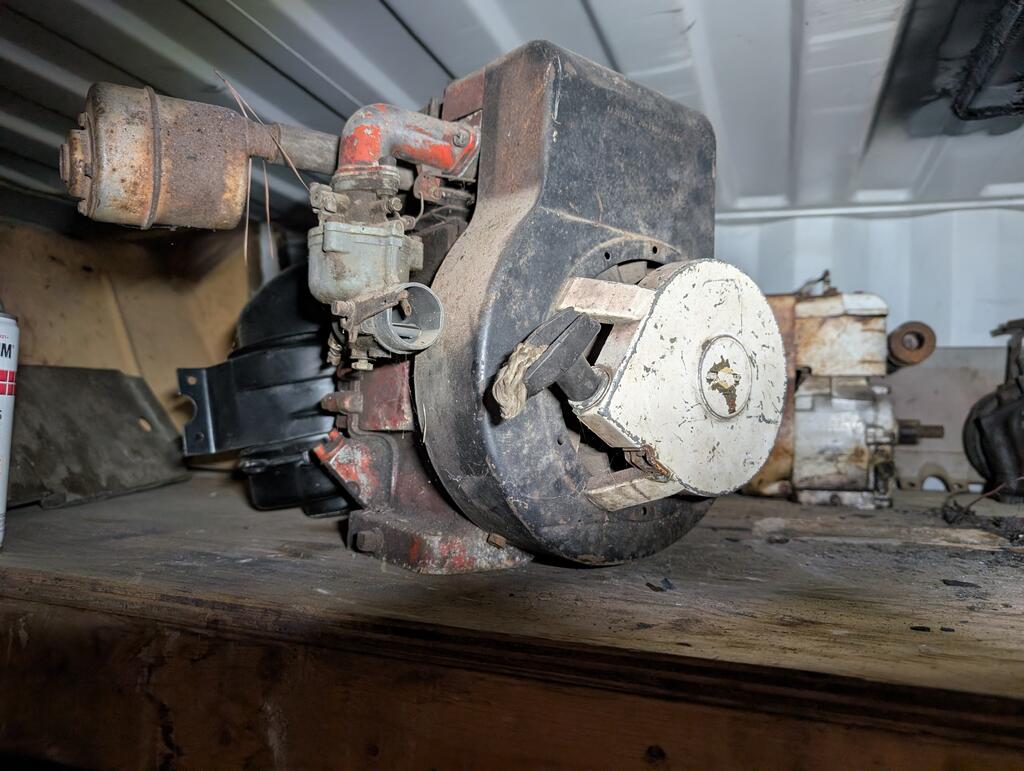

Spending some time looking through those links. Great information. I found the number for the clutch spring and shift boots. The shifter just comes out, there is no shift collar. Could it have fallen into the trans? I need to get one of those collars. Looks like part number 3514. I also found some engines in the old barn. Hoping someone can identify these. One might be useable for this project.
Looks to be a Briggs.
Not sure what this one is no cover.
 Looks a little small.

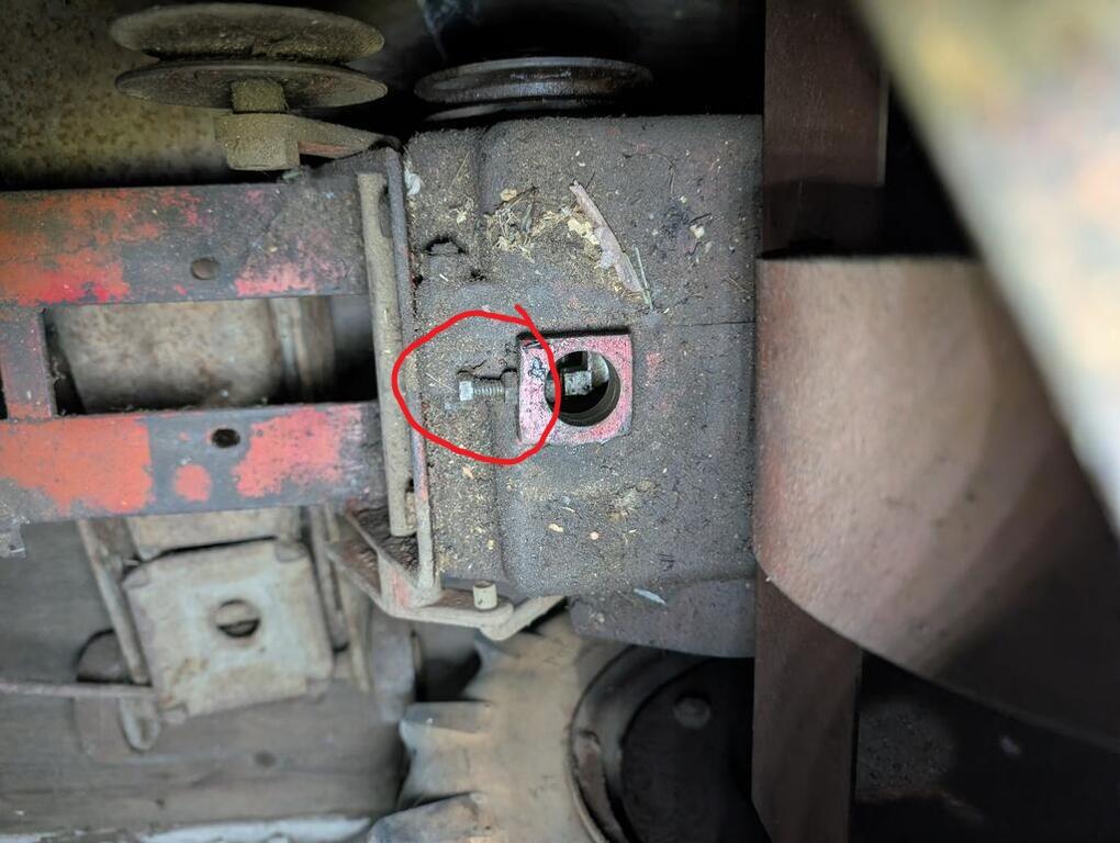

There should be a ball on the end of the shifter. It may be pinned on the shifter or welded. The  shifter is then held in place by a dog point set screw in your pic circled. It threads into a hole in the ball to hold it in the proper position. I suppose the shift ball could have come off if pined and fell into the tranny but unlikely. Get us a pic of the dog point tip and business end of the shifter.
I have no idea what the motor to the right of the shroudless one is but it's cool and would be my choice.

Here is the shifter: locking collar is missing.

Some of those old engines I've saved are 1 1/2 hp Briggs washing machine engines. I'll do some more figuring.

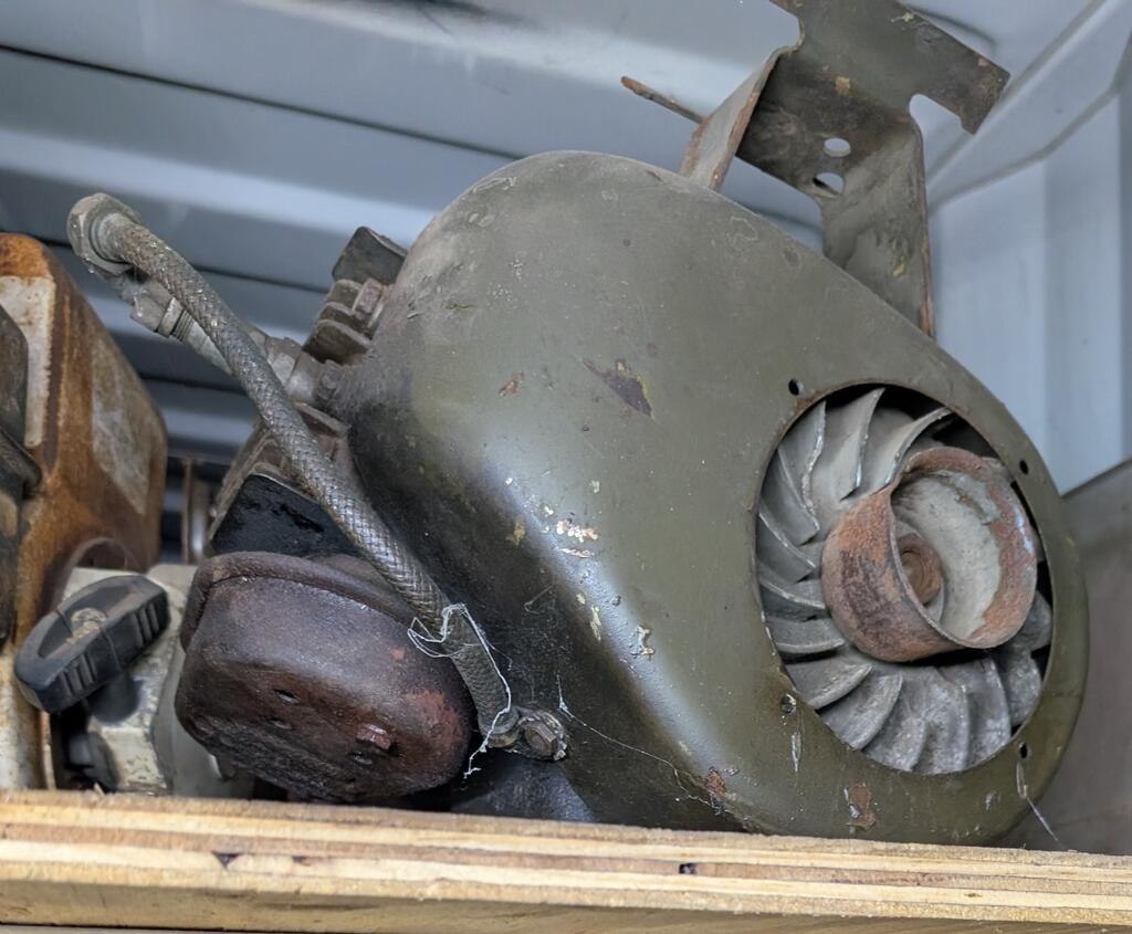

Anybody know what engine this would be in the barn? It's military with the sealed spark plug.

Handy Don
Lets see the other side, please?
The military used/uses a lot of small engines for pumps, generators, winches, and portable hydraulics.
  • Like 1
Dave D.
Picture of the other side of the military single cylinder engine.
This is it from the back.
Thanks for responding.
Dave

A lot of those little single cylinder military engines were rated at only 1.5 HP. I've been told several times over the years that they were more powerful.

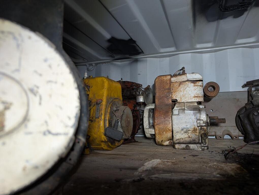

Milspec stuff is usually over built. This one won't turn by hand, so probably needs a lot of work. The yellow Tecumseh engine is complete, might be a little small and one red engine missing the flywheel cover.

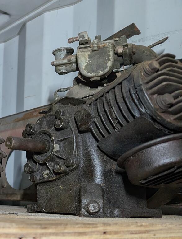

Dave D.
No cover on this engine. Do you think it's a Briggs or a Techumseh?
All identifying numbers would have been on the shroud.
Can anyone tell what it might be?
Dave
wallfish
Just guessing, Briggs.
That shaft appears to be too high up for a Teccy and also, not many updraft carbs on them. The updraft carb on a Teccy would be a Tolliston carb.
  • Like 4
953 nut
Those plastic oil fill caps tell me B&S,
  • Like 2
Dave D.
Sounds like it's a Briggs.
I was hoping it was a more appropriate engine for this project.
Since it's missing the cover, I'll keep on looking for a suitable engine.

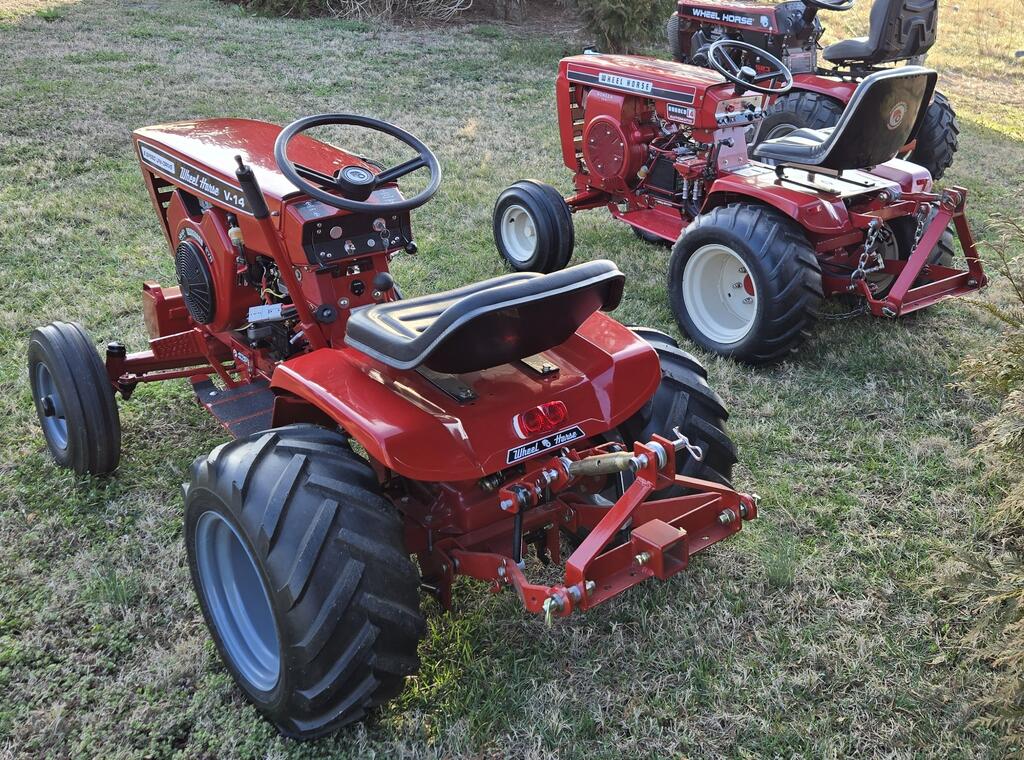

kpinnc
On 8/30/2026 at 7:03 AM, Dave D. said:
Haven't seen many Wheel Horse tractors around here in NC.
There are more than you'd think. Not as many as 20 years ago, but they are still around.
I live about 30 miles NE of Charlotte. There used to be a few members around Fuquay and the Raleigh area. I haven't kept up but I know there are a few still in your area.
  • Like 2

Dave D.
Very Cool! Those are some cool pictures. Keep me informed of any shows or get togethers in NC. I've got to get out and see some of these little machines in person.
