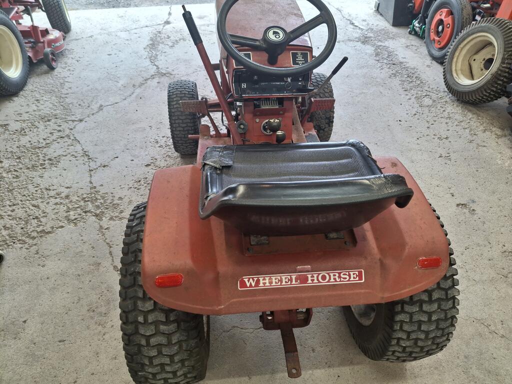

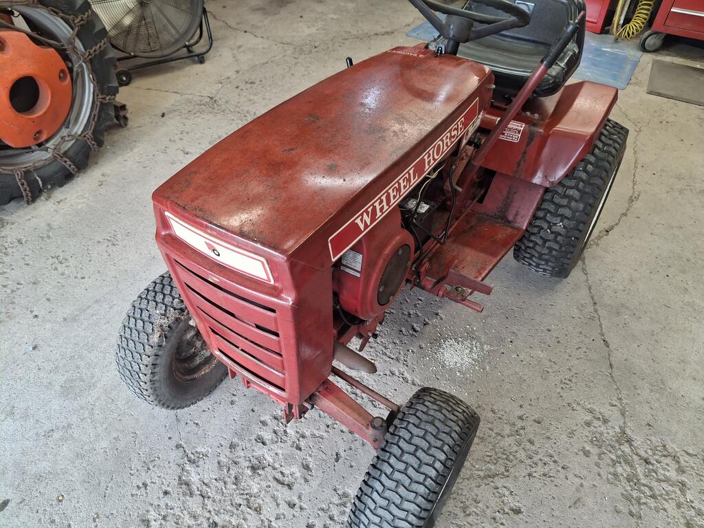

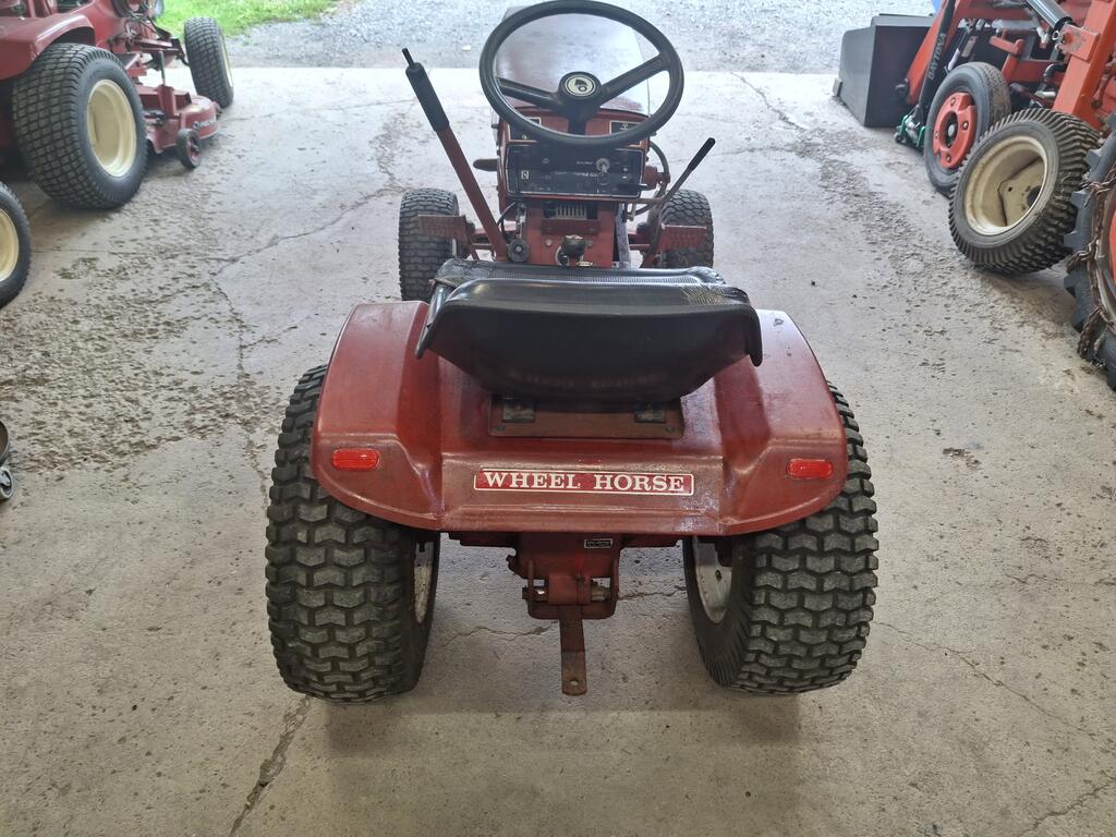

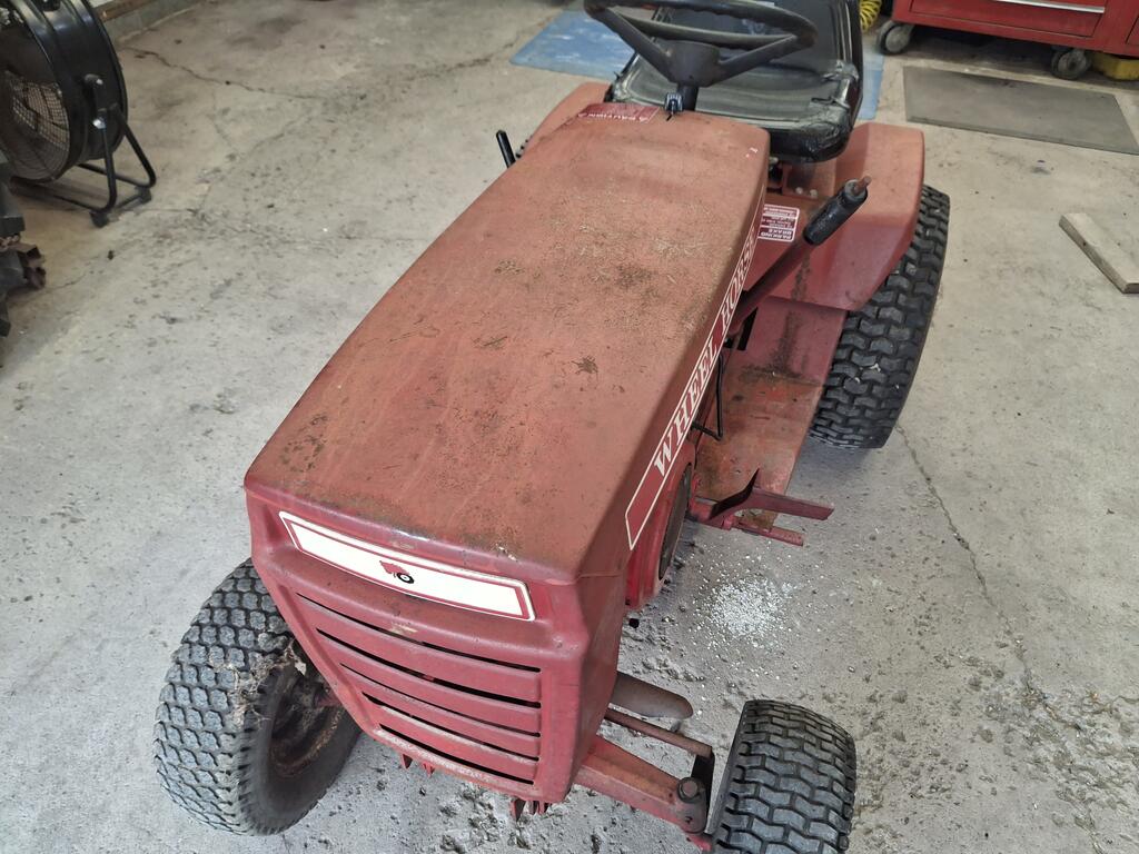

squonk 48,119 #1 Posted August 25 I've always wanted to show a before and after comparison with Penetrol. So I gave Dusty the B-80 the business. Before: After: 4 16 Share this post Link to post Share on other sites
ebinmaine 80,694 #2 Posted August 25 Rag or something more aggressive? Share this post Link to post Share on other sites
squonk 48,119 #3 Posted August 25 40 minutes ago, ebinmaine said: Rag or something more aggressive? foam brush 2 1 Share this post Link to post Share on other sites
EB-80/8inPA 2,116 #4 Posted August 26 I did the hood of the B-80 a couple weeks ago just to see how it would go. Smeared it in evenly with a rag, let it set a while and rubbed off the excess. It’s not as shiny looking as yours looks in the pics, but made a huge improvement Now I gotta do a complete cleaning and treatment. It’s good stuff! No more dust catching oilings for me. 3 Share this post Link to post Share on other sites
ineedanother 2,864 #5 Posted August 26 I use it and it stays tacky for a couple days but dries completely and seems to last. I've been tempted to wax over it to see what that does but haven't yet. 2 Share this post Link to post Share on other sites

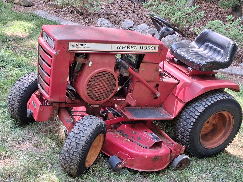

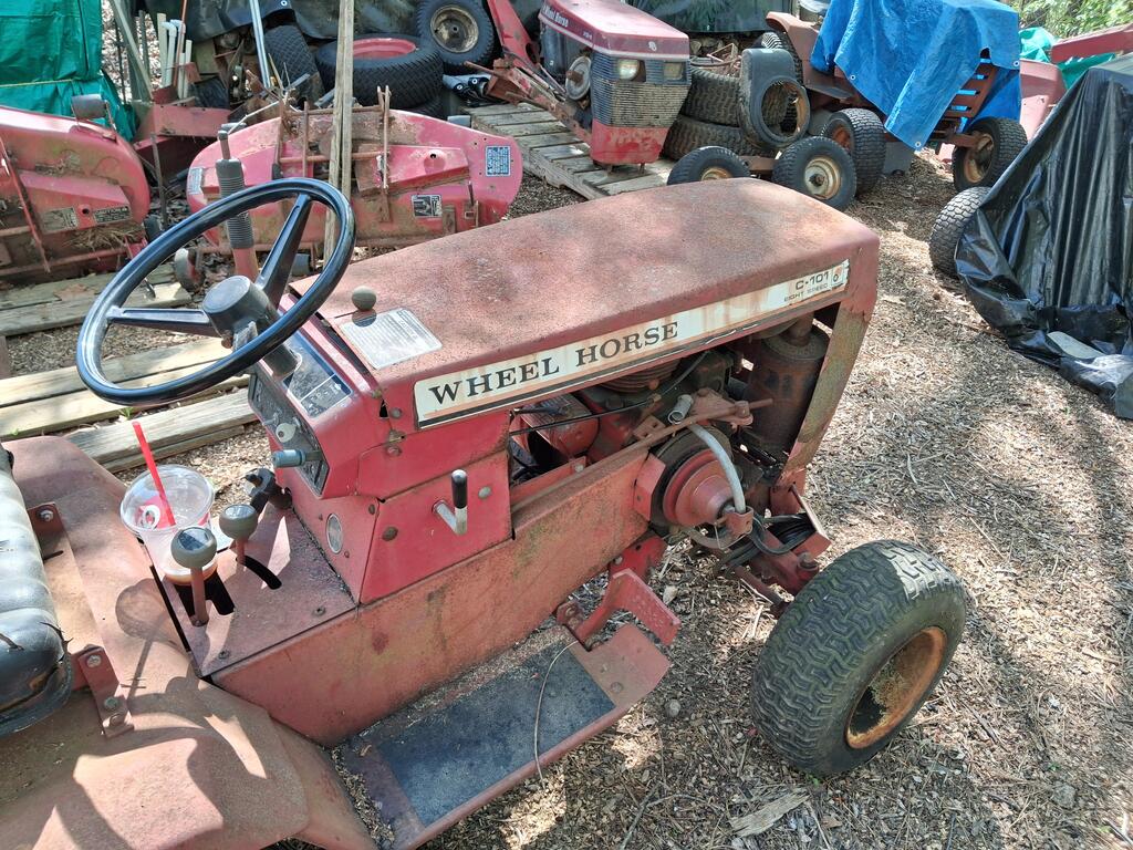

John c 223 #6 Posted August 27 I used penetrol on a C101 I did a few months ago, I was very impressed with the result. What was left of the original paint was to the point it was turning loose in little chips, so I ended up using steel wool to apply the penetrol and smooth it out some, it was pretty messy 3 3 Share this post Link to post Share on other sites
ineedanother 2,864 #7 Posted August 27 I use these routinely and recommend them... 2 1 Share this post Link to post Share on other sites
Beap52 2,497 #8 Posted August 27 I've used pump up sprayer to apply Penetrol to my pickups for several years. I spray it in places such as inner fenders, inside doors, door rockers, frame most anywhere I can get it. and I'm quite pleased with the results in protection from rust. I don't apply it to the paint What it does to the tractor finishes pictured is amazing. 2 Share this post Link to post Share on other sites
