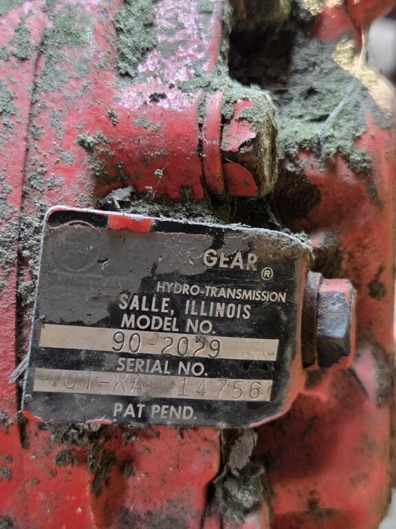

McTurff 11 #1 Posted August 23 I posted a while back on the Jacobsen 1200 super chief I acquired and received some useful items Thanks Can't find where to place my inquiry so hope this is OK this is the only forum that I can seek some useful information! I got the back end off the ground and the wheels will turn but only in opposite directions! I can move the shifter to neutral and forward and back but cannot turn the control arm that is supposed to actually let the wheels come out of gear I guess they should move together as a locked diffential?? I removed the drain plug to look at fluid and it looks surprisingly good and no metal on the plug I think they are magnetic? Also there was no metal in the fluid that came out i did not drain all the fluid was just doing some investigative work! Anyway before I start removing axle and Transmission to go deeper and possibly open it up was just looking for any other tests I can try or look for! Share this post Link to post Share on other sites
953 nut 70,648 #2 Posted August 24 Here is a link to all of the Sundstrand manuals on this site, hope it helps you. https://www.wheelhorseforum.com/search/?q=sundstrand&quick=1&type=downloads_file&nodes=24 1 Share this post Link to post Share on other sites
Bar Nuthin 3,642 #3 Posted August 24 12 hours ago, McTurff said: I got the back end off the ground and the wheels will turn but only in opposite directions! That's normal - as it should be 12 hours ago, McTurff said: I can move the shifter to neutral and forward and back but cannot turn the control arm that is supposed to actually let the wheels come out of gear A hydro transmission would have motion control, not a shifter. There is no neutral, only "stop". Somewhere on the transmission should be a " tow valve" that can be opened to allow the tractor to be free-wheeled (pushed/towed) 2 Share this post Link to post Share on other sites
McTurff 11 #4 Posted August 24 (edited) 1 hour ago, Bar Nuthin said: That's normal - as it should be A hydro transmission would have motion control, not a shifter. There is no neutral, only "stop". Somewhere on the transmission should be a " tow valve" that can be opened to allow the tractor to be free-wheeled (pushed/towed) Yes that lever moves back and forth fine forward neutral reverse! The tow valve or control valve which allows the transmission to go into neutral and be pushed is stuck or froze up! I did find a discussion searching different forums that others have experienced the same problem from a machine that has been sitting outside for years! They were able to spray some pb blaster or other to break the control shaft loose! They were all stuck pretty good! Hoping I get that lucky 🙏 Thanks! Edited August 24 by McTurff 1 Share this post Link to post Share on other sites

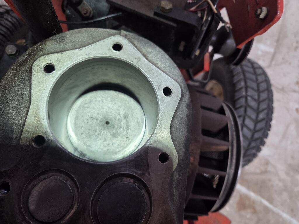

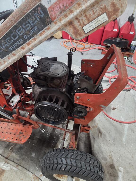

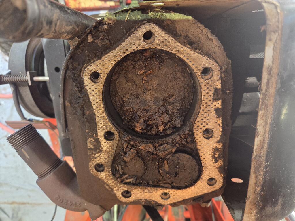

McTurff 11 #17 Posted August 28 (edited) I guess i will keep posting my progress even though this is a Jacobsen it still contains similar components! Now im onto the Kohler K301 had to do a lot of clean up grease oil crud ect!! Now into the motor! Will change fluids on hydro when I know this machine is running@ Pulled the head and man I thought what a disaster but that's what you get pulling a tractor that's been sitting for who knows how long in a field!! Got it cleaned up and it looks pretty good over all will do a flush and valve job and then see if it runs then go from there! Here are some pics of progress! Edited August 28 by McTurff 3 1 Share this post Link to post Share on other sites

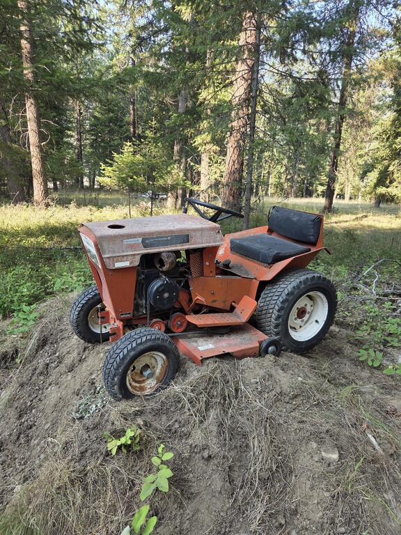

McTurff 11 #18 Posted September 6 (edited) https://youtube.com/shorts/ftbXNsTVIJs?is=yxsi0EnviLkc SHE RUNS!!! started right up first try and it drives transmission is good! Can't believe it! Check out video Also pic below from add when I first saw it paid $30 saved it from mower graveyard and would have been scrap in 2 months according to PO Thanks for everyone's help! Edited September 6 by McTurff 2 Share this post Link to post Share on other sites
