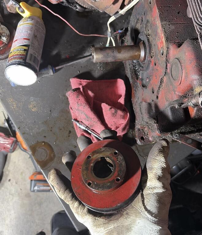

Krice58 165 #1 Posted 4 hours ago I’m sure this is on here somewhere just hoping for some tips. Trying to remove crankshaft pulley off a K341, took out the set screws and it won’t budge. What are we using to remove these? Jaw pullers? Gear pullers? PB Blaster and prayers? Also anyone have any suggestions for machine shops in the NE Ohio, W PA area, or would any old machine shop that does small block chevys and fords be able to do a k series? Like to have this block honed, maybe bored, valve seats maybe and the crank looked at. Thanks in advance! Share this post Link to post Share on other sites
wallfish 20,359 #2 Posted 3 hours ago Spray spray spray remove the set screw and spray into that hole. The pulleys are cast so they will break if you just start off with a puller and crank. This may seem counterintuitive but knock it in towards the block. The idea is to get it to move which breaks that rust bond. Then try a puller BUT you need to get it to move back and forth a little bit at a time before pulling it all the way off the shaft. Yes tedious, but knock in, pull out, knock in, pull out and repeat. It should move more distance on the shaft each time and get more oil in there each time. Try to spin it if you can as that will get more oil in there too. Clean the shaft off of any rust before beginning which will make it easier once it moves far enough out. That's my 3 Share this post Link to post Share on other sites
ineedanother 2,696 #3 Posted 3 hours ago Penetrating oil. Give it some time, it shouldn't take too much. I've "lightly" tapped them in with a section of pipe over the shaft but put a flat pry bar behind first to retain that space between the pulley and block. It can tolerate light shocks to break the brown weld if there is any. 1 Share this post Link to post Share on other sites
Krice58 165 #4 Posted 1 hour ago Finally let loose. Share this post Link to post Share on other sites
