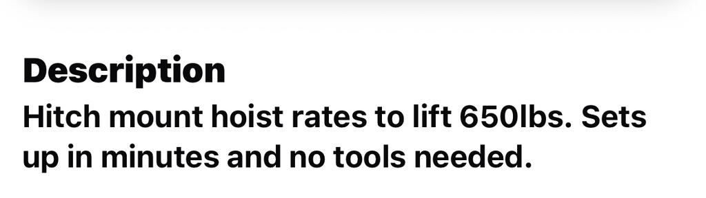

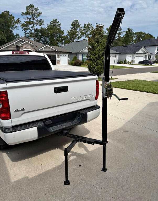

FLtractor 253 #1 Posted August 20 Evening, Came across this marketplace… seller asking $165.00. Would this work with an 856 if hitch? Anyone use one? Would it be safe to lift something and not top tractor stationary? Driving? current rear tires are fluid filled so much more weight. Place to change to new no fluid tires. Share this post Link to post Share on other sites
ri702bill 13,366 #2 Posted August 20 That is for a 2" square receiver hitch. Not meant for a WH slot hitch... Share this post Link to post Share on other sites
953 nut 70,584 #3 Posted August 20 @SylvanLakeWH has one. Share this post Link to post Share on other sites
Chaz54 102 #4 Posted August 20 Do a search online and you’ll find that’s about the same price as a new one. Share this post Link to post Share on other sites

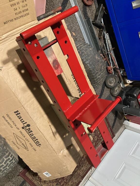

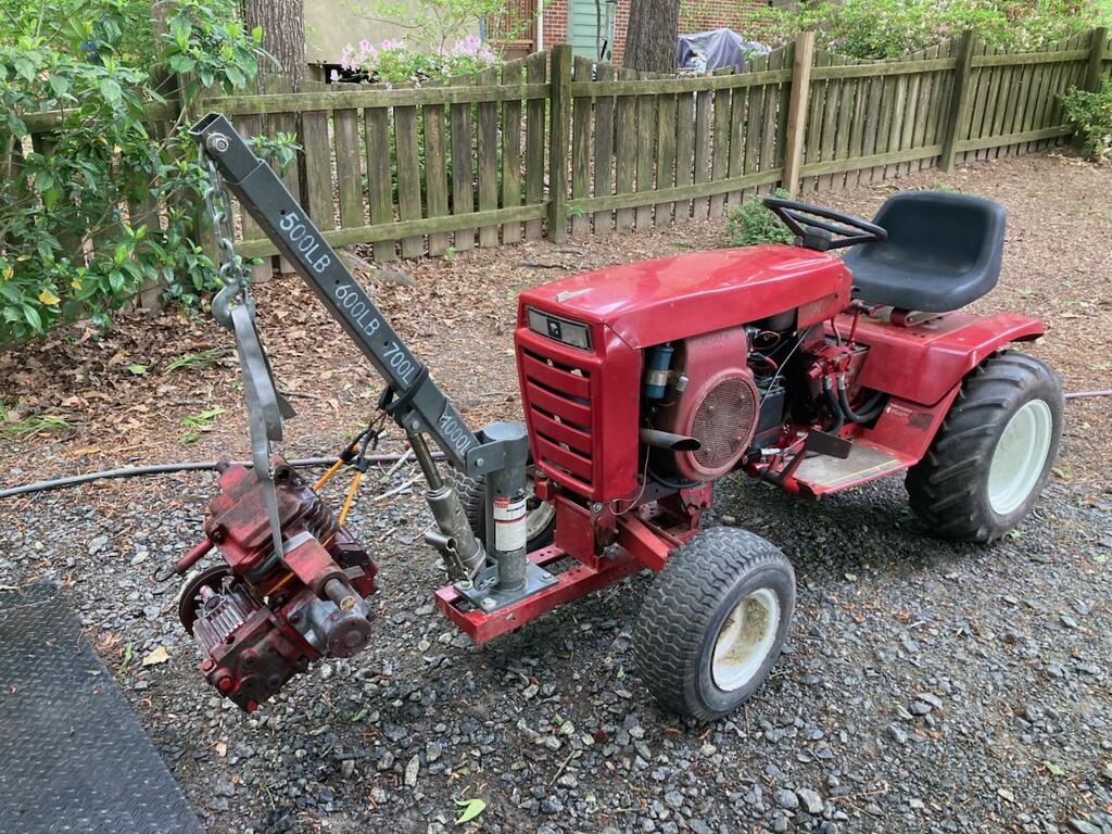

Lee1977 7,813 #5 Posted August 20 My harbor freight boom on my Raider 12 the weight limit to keep the front wheels down is less the 200 lbs. I can move a 42" deck or a big block single cylinder Kohler. I have used it to move brush by just lifting the one end a draging. Makes it easy to drag a long way to a good burning spot. 1 1 Share this post Link to post Share on other sites

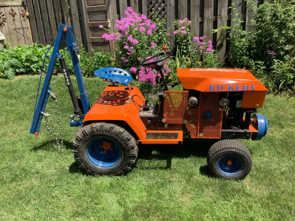

SylvanLakeWH 32,904 #6 Posted August 20 5 hours ago, 953 nut said: @SylvanLakeWH has one. Here's the link... It evolved... now on a winch plate of one of Lowell's 2" hitches... works like a charm... Share this post Link to post Share on other sites
davem1111 2,453 #7 Posted August 20 7 hours ago, Lee1977 said: My harbor freight boom on my Raider 12 the weight limit to keep the front wheels down is less the 200 lbs. I can move a 42" deck or a big block single cylinder Kohler. I have used it to move brush by just lifting the one end a draging. Makes it easy to drag a long way to a good burning spot. Love those tires, and I might need to get one of these booms myself.... Share this post Link to post Share on other sites

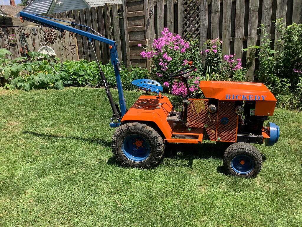

CRF857 1,496 #8 Posted August 20 (edited) Not a wheel horse. But I used an electric actuator from a mobility cart carrier. Put it on the back of a repurposed Roper. Rated at 400 lbs. Never be ale to pick up that much without tipping over. I did use this to pull the post while removing a split rail fence. The easy ones I could get in a single pull at the far end. The harder ones required two-three pulls from the near end, or the front of the tractor would raise up. Since then I have hardly used it. Edited August 20 by CRF857 2 2 Share this post Link to post Share on other sites

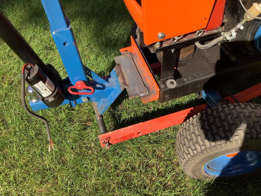

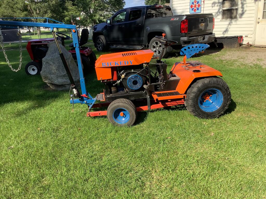

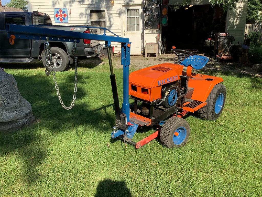

ineedanother 2,885 #9 Posted August 20 I chose a front-mounted winch. Personal preference of mine and pretty simple construction with a section of an old frame. Weight in the rear can be an issue but this attaches just about as quickly and doesn't stress the frame at the uni-drive bracket. 2 4 1 Share this post Link to post Share on other sites
c-series don 12,738 #10 Posted August 21 @ineedanother with just the pipe sticking up it looks like it could double for a flagpole holder! A nice size pipe could go pretty high in air with that setup to fly Ole Glory Share this post Link to post Share on other sites
ineedanother 2,885 #11 Posted August 21 9 minutes ago, c-series don said: @ineedanother with just the pipe sticking up it looks like it could double for a flagpole holder! A nice size pipe could go pretty high in air with that setup to fly Ole Glory I like the way you think I might need to take some measurements 1 Share this post Link to post Share on other sites
CRF857 1,496 #12 Posted August 21 1 hour ago, ineedanother said: I chose a front-mounted winch. Personal preference of mine and pretty simple construction with a section of an old frame. Weight in the rear can be an issue but this attaches just about as quickly and doesn't stress the frame at the uni-drive bracket. Now I am rethinking my set up. Share this post Link to post Share on other sites

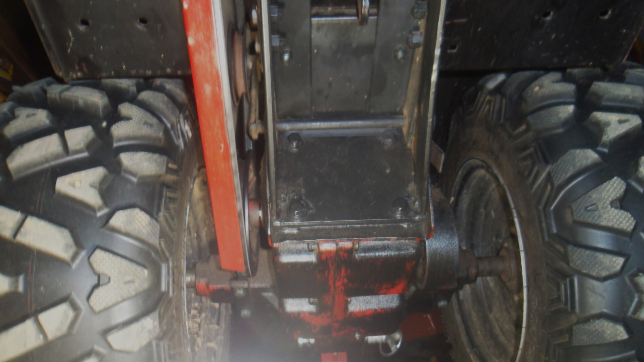

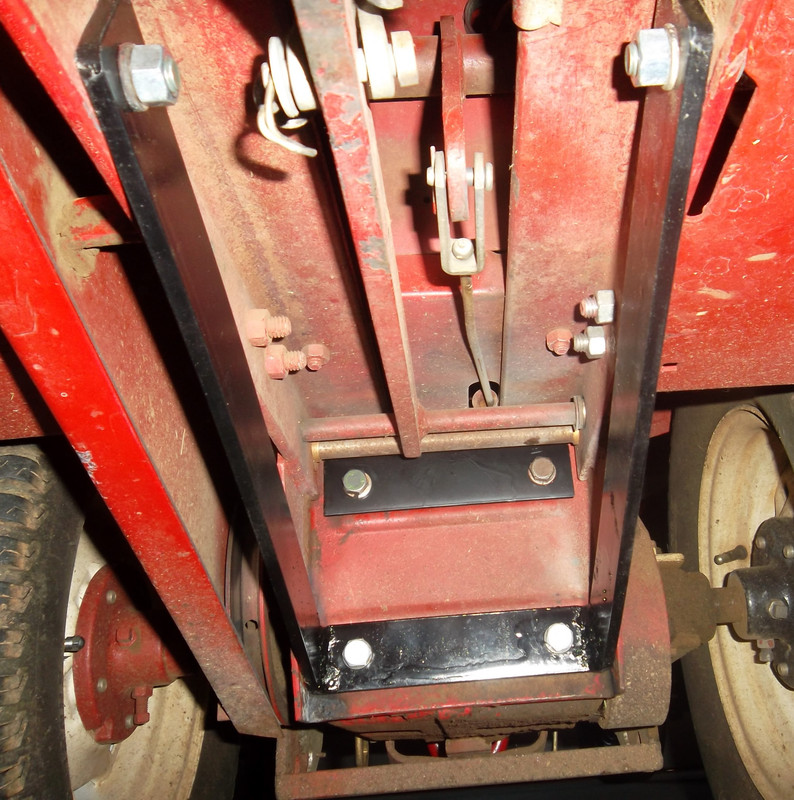

Lee1977 7,813 #13 Posted August 21 (edited) On 8/20/2026 at 7:26 PM, ineedanother said: I chose a front-mounted winch. Personal preference of mine and pretty simple construction with a section of an old frame. Weight in the rear can be an issue but this attaches just about as quickly and doesn't stress the frame at the uni-drive bracket. I have a front receiver but never mounted the boom on the front. I also have the frame braced at the transmission mount transmission. This tractor hasa similar brace, Don't have a picture of the Raider, it has a solid plate with the braces up to the frame. Here is the Raider 12 transmission brace, Edited August 22 by Lee1977 5 Share this post Link to post Share on other sites

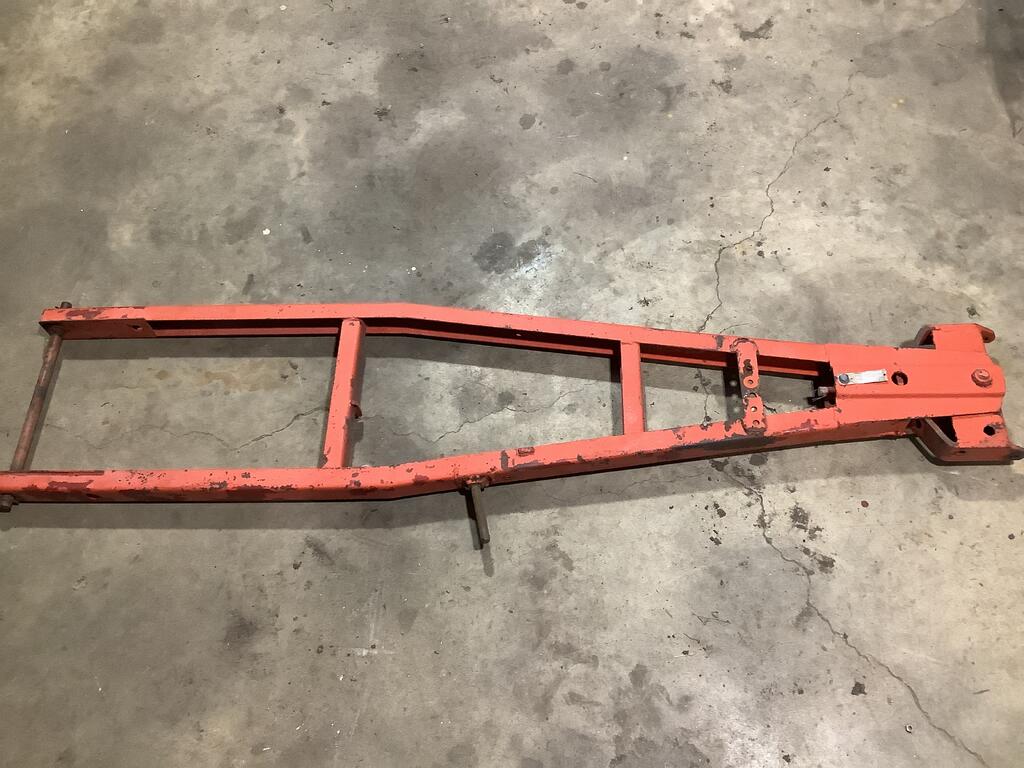

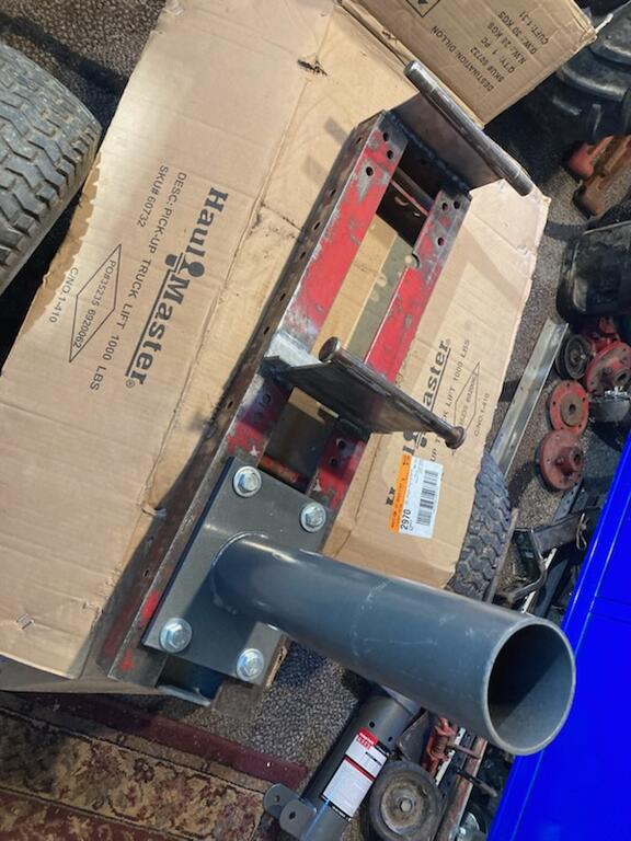

CRF857 1,496 #18 Posted August 22 (edited) On 8/20/2026 at 6:26 PM, ineedanother said: I chose a front-mounted winch. Personal preference of mine and pretty simple construction with a section of an old frame. Weight in the rear can be an issue but this attaches just about as quickly and doesn't stress the frame at the uni-drive bracket. Couldn’t stand it. Went to the shop today and moved my boom to the front. Will rewire it and try it out tomorrow. If happy with it I will disassemble and paint it. Started with a discarded frame for a snow plow. Attached at the rear, middle and front. Remove four bolts and a shaft, and the front comes off. Remove four more bolts and the frame work comes off. Edited August 22 by CRF857 1 Share this post Link to post Share on other sites
ineedanother 2,885 #19 Posted August 22 12 minutes ago, CRF857 said: Couldn’t stand it. Went to the shop today and moved my boom to the front. Will rewire it and try it out tomorrow. If happy with it I will disassemble and paint it. Started with a discarded frame for a snow plow. Attached at the rear, middle and front. Remove four bolts and a shaft, and the front comes off. Remove four more bolts and the frame work comes off. Dozer blade frame was going to be my first choice but I didn't have a spare. I think what you've got will handle considerably more weight 1 Share this post Link to post Share on other sites
