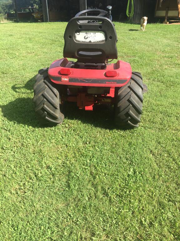

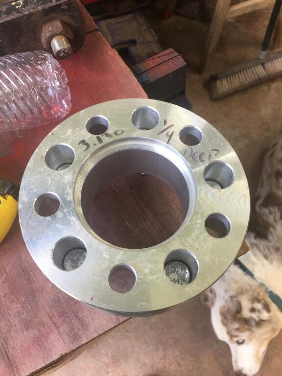

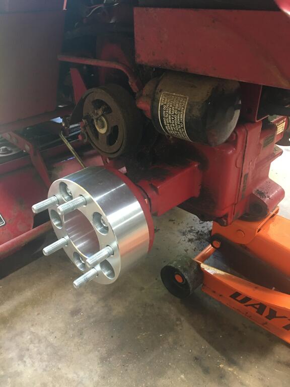

Installed a set of 2” wheel spacers on the other 520h today. I dont know what these rims/tires came off of but they had a lot more back space than Wheel Horse rims. Had to cut a counter bore on lathe to fit the WH hub but turned out pretty good. The way it was set up before the rear end was a lot narrower than the front and looked plumb goofy. It actually was rubbing on the right hand side. The tires or BKT’s and they are a tall 10.50 and I think I like them.

c-series don
Even the dog appears to like the looks of it!
Yeah, he's a lot of help.:rolleyes:

ebinmaine
New candidate for Wide Rear Wednesday
