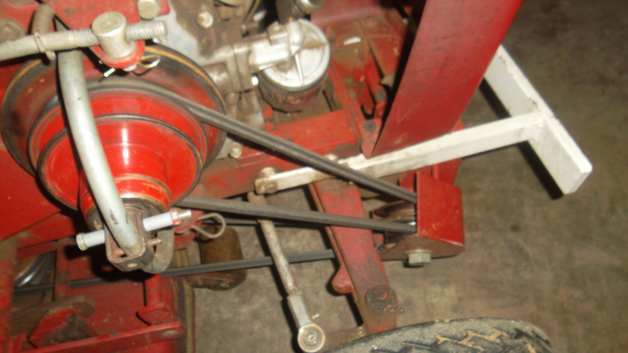

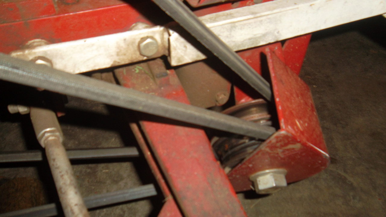

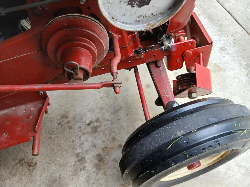

Simplecity 27 #1 Posted August 14 (edited) Good Afternoon All Installed a Mule Drive on my Raider 12. For some reason, it just doesn't look right. The belt from the motor APPEARS like it will chafe on the front axle. I do not have belts or a deck (looking for a 42" rear discharge), I'm open for recommendations for both. Here are some pics. Edited August 14 by Simplecity 1 Share this post Link to post Share on other sites

ri702bill 13,187 #4 Posted August 14 It is a close fit on the C series to miss the axle... 1 Share this post Link to post Share on other sites
sqrlgtr 4,091 #5 Posted August 15 its a Raider but close enough to a C series @ri702bill 4 hours ago, Simplecity said: Here are some pics. How you like them tri rib Firestone front tires? Share this post Link to post Share on other sites

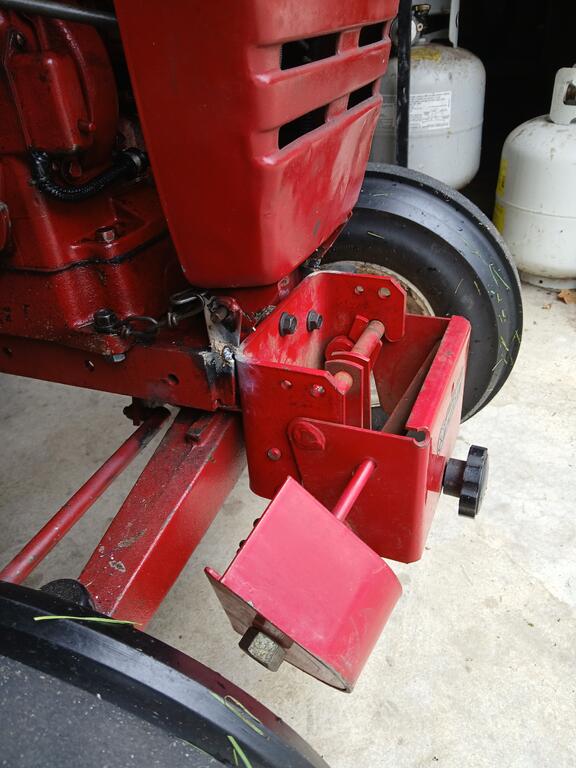

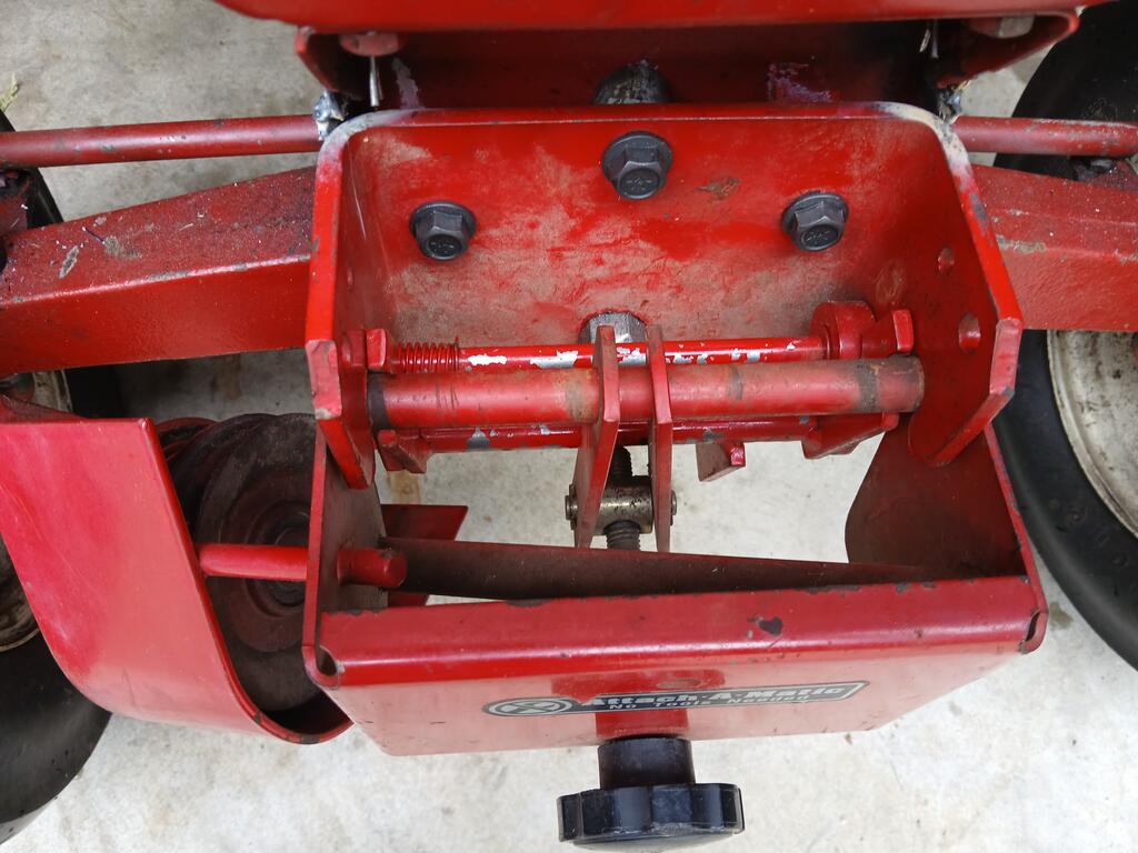

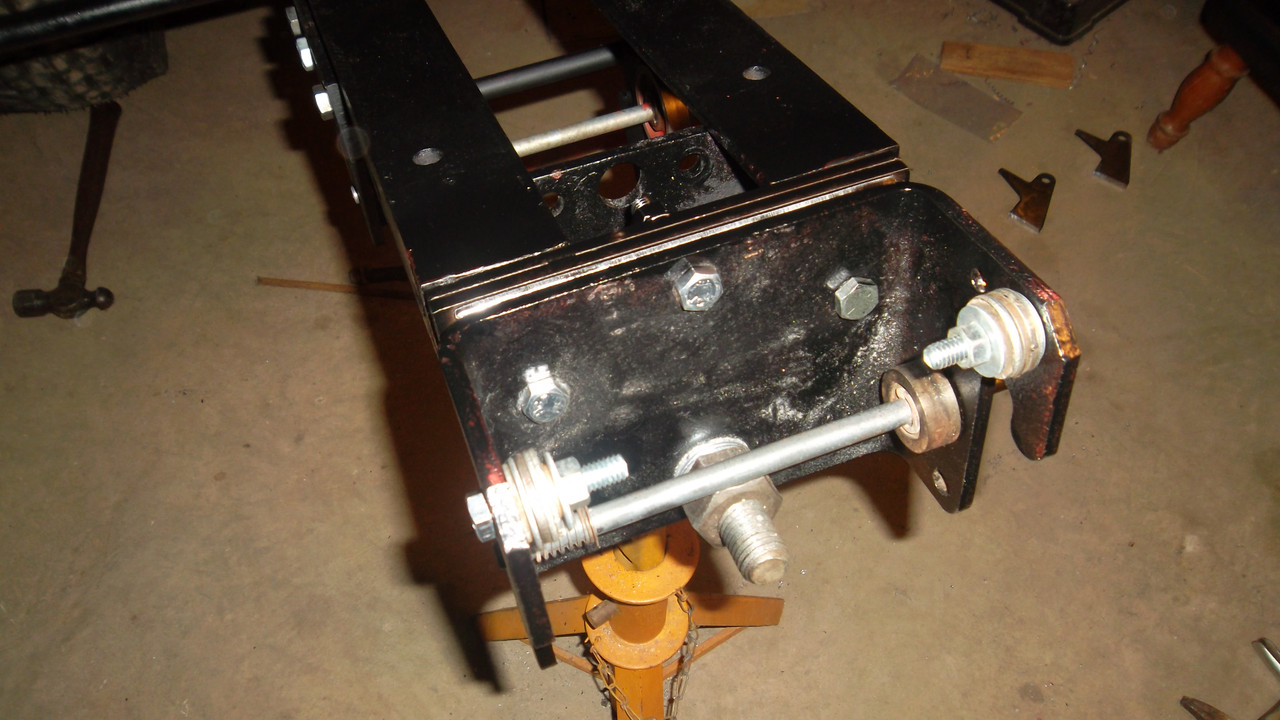

Lee1977 7,804 #6 Posted August 15 (edited) Here is the one I bolted on to my 71 raider 12 it works find. I used two 1/4" flats and one 1/8" flat as spacers between the frame and hitch. I had to cut off the hood hinges and bolt them back to the hitch. Edited August 15 by Lee1977 1 Share this post Link to post Share on other sites
Simplecity 27 #7 Posted August 15 10 hours ago, Lee1977 said: Here is the one I bolted on to my 71 raider 12 it works find. I used two 1/4" flats and one 1/8" flat as spacers between the frame and hitch. I had to cut off the hood hinges and bolt them back to the hitch. 16 hours ago, ri702bill said: It is a close fit on the C series to miss the axle... Lee 1977 Mine is mounted flush at the axle pin which resulted in approx 1/2" to "space" at the three bolts. Used the original hood mount location. Couple of questions: 1) Are there different mule drives that were used on different models? 2) What size belt do you use from the motor to the drive? 3) Do you have a pic of the belt were it crosses the axle? Just a thought: My Raider is powered by a 12 hp Kohler, Can't tell what yours is. Share this post Link to post Share on other sites

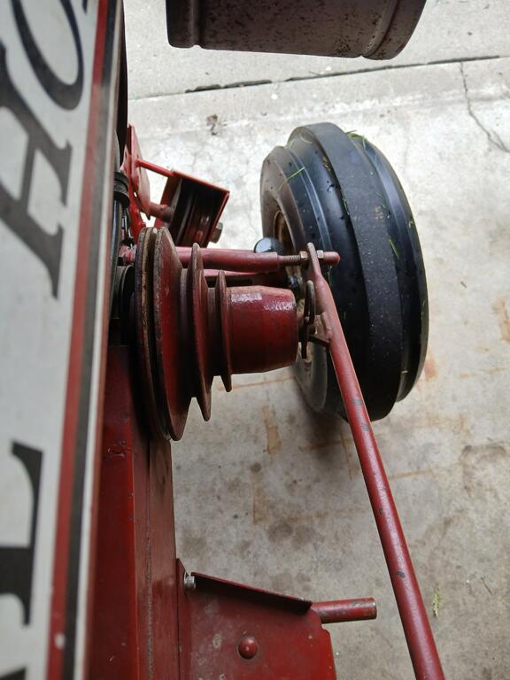

Lee1977 7,804 #8 Posted August 15 (edited) All front on the classic Wheel Horse garden tractors is the same. Started with the no names in 1973. Mule drive size on 42" and 48" side discharge decks is 1/2" x 103". I use the blue belt from Tractor Supply. Other decks may be a different size.Goes down The mule drive belt The mule drive goes down from the PTO to in inside vee idler and comes back up on the back side over the flat idler. It has a 12 HP Kohler. Don't have the mower deck on the Raider. There an inch between the belt coming over the flat idler and the axle. Edited August 15 by Lee1977 Share this post Link to post Share on other sites
Simplecity 27 #9 Posted August 15 Thanks for the pictures, belt size information and the tutorial. I now understand the belt routing. Share this post Link to post Share on other sites
