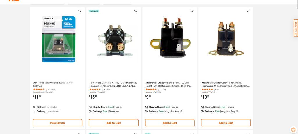

FLtractor 223 #5 Posted August 14 On 8/11/2026 at 9:29 AM, ri702bill said: And that makes it an excellent candidate to add in a solenoid to remove the high amperage load from the poor keyswitch. I did the same on my 854 - easy to do. Do you have a link or picture of exactly what kind and strength of Solenoid i should put between inline? Share this post Link to post Share on other sites
ri702bill 13,050 #6 Posted August 14 You can use either a WH solenoid like the ones on a C series tractor, or a 1970's Ford car version. If it has 3 terminals, it grounds thru the mount. If it has 4, one of the small terminals goes to ground. Either way, mount it where it fits best... Share this post Link to post Share on other sites

pfrederi 21,148 #14 Posted August 15 Or go to Lowes or Home depot and pick up a garden tractor solenoid for less than $15 i have used a couple no issues. 1 Share this post Link to post Share on other sites
