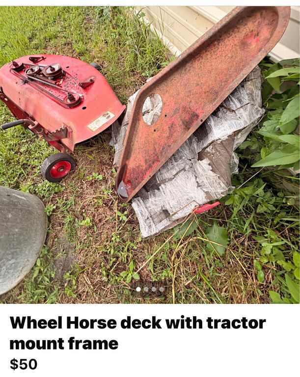

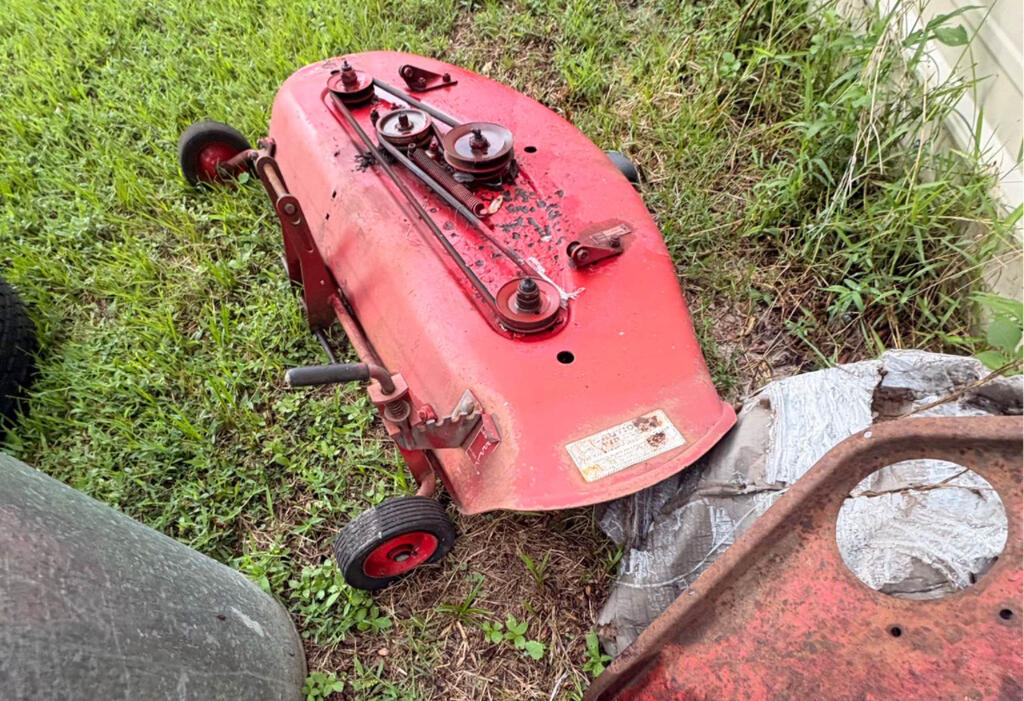

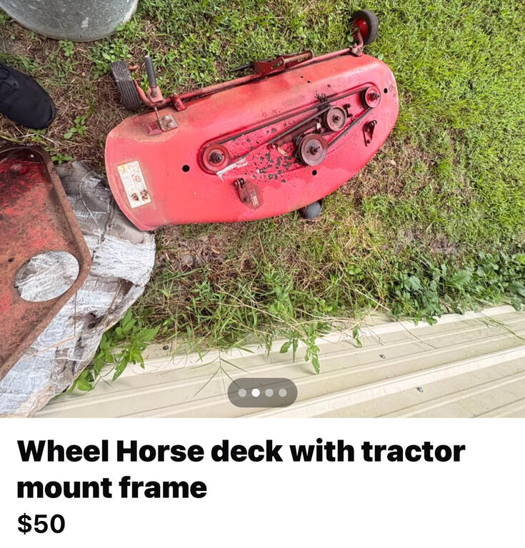

Afternoon,
wondering if this will work with 856. If so, be a lot of work to make it work?
Ed Kennell
If your 856 has the mid mount attach-a-matic and the front mule drive and all the deck hardware is in the box, It should work.
ri702bill
But... The way the 856 left the WH factory, your choices would be either a 32 or 36 " gear drive 2 blade deck. The deck in the picture looks to be a 42" - even a good running 8HP Kohler is prety much maxed out with a 36" deck.... my :twocents-02cents:
