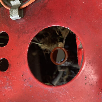

ZTatZAU 8 #1 Posted July 21 Hello everyone! It's been quite awhile since I've posted here. As per my 520H Owner's Manual (Model 73501-3900001+), I drained the transmission oil and removed the filter... then reinstalled drain plug and new filter. The manual says capacity is approximately 5 qts but to start with only 4 qts and then add oil to between L & F marks on dipstick. As I was filling with a funnel, through the dipstick/filler tube one quart at a time, I heard a lot of gurgling and gulping as the oil level in the funnel slowly dropped and flowed into the trans. Bottom line is, I could only add about 3.5 qts of new oil, which is now full to the very top brim of the dipstick/filler tube. I.E. It seems I will need to remove oil to get down to the L&F marks on the dipstick. Somewhat frustrated, at this point, I measured the drained oil and found I had drained only about 3.5 qts out of the trans. I remember reading about raising the front of the tractor to help drain ALL the trans oil, "over the hump", but IIRC this was on a tractor other than a 520H. Does this "raising the front end", in fact, apply to the 520H in order to drain ALL the transmission oil? Any suggestions on how best to proceed at this point, are most welcome! ZT Share this post Link to post Share on other sites

ZTatZAU 8 #7 Posted July 21 6 minutes ago, sqrlgtr said: If you're not in a hurry let set over night /next day, then check it. I would rather have it a little low as way to full myself. I changed mine back a month or so and took me about 3 days of checking, running, and sitting overnight and so on to get it where I wanted it . I am pretty OCD though... Appreciate the info sqrlgtr! I already let it sit overnight with a half-full funnel of oil stuck in the filler tube. I don't think the level is going down any on its own until things get going in there. I've been syphoning oil out with a small tube capped with my thumb. It's slow going but I'm down to about 1/4" over the F mark. Now that the oil is down into the case, (out of the filler tube), each draw drops the oil level less. ZT Share this post Link to post Share on other sites
