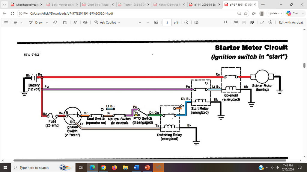

This drawing shows all of the components of the Starting system. Take a look at it and if you have further questions or need help deciphering the drawing we can help you. Need to know if the blue wire is light blue or dark blue. Be sure the PTO is off and all connections are clean and tight.
PS;  safety switches or relays are seldom the problem but that seems to be where everybody starts.

I'm dumber than a bag of rocks when it comes to electrical/electronics. I don't really understand the schematic, all I can understand is that the wire to the starter solenoid is the one that has no power. How to test it, I have no clue. Where to start to test it, I have no clue. How to use a multimeter, I have no clue, but I do actually have a couple of them.
gwest_ca
Figure out how you can measure 12 volts DC (Direct Current). Your meter may show 100VDC which just means it will measure up to 100 volts. Ground the negative wire to a good chassis ground or battery negative. Now with the red test lead follow the power from the battery to the solenoid checking for battery voltage into each switch and out of each switch. There are notes in the schematic showing the state of the switches - operator in seat, pto off as examples. You are testing the start circuit so you may need a helping hand to hold the ignition switch in the start position.
Notice the start relay gets it's power directly from battery + on a purple wire. The rest of the circuit controls what the start relay does. Wired like this so the start relay gets maximum power via a short cut without going through all the safety switches.
