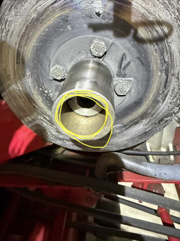

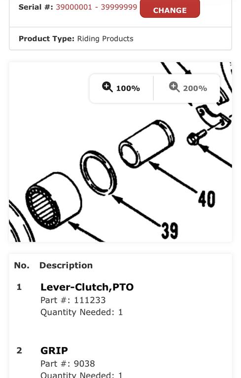

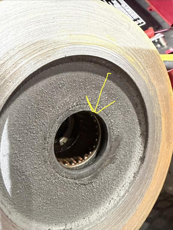

eric8 8 #1 Posted June 23 Decided to take a look at the PTO pulley today and discovered there was no friction material visible when viewing the air gap between the pulley and clutch disc. Pulled it off, and sure enough, I was right. She’s toast. Couple of questions: 1. Part # 40 in the diagram, identified as the bearing race, will not slide off of the engine shaft. It appears fused on and won’t budge. Is this normal? 2. Part # 39 is supposed to be a bearing seal. Is it installed currently? I’m not seeing any kind of lip that a traditional bearing seal would have. Share this post Link to post Share on other sites
pfrederi 21,150 #2 Posted June 23 You have to remove the 4 bolts and 2 small plates then number 40 will come off To me looks like seal 39 is there the rubber part may be worn away 3 1 Share this post Link to post Share on other sites
kpinnc 18,960 #3 Posted June 23 3 hours ago, eric8 said: She’s toast. Nah, but she's definitely been used beyond the wear limit of clutch material. I would say a new clutch plate is a good idea (not that it can't be fixed), and that PTO bell needs about 5 minutes in a lathe as a minimum. But just FYI- that style PTO was used on the majority of machines from the early 1980s onward. Finding a decent replacement won't be hard. 2 Share this post Link to post Share on other sites

eric8 8 #6 Posted June 23 7 hours ago, kpinnc said: Nah, but she's definitely been used beyond the wear limit of clutch material. I would say a new clutch plate is a good idea (not that it can't be fixed), and that PTO bell needs about 5 minutes in a lathe as a minimum. But just FYI- that style PTO was used on the majority of machines from the early 1980s onward. Finding a decent replacement won't be hard. I just ordered an NOS pulley/bell because of how badly grooved that one was. Are you aware of if the two bearings come out easily after the C-clips are removed? Any special tools or bearing pullers needed? I'm going to need to transfer all the guts over to the new bell. Share this post Link to post Share on other sites
kpinnc 18,960 #7 Posted June 23 18 minutes ago, eric8 said: Are you aware of if the two bearings come out easily after the C-clips are removed? Any special tools or bearing pullers needed? Not sure I'd call it easy, but it also isn't terrible. Remove the smaller one first. Actually the smaller one is a good one to replace while you are taking the whole thing apart. The large bearing (if you remove it without damage) can be repacked and reused. Since the smaller bearing is sealed, it's good to replace it. Special tools- snap ring pliers (required) and a bearing press (good idea but not absolutely necessary). Removing the large bearing without damage will be tough without a press but it can be done. Share this post Link to post Share on other sites
peter lena 10,065 #8 Posted June 23 @eric8 question , how easily does the mule drive belt move the deck BY HAND ? all my units easily do that , another thing , that needle bearing is known for hi temp stress , lubrication failure . every related , bearing I have , is lucas , xtra HD green chassis grease , 550 deg flash point , also polyurea rated , anti sling , all my spindle bearings , were cleaned out and regreased , mule drive , very light ammount on / in that pto needle bearing . also detailed in my pto lever start set up . BTW have never burned up a disc . bet that entire set up is COLLECTIVE ROTATIONAL DRAG , thats what is eating up your stuff . pete Share this post Link to post Share on other sites
eric8 8 #9 Posted June 23 Thank you kpinnc and Peter for the tips. I will take a look at all pulleys, the hydro/deck belts, and the mule drive while I have it all apart. 1 Share this post Link to post Share on other sites
eric8 8 #10 Posted June 23 (edited) 7 hours ago, kpinnc said: Not sure I'd call it easy, but it also isn't terrible. Remove the smaller one first. Actually the smaller one is a good one to replace while you are taking the whole thing apart. The large bearing (if you remove it without damage) can be repacked and reused. Since the smaller bearing is sealed, it's good to replace it. Special tools- snap ring pliers (required) and a bearing press (good idea but not absolutely necessary). Removing the large bearing without damage will be tough without a press but it can be done. For the benefit of all, I'll add this excellent tutorial I just ran across of how to pull in the new needle bearing with some nuts, washers, and all thread. Also, the Torrington/Timken number for the needle bearing is J-2420. SKF 14810 is the seal number Much cheaper options than the OE Toro stuff. PTO Needle Bearing Replacement - Engines - RedSquare Wheel Horse Forum Edited June 23 by eric8 Share this post Link to post Share on other sites
