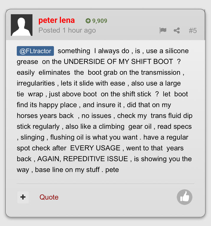

peter lena 10,046 #5 Posted June 22 @FLtractor something I always do , is , use a silicone grease on the UNDERSIDE OF MY SHIFT BOOT ? easily eliminates the boot grab on the transmission , irregularities , lets it slide with ease , also use a large tie wrap , just above boot on the shift stick ? let boot find its happy place , and insure it , did that on my horses years back , no issues , check my trans fluid dip stick regularly , also like a climbing gear oil , read specs , slinging , flushing oil is what you want . have a regular spot check after EVERY USAGE , went to that years back , AGAIN, REPEDITIVE ISSUE , is showing you the way , base line on my stuff . pete 1 Share this post Link to post Share on other sites
FLtractor 215 #6 Posted June 22 1 minute ago, peter lena said: @FLtractor something I always do , is , use a silicone grease on the UNDERSIDE OF MY SHIFT BOOT ? easily eliminates the boot grab on the transmission , irregularities , lets it slide with ease , also use a large tie wrap , just above boot on the shift stick ? let boot find its happy place , and insure it , did that on my horses years back , no issues , check my trans fluid dip stick regularly , also like a climbing gear oil , read specs , slinging , flushing oil is what you want . have a regular spot check after EVERY USAGE , went to that years back , AGAIN, REPEDITIVE ISSUE , is showing you the way , base line on my stuff . pete So you loosely zip tie the shift boot so it’s holds in a place it finds to be best for itself? spot check you mean you look for leaking transmission fluid under tractor on ground after every use? Share this post Link to post Share on other sites

ebinmaine 80,572 #12 Posted June 22 47 minutes ago, FLtractor said: That’s great to know.. I will have to get some kind of grease to put under the shift boot that I bought new last year. Why the grease? 46 minutes ago, FLtractor said: Oh wow. 5 years between transmission fluid changes even if using it daily? One of the manuals I've seen shows a 5-year period between changes on a unidrive. It's important to remember that as long as water is kept out of the transmission, it just does not see the same sort of wear and tear on the fluid that an engine does. Engines have combustion gases and much much higher temperatures. 2 Share this post Link to post Share on other sites

ebinmaine 80,572 #21 Posted June 22 13 minutes ago, FLtractor said: Peter’s quote above for grease. Silicone grease is really just to help you slide it down into place. And as stated above, no tie wrap is needed. If the boot is the correct one, it will seal itself and stay in place on its own. Share this post Link to post Share on other sites

FLtractor 215 #23 Posted June 22 (edited) 35 minutes ago, ebinmaine said: Silicone grease is really just to help you slide it down into place. And as stated above, no tie wrap is needed. If the boot is the correct one, it will seal itself and stay in place on its own. Ohhhh now it makes sense after re reading what he wrote and what you said. Just the tie and grease to help slide the boot into place.. not to help seal water out! Thanks Edited June 22 by FLtractor 1 Share this post Link to post Share on other sites
