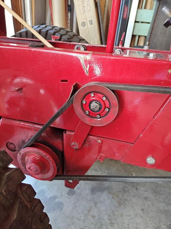

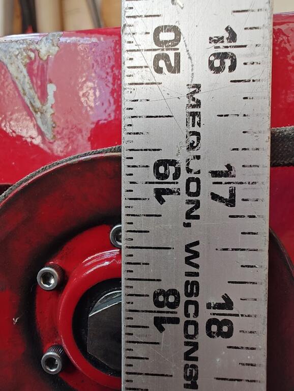

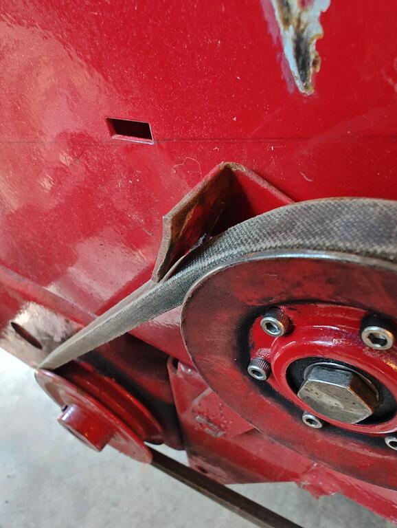

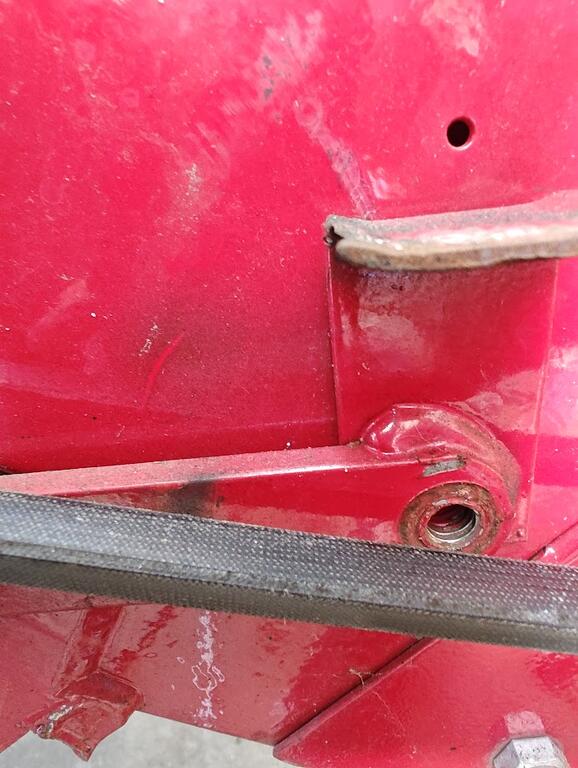

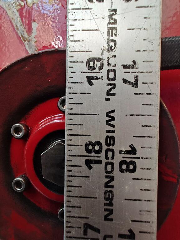

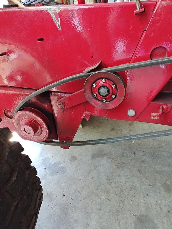

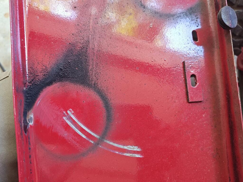

rmaynard 17,572 #1 Posted June 16 I am getting the Commando ready for the show and remembered that the last time I had it out, there was slapping noise in the drive belt/cover area. Everything works correctly, clutching is fine. So removal of the belt cover revealed this. The powder is from the belt. The small wear mark is from the guide hitting the top of the belt guard. The two parallel arced scratches are from the wrong bold being used when I assembled the idler originally. It has since been replaced with the correct bolt. This is the idler pulley arm and guide. Belt shows wear on top. When assembled, the belt is constantly rubbing on the guide. When disengaged, no contact. With the old belt on, the height of the belt/pulley is 19-5/16" from the floor. With the new belt, the height of the belt is 19-5/16", showing that 1/6" of the top of the belt has worn off. My first thought is that the guide on the idler pulley should be trimmed, smoothed, and reshapened. Then I should use a new belt that is fractionally shorter to keep the idler guide from hitting against the underside of the belt cover. Thoughts? Share this post Link to post Share on other sites

rmaynard 17,572 #8 Posted June 17 @ri702bill I took a close look at that area. At the most there maybe 1/32" of up/down movement. I compared it to the 857 and it was the same. That guide is only there to keep the belt from jumping off the idler when the clutch is depressed and the belt slacks. I think I will try a little modification to what's there before doing anything major. But thanks for the idea Bill 1 Share this post Link to post Share on other sites

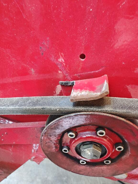

rmaynard 17,572 #11 Posted June 17 Problem solved. I replaced the belt with a NOS 9691 (1/2 X 70). I trimmed the guide and reshaped it so there is about a 1/16" gap when the belt is engaged. When the belt is disengaged, the guide is still low enough to keep the belt from coming out of the idler. And back to the original issue, there is no belt slapping or any other noise emanating from the belt cover area. 2 2 Share this post Link to post Share on other sites
squonk 48,051 #12 Posted June 17 I've just bent those guides before. You may need just a tick more clearance once the belt wears in. Share this post Link to post Share on other sites

rmaynard 17,572 #14 Posted June 18 3 hours ago, squonk said: I've just bent those guides before. You may need just a tick more clearance once the belt wears in. Thanks Mike, I did a little shaping after this picture was taken. 1 Share this post Link to post Share on other sites
