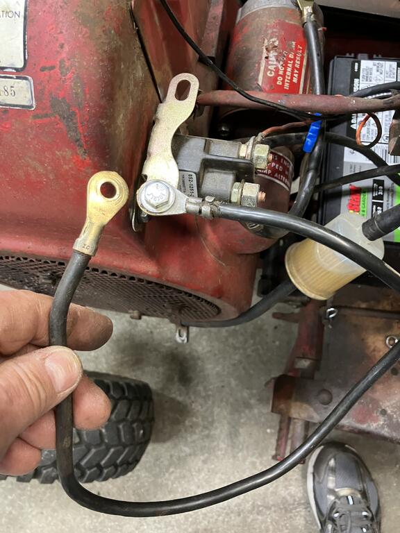

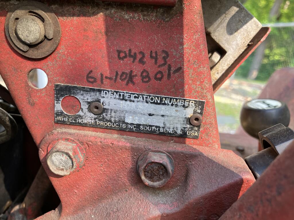

Retired Wrencher 6,921 #1 Posted May 31 I have a B100. The identification tag is a little beat up so I used a fine tipped magic marker and wrote down what I could using a magnifying glass. But the other matter is this doesn’t have an original solenoid. It’s definitely an aftermarket. Looking for the original part number I looked for a good hour yesterday. I couldn’t seem to find it in the manual section. Is it grouped with other tractors and years? Any info would help. This what I have on it now. Share this post Link to post Share on other sites
ebinmaine 80,283 #2 Posted May 31 I thought that tractor runs good? If that solenoid works I'd leave it on. But that main ground cable should NOT be attached to the bracket. Ground cables should be bolted to a more substantial point. Sheet metal isn't a great path for electricity. 1 Share this post Link to post Share on other sites
gwest_ca-(File Mod) 12,452 #3 Posted May 31 Solenoid part number is 8658. We do not have an original illustrated parts list and the one at Toro is list only - no illustrations. The Toro Master Parts Viewer allows one to word search and "solenoid" produced the 8658 part number. Click on the solenoid in the link. Recorded you vin - Serial 4243 - Build date 1975 5330 November 26 Wednesday [6330 is wrong] Click on the fuzzy area in the link below. Share this post Link to post Share on other sites

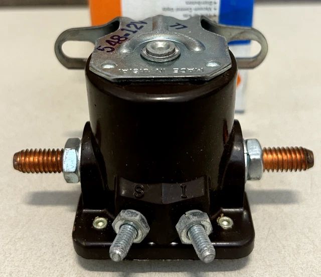

squonk 47,887 #4 Posted May 31 Napa ST81SB Use the "s terminal. Dis-regard the 2nd terminal. 1 Share this post Link to post Share on other sites
Retired Wrencher 6,921 #5 Posted May 31 (edited) 34 minutes ago, ebinmaine said: I thought that tractor runs good? If that solenoid works I'd leave it on. But that main ground cable should NOT be attached to the bracket. Ground cables should be bolted to a more substantial point. Sheet metal isn't a great path for electricity. Well yesterday I had a slight accident with that extra top wire that I don’t need slipped out of my hand and fell onto the positive side of the battery. Quite the spark show so I am thinking that something happened to that solenoid, cause it doesn’t turn over the engine anymore and yes, I did put my foot on the clutch to activate the safety switch kind of a head scratcher. So I only hear a nock sound coming from the solenoid. Does not turn over engine. Edited May 31 by Retired Wrencher 2 Share this post Link to post Share on other sites

Racinbob 13,111 #7 Posted May 31 20 minutes ago, Retired Wrencher said: Well yesterday I had a slight accident with that extra top wire that I don’t need slipped out of my hand and fell onto the positive side of the battery. Quite the spark show so I am thinking that something happened to that solenoid, cause it doesn’t turn over the engine anymore and yes, I did put my foot on the clutch to activate the safety switch kind of a head scratcher. So I only hear a nock sound coming from the solenoid. Does not turn over engine. Kinda sounds to me like the knock you hear is the solenoid working but there another issue with the starter, bad wiring or? 1 Share this post Link to post Share on other sites
ebinmaine 80,283 #8 Posted May 31 23 minutes ago, Retired Wrencher said: did put my foot on the clutch to activate the safety switch kind of a head scratcher If you contacted the battery and solenoid directly that safety switch is out of the circuit. Doesn't matter. 2 minutes ago, Racinbob said: Kinda sounds to me like the knock you hear is the solenoid working but there another issue with the starter, bad wiring or? Agreed. Could be a bad ground. ..or other bad components. Proper diagnosis here will be the key. 1 Share this post Link to post Share on other sites

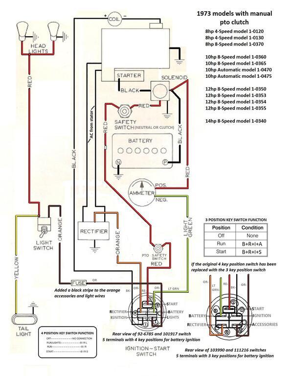

squonk 47,887 #9 Posted May 31 This should give you a good diagram to go by. 2 Share this post Link to post Share on other sites
Retired Wrencher 6,921 #10 Posted May 31 Thanks Mike. 1 Share this post Link to post Share on other sites

John2189 599 #13 Posted May 31 1 hour ago, Retired Wrencher said: I have a B100. The identification tag is a little beat up so I used a fine tipped magic marker and wrote down what I could using a magnifying glass. But the other matter is this doesn’t have an original solenoid. It’s definitely an aftermarket. Looking for the original part number I looked for a good hour yesterday. I couldn’t seem to find it in the manual section. Is it grouped with other tractors and years? Any info would help. This what I have on it now. About the ID tag, some times when they are hard to read, take a lead pencil and rub the numbers then lightly rub it off. The lead will fill the numbers and make it easier to see. 2 Share this post Link to post Share on other sites

Racinbob 13,111 #16 Posted May 31 12 Volt DC SPST Int Duty Grounded Solenoid Arrowhead SFD6004 [501072] - Surplus Center 2 Share this post Link to post Share on other sites
pfrederi 21,049 #17 Posted May 31 24 minutes ago, Racinbob said: 12 Volt DC SPST Int Duty Grounded Solenoid Arrowhead SFD6004 [501072] - Surplus Center I have used a couple of those! 1 Share this post Link to post Share on other sites

JoeM 10,156 #25 Posted May 31 I like these especially when the machine is not completely wired. The manual override switch is nice. A little pricey tho 5 Share this post Link to post Share on other sites
