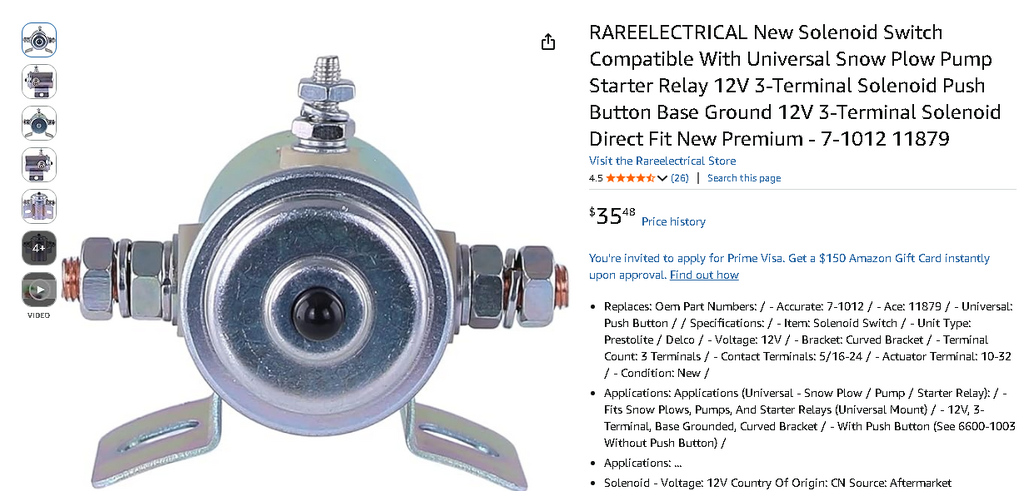

1 minute ago, JoeM said:
I like these especially when the machine is not completely wired. The manual override switch is nice. A little pricey tho
That is about what I paid a Nappa with all my discounts. I am trying to keep original lock. It needs a lot of work but I have the rest of the year and all winter to get it done.
That's neat! Never seen one.
A little pricey tho
Ain't bad. I've been buying NOS Cole Hersee solenoids for years.  Around the same...
squonk
You'd be surprised how many different solenoid variance there are. Not only appearance and terminals, but what the winding is made out of and what the contacts are. Most are copper or brass but you get into nickel and silver too. It all depends on what the job the solenoid has to to. Most "good" plow solenoids are "continuous duty " and are built to carry amperage for several seconds over and over. Starter solenoids aren't designed for that. They will operate a plow or actuator but will have a short life.
