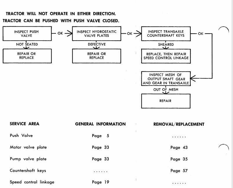

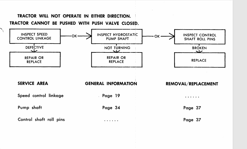

pfrederi 20,855 #11 Posted May 31 There are no idler pulleys First question Did the 3 pt hitch or mid mount operate while you had it running? If they did work next question Can you push the tractor with tow valve closed...Yes or no? After you answer these 2 questions we can proceed with diagnosis 1 Share this post Link to post Share on other sites

pfrederi 20,855 #14 Posted June 3 The loader and backhoe are run off a separate pump. Not relevant to you problem. Can you push the tractor if you close the tow valve. Share this post Link to post Share on other sites

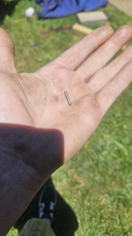

Redtickuleez 6 #15 Posted June 3 Yes. Ive removed the transmission and finally opened it. Where can i aquire those roller pins. ??? Share this post Link to post Share on other sites
pfrederi 20,855 #16 Posted June 3 (edited) Those are needles from failed needle bearings. You are going to have to completely dissemble the transaxle to find out which bearing failed. Looking at the size it is one of the closed end needle bearing in the case, Edit depending on the year of your D it may be the needle bearing on the end of the differential (at least one year used it instead of the 1533 ball bearing) Do you have the sunstrand manual?" Edited June 3 by pfrederi Share this post Link to post Share on other sites

pfrederi 20,855 #21 Posted June 11 Click on the fuzzy transmission picture above it will take to the manual to download. Sorry I do not do Facebook. Share this post Link to post Share on other sites
