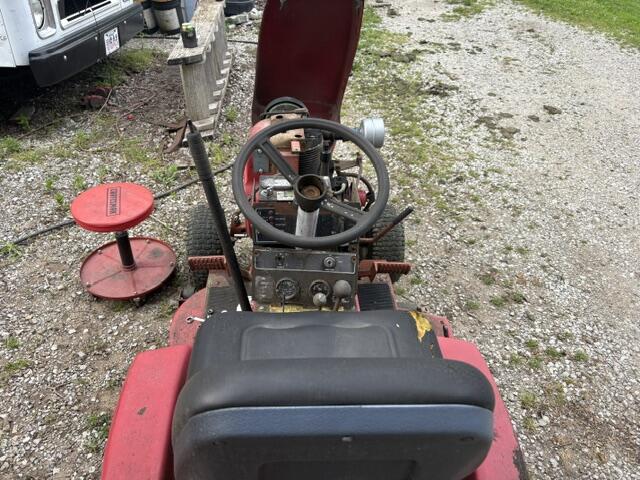

PbFlinger 107 #1 Posted May 24 This has bothered me since we’ve had this tractor. Steering wheel off center. Wife’s mower for in town yard, used about 1/2 hour a week. Working on it since muffler broke (see thread in engines if interested) and deck belt shredded. Had 3 big trees fall in recent storms, blew siding off of 2 houses, rodents chewed wiring off of dishwasher, and… this seemed paramount today. Oh well, I’ve never been great at life choices. 2 Share this post Link to post Share on other sites

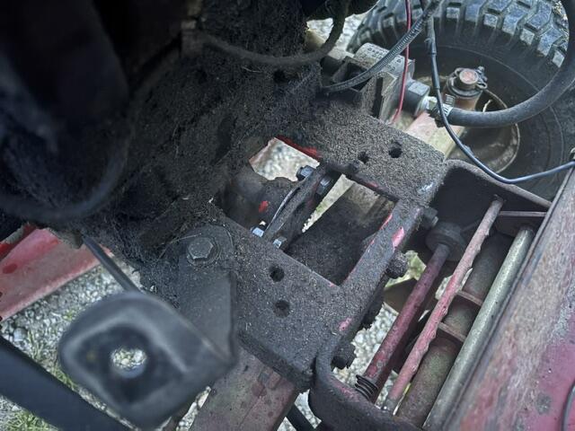

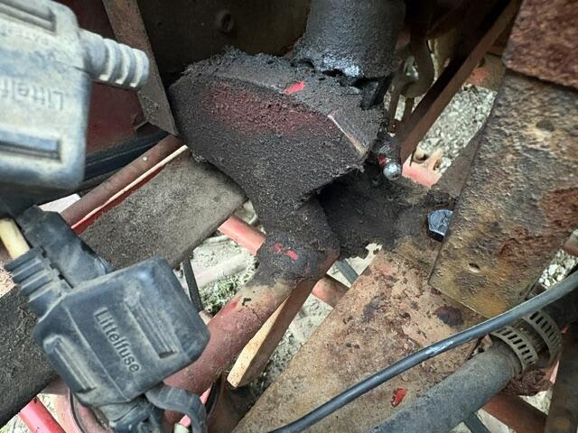

PbFlinger 107 #4 Posted May 24 (edited) By the way this is a 312-8. Upon investigating how the thing is put together, seems somebody in the past got the steering wheel shaft to sector off a toof or two. I was able to rectify this by dropping the steering shaft bearing mount forward of the engine, and removing the mounting bolts from the sector below the steering wheel shaft. This gave me enough slop to skip the teef back into proper alignment. Edited May 24 by PbFlinger 4 1 Share this post Link to post Share on other sites
kpinnc 18,963 #5 Posted May 24 2 minutes ago, PbFlinger said: off a toof or two. Sadly the steering on these machines is the most likely part to be ignored during any maintenance. What you are repairing is what most of us have had to do as well. 2 Share this post Link to post Share on other sites

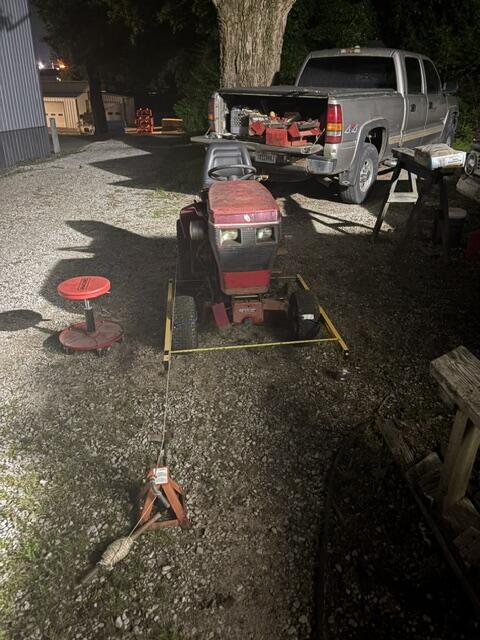

PbFlinger 107 #6 Posted May 24 With the wheel spur gear & steering sector now properly oriented & all reassembled, time for a little front end alignment. Set up a string to reference rear end centerline. Bungeed on a couple of straightedges. Used a couple tape measures to square front tires, then aligned with string off rear end. In absence of detailed alignment specs, with all 4 wheels pointed straight ahead, I gave it one turn on each tie rod end for some hoof in. This equated to about 1/2” difference at the ends of the straightedges. 3 Share this post Link to post Share on other sites
PbFlinger 107 #7 Posted May 24 Subsequent ops ck pretty successful. I didn’t see any porch lights come on, so the new muffler must be good. Hands off with wheel centered on the straightaway, no more wandering. Initial turn in by the mailbox showed a little push, slalom between swingset & fire pit showed a little oversteer. Dropped 1 psi on right front, 2 psi on both rear. Next lap much better, should be perfect with full tank & tires hot. 😁 Kidding, drives great now. Wife will probably never notice the difference. 🙄 Now I just have 3 big trees to cut up, a bunch of soffit & siding to fix, and a dishwasher pull & rewire. Back to reality 🐴 6 Share this post Link to post Share on other sites
