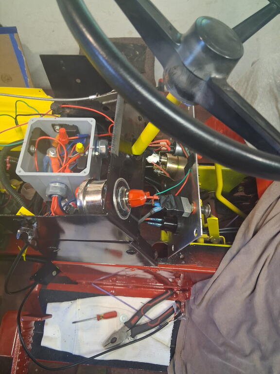

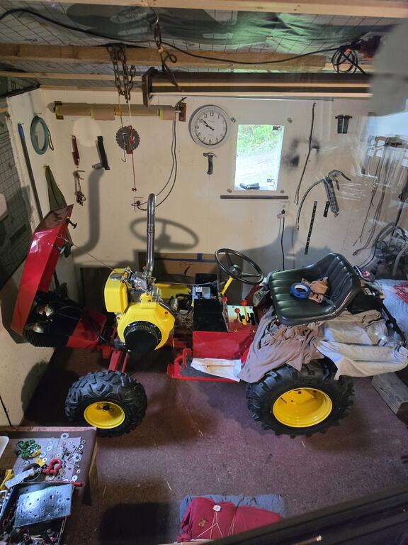

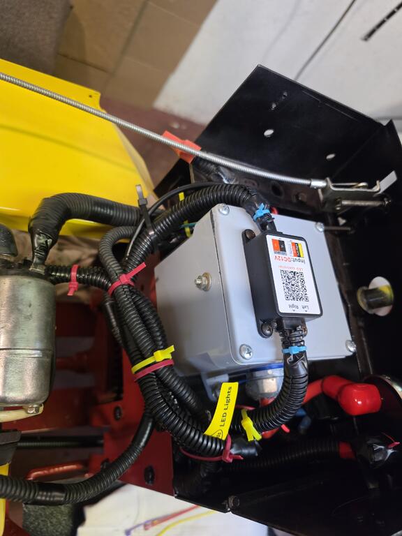

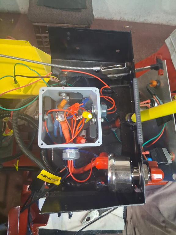

mudmowerdiesel 236 #1 Posted May 18 Almost done with the wiring 2 2 Share this post Link to post Share on other sites
ineedanother 2,864 #2 Posted May 18 love the project but wire nuts are a no-go in my shop. Enemies in the wire 8 Share this post Link to post Share on other sites
mudmowerdiesel 236 #3 Posted May 18 2 minutes ago, ineedanother said: love the project but wire nuts are a no-go in my shop. Enemies in the wire Lol 😆 🤣 😂 😹 😆 Share this post Link to post Share on other sites
953 nut 69,301 #4 Posted May 18 7 hours ago, ineedanother said: love the project but wire nuts are a no-go in my shop. Enemies in the wire Wire nuts are for interior wiring, they will come loose from vibration. 2 Share this post Link to post Share on other sites
mudmowerdiesel 236 #5 Posted May 18 32 minutes ago, 953 nut said: Wire nuts are for interior wiring, they will come loose from vibration. What to use instead of wire nut Share this post Link to post Share on other sites
WHX?? 58,125 #6 Posted May 18 9 hours ago, ineedanother said: love the project but wire nuts are a no-go in my shop. Enemies in the wire 1 hour ago, 953 nut said: Wire nuts are for interior wiring, they will come loose from vibration. True but 1 2 2 Share this post Link to post Share on other sites
WHX?? 58,125 #7 Posted May 18 (edited) 56 minutes ago, mudmowerdiesel said: What to use instead of wire nut @Achto prefers scotch locks but I prefer to solder western union splices and shrink wrap or properly crimped butt connectors. Edited May 18 by WHX?? 1 3 Share this post Link to post Share on other sites
702854boy 1,149 #8 Posted May 18 1 hour ago, mudmowerdiesel said: What to use instead of wire nut I've had good luck with just a plain old butt connector with the heat shrink casing on it 4 Share this post Link to post Share on other sites
oliver2-44 11,750 #9 Posted May 18 (edited) I've been using these heat shrink splices that have solder in them. They are the "Cats Meow"! But it does take a good hot heat gun to get it hot enough to melt the solder in them. https://www.amazon.com/gp/product/B073RMRCC3/ref=ewc_pr_img_1?smid=ANYCM9RSLDH7Y&th=1 Edited May 18 by oliver2-44 2 2 Share this post Link to post Share on other sites
SylvanLakeWH 32,504 #10 Posted May 18 I've used wire nuts in the past and shot silicone caulk into the connector... locks up the connection, waterproof, and was what I had on hand... never had an issue going on 5 years winter plowing... 2 Share this post Link to post Share on other sites
kpinnc 18,960 #11 Posted May 18 (edited) 4 hours ago, WHX?? said: prefers scotch locks OMG those are designed for solid conductor wire, not stranded. 3 hours ago, oliver2-44 said: I've been using these heat shrink splices that have solder in them. They are the "Cats Meow"! I've been using these as well. Pretty neat concept for a butt splice. But yes they have to get pretty hot to flow the solder. A good soldering iron and heat shrink are still best. I use crimp on contacts but I remove the plastic sleeve beforehand and solder them and use shrink wrap to seal out the elements. Never had a wiring failure. Edited May 18 by kpinnc 3 Share this post Link to post Share on other sites
Andy N. 2,812 #12 Posted May 18 3 hours ago, oliver2-44 said: I've been using these heat shrink splices that have solder in them. They are the "Cats Meow"! But it does take a good hot heat gun to get it hot enough to melt the solder in them. https://www.amazon.com/gp/product/B073RMRCC3/ref=ewc_pr_img_1?smid=ANYCM9RSLDH7Y&th=1 This little heat gun was worth the money when I was putting together the WH Snow Trooper project. I use the heat shrink splices and then cover them with black heat shrink. https://www.amazon.com/dp/B08BK3M6YW?ref=ppx_yo2ov_dt_b_fed_asin_title 5 hours ago, mudmowerdiesel said: What to use instead of wire nut I've also used Wago lever connectors in a pinch. I used marine style connectors for connections into the control boxes. This kept the controllers mostly water proof. 1 Share this post Link to post Share on other sites

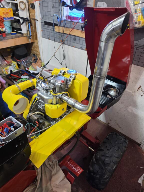

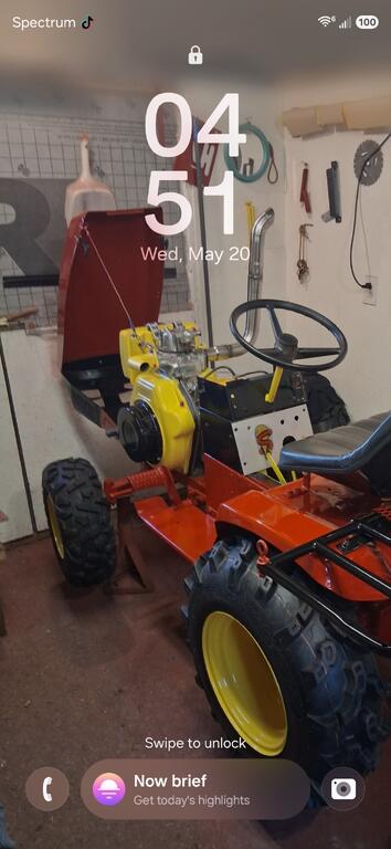

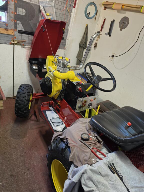

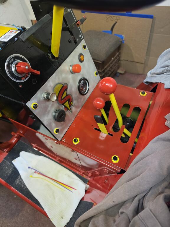

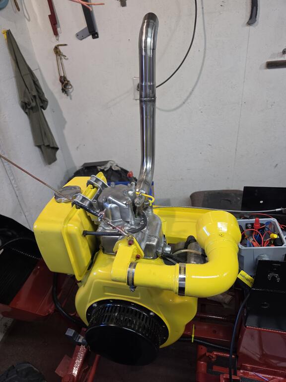

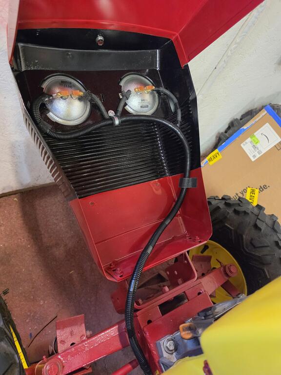

mudmowerdiesel 236 #20 Posted May 20 More pictures of the diesel it almost done 2 Share this post Link to post Share on other sites
702854boy 1,149 #21 Posted May 20 I do like how you didn't cut up the hood for the diesel engine 3 1 Share this post Link to post Share on other sites
