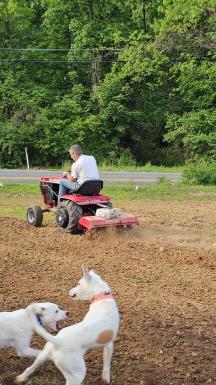

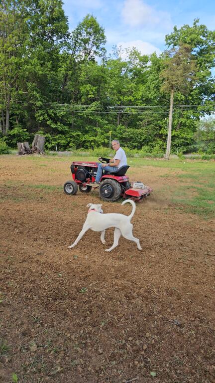

HyperPete 939 #28 Posted May 12 (edited) I finished reassembly and took it out for a test run. The first issue is that I am unable to lower it far enough. It grazes the surface. The adjustment knob is adjusted "down" enough that it is loose. I plan to adjust the spring to see if that has any effect. I also tried moving the clevis on the chain one link, but that loosens it so much that it prevents me from lifting it. Edit: it occurs to me that there are three "slots" on the other end of the chain, where it connects to the lift lever. It is in the lowest. I'll try the middle & the top to see if that makes a difference. (I saw no adjustment info in the tiller user guide.) The second issue is that it is not level. I took a look, and the only thing that I can see that might make a difference would be how the actual tiller unit attaches to the frame. Meaning, the bars that attach to the back and connect to the axle. There appear to be two bolts on each side holding them in place. I will try loosening them to see if there is any play in them that will allow me to adjust it. If not, I have no idea of how that would be adjusted. I'm looking for input. Thank you. Edited May 12 by HyperPete Share this post Link to post Share on other sites
ineedanother 2,513 #29 Posted May 13 Well @HyperPete, you're a bit like me. Nothing is plug and play but you've got the bones in the right places so you'll just have to tune it up. Make sure the axle bracket is in a good place. The casting on the uni-drive has some good and bad places to settle on. I think you're fine with where you're bolted in to the lift lever (lowest) but chain length and attachment to the tiller from the rock shaft is what you need to dial in. Check the axle bracket placement. Get rid of the spring assist until you have it all settled, it could be rocking the tiller off level. Make sure the tiller attachment isn't bent or twisted (I doubt it is, but eyeball it) Tune in the high and low on the lift (with the slots on the rock shaft) and then put the lift assist spring back on. It probably won't lift exactly level depending on wear because it doesn't lift from center. 1 1 Share this post Link to post Share on other sites

Moparfanforever 933 #31 Posted May 13 https://wheelhorsepartsandmore.com/wp-content/uploads/2020/07/Tiller_Instructions.pdf Maybe this will help if you haven't seen it already. I can't remember how many links are in my chain, but I almost always use the next to the last link,and the last link to go deeper. When I use the last link, I have to leave the tiller down and shorten the chain to lift it higher. 1 Share this post Link to post Share on other sites
HyperPete 939 #32 Posted May 17 (edited) On 5/13/2026 at 5:42 PM, Moparfanforever said: https://wheelhorsepartsandmore.com/wp-content/uploads/2020/07/Tiller_Instructions.pdf Maybe this will help if you haven't seen it already. I can't remember how many links are in my chain, but I almost always use the next to the last link,and the last link to go deeper. When I use the last link, I have to leave the tiller down and shorten the chain to lift it higher. Yep, I'm using the next to last link. ----- Tilling complete! It was the spring adjustment. Question: who here has put weight atop their tiller to better till hard packed soil? After 8 (!) passes with no weight, I still had barely broken the surface. The spring assist was not installed, and there was slack in the chain, and free-play at the adjustment knob. I temporarily strapped a 50# bag of sand to the top, and it made a big difference. Before I build a tiller-top weight box, are there concerns about parts breakage? Edited May 17 by HyperPete 2 Share this post Link to post Share on other sites
ineedanother 2,513 #33 Posted May 17 Hey Pete, glad that worked for you. I thought the spring was suspect and best to remove for testing since it's the one piece that is nice but unnecessary. w/regards to weight, I would choose to go with heavy watering of the ground first and maybe consider what the edges of the tines look like. You want them to cut the soil and they won't do that very well if they're too blunt. I think adding weight could just add stress the shafts and pins for the tines and those are valuable and can be difficult to find replacements. 3 Share this post Link to post Share on other sites
c-series don 12,045 #34 Posted May 18 One of the first things I think of is the condition of the tines. If they are worn and come to a point they are not going to work well, they will want to just bounce along and not bite in. Tines in good condition will be more squared off. Also as stated above, till moist soil, not dry hardened soil. I’d be careful about tilling with weight on the tiller. Maybe for a short time but definitely would not add a weight box on top. If the ground you’re tilling will be tilled again next year or again in the fall, it should be much easier next time. 2 Share this post Link to post Share on other sites

HyperPete 939 #36 Posted May 20 (edited) On 5/17/2026 at 8:39 PM, c-series don said: One of the first things I think of is the condition of the tines. If they are worn and come to a point they are not going to work well, they will want to just bounce along and not bite in. Tines in good condition will be more squared off. Also as stated above, till moist soil, not dry hardened soil. I’d be careful about tilling with weight on the tiller. Maybe for a short time but definitely would not add a weight box on top. If the ground you’re tilling will be tilled again next year or again in the fall, it should be much easier next time. The times are not rounded off, and although they might benefit from a little sharpening, they ought to be adequate for a tiller. The soil is in a field (front yard) that likely NEVER been aerated. (I've only lived here 3 years, and my little spike aerator just rides on the surface.) While it had rained 2 & 3 days earlier, it was still pretty dry. I just gave up on the hard sections at the edges of my garden. In the video you can see the tiller just hopping across the surface. In the middle it digs in a bit. I made 6 passes, two passes in three different directions. By next year my body ought to have healed enough to try my walk behind on the hard sections to see it does any better. If it does, I'll try sharpening the blades a bit. 45 degrees? Surely not shallower... lv_0_20260520181004.mp4 lv_0_20260520181004.mp4 Edited May 20 by HyperPete Compressed & uploaded video 2 Share this post Link to post Share on other sites
Moparfanforever 933 #37 Posted May 20 When you get to the really hard ground, you can push your clutch in and let the tractor/tiller set there and just dig in. Unless you think the ground is to hard and it will damage something. Not ideal i know, but I have done it before. Not sure if your walk behind will do any better, unless you start high and lower your tines a little on each pass. Do you have a friend with a compact tractor and tiller?? May have to use something like that to break your ground up for the first time. 1 Share this post Link to post Share on other sites
HyperPete 939 #38 Posted May 20 (edited) 29 minutes ago, Moparfanforever said: When you get to the really hard ground, you can push your clutch in and let the tractor/tiller set there and just dig in. Unless you think the ground is to hard and it will damage something. Not ideal i know, but I have done it before. Not sure if your walk behind will do any better, unless you start high and lower your tines a little on each pass. Do you have a friend with a compact tractor and tiller?? May have to use something like that to break your ground up for the first time. I have a tractor, and I borrowed my son-in-law's disk harrow, but it was unable to break it up either. These are very short runs as you can see, and each time I get to the edge I had to lift the three-point hitch and stop turning the soil over. Edited May 20 by HyperPete 1 Share this post Link to post Share on other sites

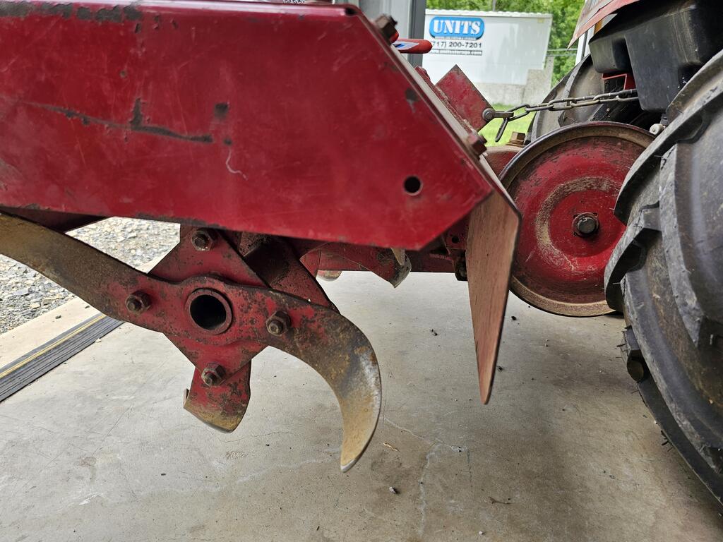

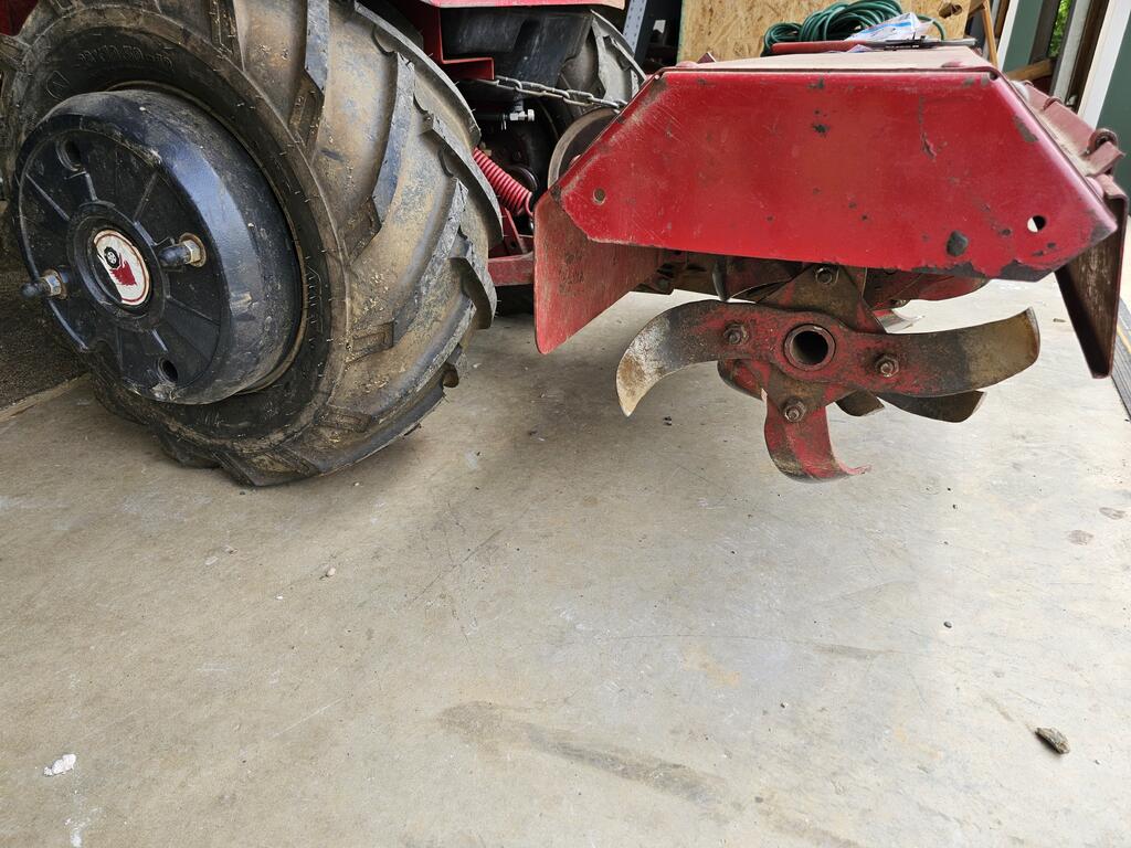

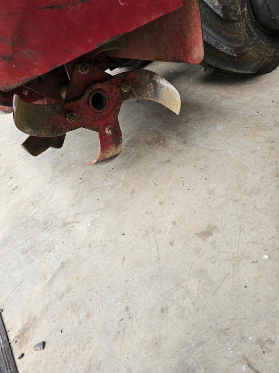

c-series don 12,045 #39 Posted May 21 @HyperPete this might sound crazy but it looks like the tines are on backwards? Maybe it’s just the video making it appear that way? Did you or someone replace the seal’s and perhaps put the tines on backwards? Can you post a video of the tiller turning lifted at an idle? Now that you have the first inch or two tilled up I’d do it again after a good rain. That loosened soil will help hold the moisture so the rain doesn’t just run off. 1 Share this post Link to post Share on other sites
pfrederi 20,823 #40 Posted May 21 (edited) Welcome to PA and clay...at least you do not have lots of rocks. Used my WH tiller and a Troybilt horse to make a much smaller patch. Used two bottom plow and a 40 HP Case DC3 the clay was about all she wanted the ntried to use two gang disc with weights on another patch. The disk just bounced along. When the neighbor farmer discs with a 100+ hp tractor you can hear the screeching. .Sometimes a raised bed is good idea Actually looking at your video not too bad for dry rock hard clay.. bit of moisture and many more passes,,,, Edited May 21 by pfrederi 1 Share this post Link to post Share on other sites
pfrederi 20,823 #41 Posted May 21 Thought about this some more and looked at your video again. I think unreasonable expectations based on advertising may be part of the issue. Troy Bilt Horses are the gold standard for tillers. They have ad pictures of the guy walking along side it guiding it with one hand while it is tilling 4-6 inches deep. I have dealt with Troy Bilts for many years Father had a 2 hp one from the late 40s. now i have his 6 hp horse. Yes they will till like the ad IF you are working on a plot that has been worked for many years with organic material and no big rocks. (I always smile when i see the plow day pictures here. Where are the rocks.) I had a plow for a WH sold it not gong to work on my rock clay pile.You start out on sod or rocky clay spoil never worked before and you have to hold on for dear life even at minimal till depth. It will take multiple passes to get down to a reasonable depth. The tines on a WH tiller are very similar to the bolo tines on a Troybilt. For clay and rocks Troy bilt has pick tines that work better for initial tilling. (do not use them on sod). So WH tines are good for some conditions but you will have to work them longer on hard untilled ground. Subsequent seasons you will find the WH tiller will work well..(except for the fresh crop of rocks mother nature pushes up each year Share this post Link to post Share on other sites
HyperPete 939 #42 Posted May 22 Hi guys, thanks for the feedback. I'm on my way to beautiful Anguilla for a bit, so no rototillers for now! Yes, I removed the tines & replaced the seals, but I THOUGHT I had them layed out properly. Boy will my face be red if that is the case! My troy-bilt horse is a beast, and although it has the same limitations, I can apply generous down pressure via the handlebars. Yeah, Central PA clay is no fun. I got a tooth bar for my FEL to get through it. I think I finally got it tilled enough for my zinnia seeds this year. It will be watered generously over the summer, so tilling either this autumn or next spring will be easier. I am also considering adding pelleted gypsum to help lighten it. 2 Share this post Link to post Share on other sites

c-series don 12,045 #46 Posted June 7 @HyperPete Are the tines on correctly? Share this post Link to post Share on other sites
Bill D 2,976 #47 Posted June 7 (edited) 26 minutes ago, c-series don said: @HyperPete Are the tines on correctly? Watched your video and one on YouTube. Pretty sure your tines are backwards. If so, switch them from side to side. For the record I have never owned or used one of these. Edited June 7 by Bill D Share this post Link to post Share on other sites

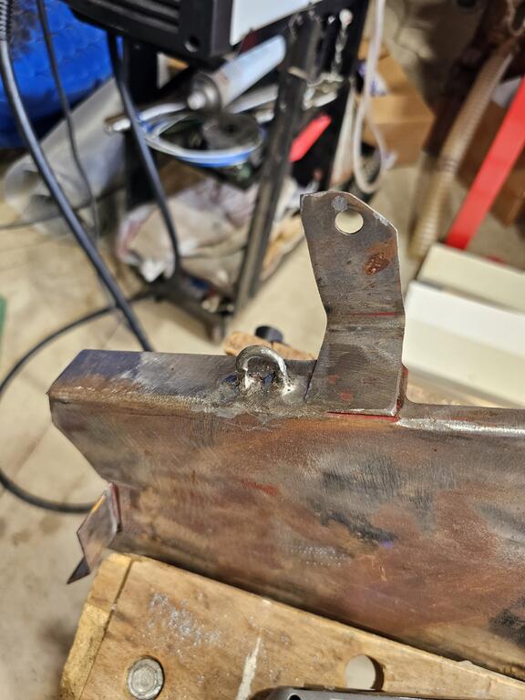

Bill D 2,976 #48 Posted June 7 On 5/6/2026 at 5:14 PM, HyperPete said: Yep, I am definitely a visual learner. I Frönkensteened it together with a bolt, a "bracket" I made, and a spare spring off a 200 series I'm stripping for parts. This is temporary, to route the cable and test it out. There is no attachment loop on the bottom of the side panel on my particular 414-8, so I am planning to remove the side panel and probably weld a hook in the correct location. I've got to take it all back apart to clean the bare metal of surface rust from sitting over the winter, and paint it anyway. I will likely continue the cleaning and painting, just to freshen it up a bit and get rid of all the peeling paint. Thank you all for your help, I appreciate it sincerely. 20260506_164332.mp4 42.03 MB · 0 downloads Tines are on backwards, I'm sure of it. Share this post Link to post Share on other sites
kpinnc 18,720 #49 Posted June 7 51 minutes ago, Bill D said: Tines are on backwards I kinda think you're correct sir. On 5/20/2026 at 5:44 PM, HyperPete said: The times are not rounded off I was watching your video trying to figure out why your tiller was bouncing even with a bag of concrete on it. It just never settles in like mine does. Thought maybe your lift cable was too short or something. Your tiller should drop down to the belly of the gear case (or a little lower) when the lift arm is lowered. I've used my tiller on bright red clay that was hard as a brick, with no concrete bag and it never jumped like that. It will rock the tractor in a hard spot but the tines actually pull down and dig. If anything it will push the tractor even in low range sometimes. Share this post Link to post Share on other sites
HyperPete 939 #50 Posted June 8 Looks like I put the right side on backwards... Can someone please confirm? RIGHT side LEFT side Share this post Link to post Share on other sites
