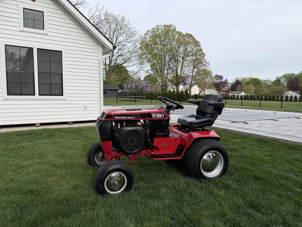

sqrlgtr 3,234 #4 Posted May 3 (edited) here is the 6.50 V61 vredstien I just installed on my 520H. It had 7.50 turf on front and these are almost same size maybe just a tad shorter and tad skinnier. I really like these tires, and this is my 2nd set, have these and a set on a C-160. Now just trying to decide if I want Ags on back.. To my eye the 8.50's look to big but thats just me. Edited May 3 by sqrlgtr Share this post Link to post Share on other sites
